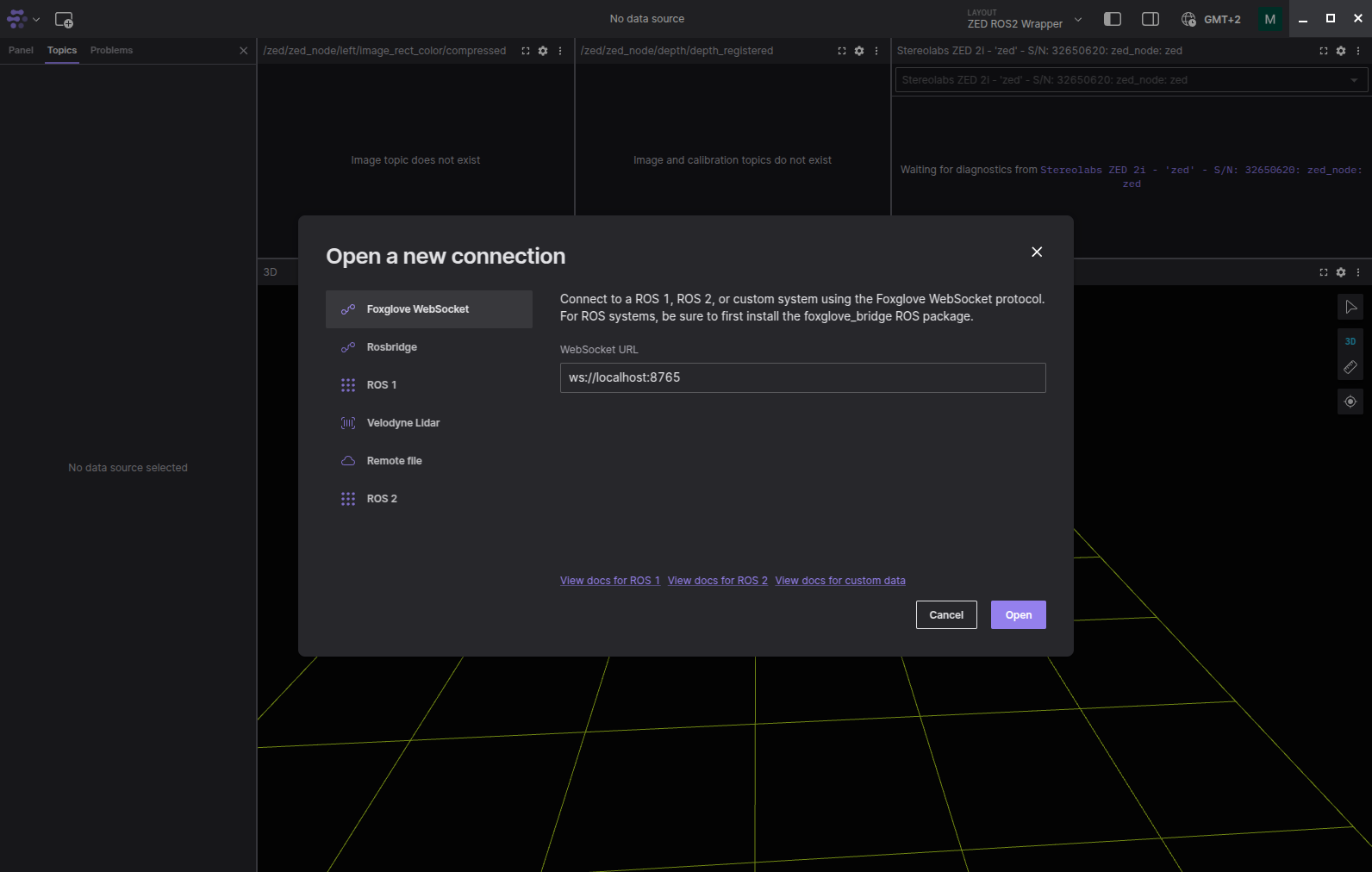

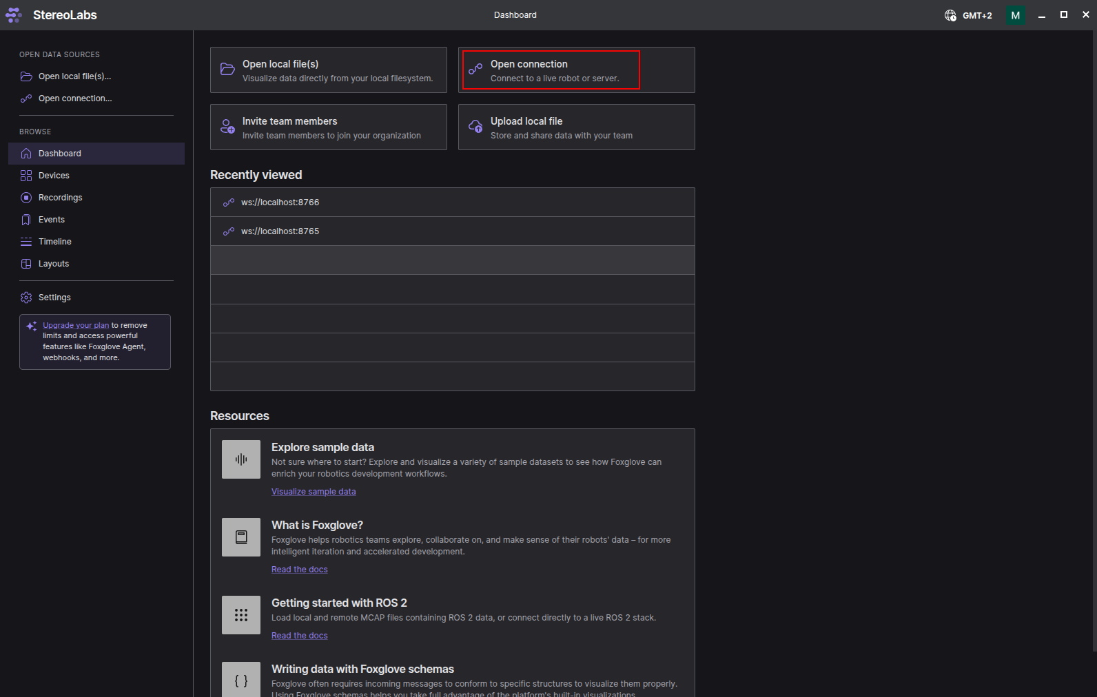

  1. In Foxglove, click “Open Connection”.
  2. Enter the URL: ws://localhost:8765 and click “Connect”

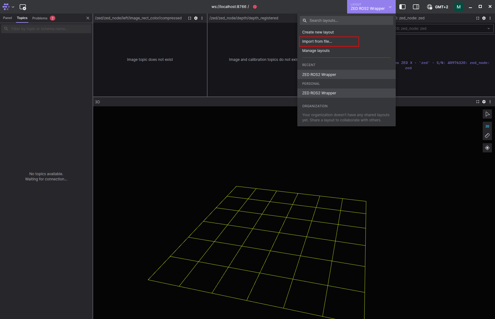

  3. If you have not already, download Stereolabs’ Foxglove layout, and import it by clicking on “Import from file…” in the top right corner

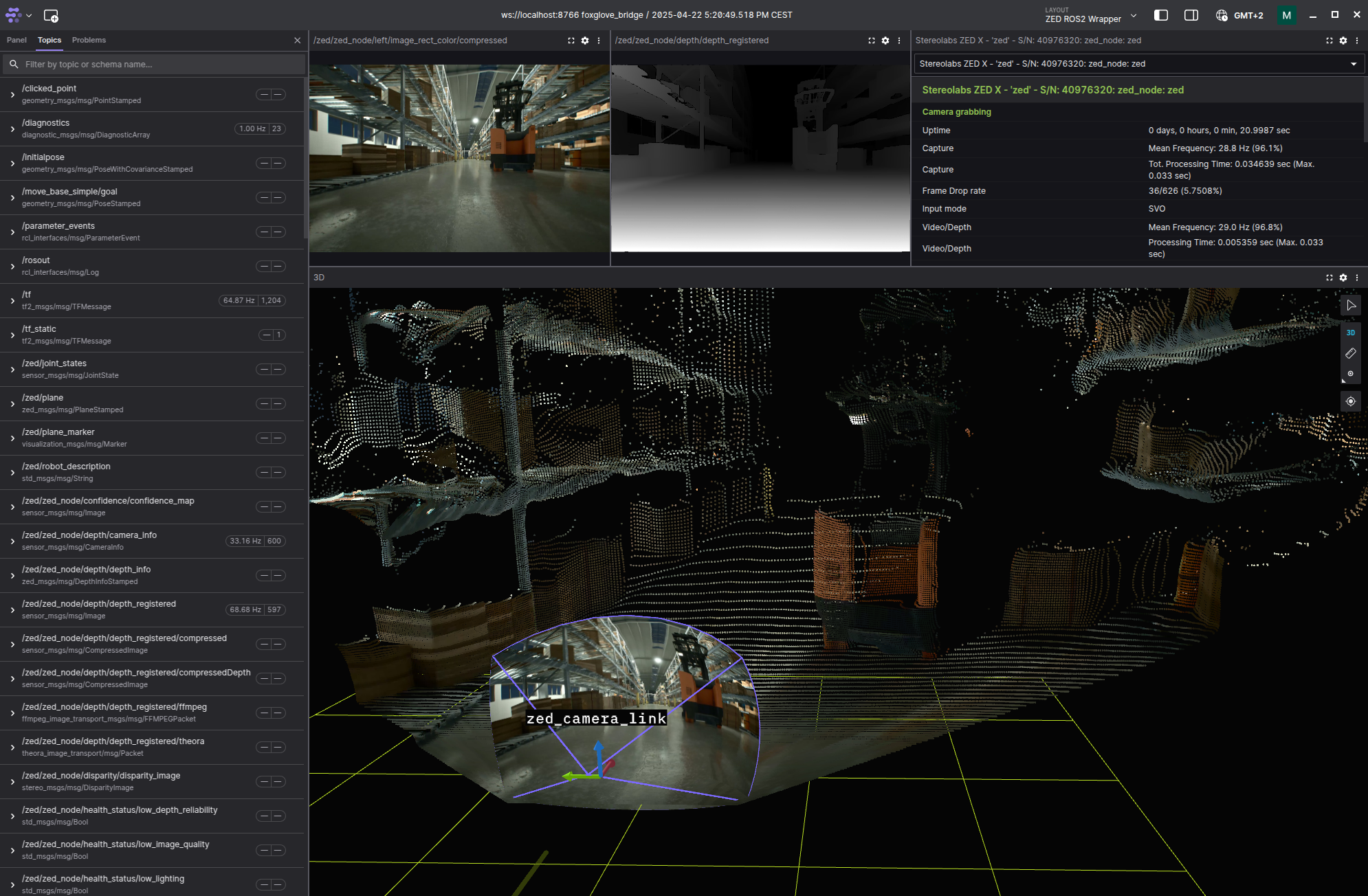

  4. You should now see your ZED topics available for visualization!
You can add panels like Image, 3D, or Raw Messages to inspect your sensor data in real time.
