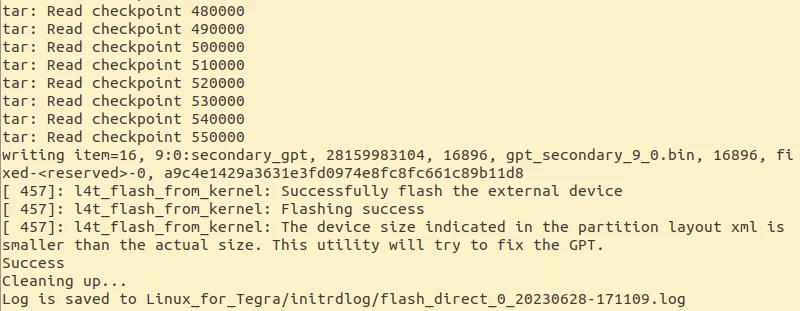

  4. Flash the ZED Box:
    • Ensure you have at least 80GB of free space on your working hard drive.
    • Use the following command to flash the ZED Box:
      BSP_ROOT=./stereolabs_bsp/ ./zedbox_<version>.sh`
      • Replace <version> with the installer, e.g., zedbox_all_usb_flash_6.2.sh.
      • All necessary files will be downloaded in the folder $BSP_ROOT. The script will create this folder if it does not exist and will ask you to log in as root.
  5. Wait for the operation to complete. You will see the following output if the flash is successful: image
If you encounter any problems during this procedure, please consult the troubleshooting guide.

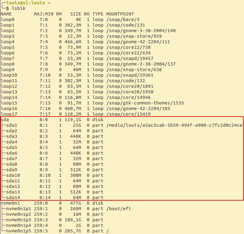

  • Install the necessary dependencies:
    sudo apt install qemu-user-static abootimg libxml2-utils sshpass nfs-kernel-server
  • Use lsblk to identify the USB disk you want to flash. In the caption below, we can identify that the USB disk ID is sda: image
    Please be careful and use the name of the drive and not the name of a partition. For instance, use sda instead of sda1.
