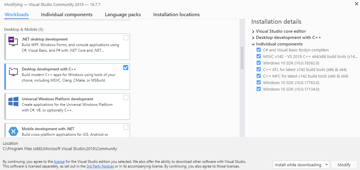

On Windows, building an application with the ZED SDK requires CMake (3.5.0+) or higher and Visual Studio 2015 or higher. Applications must be compiled for 64-bit.
📌 Note: When installing Visual Studio, make sure to select Visual C++ option.

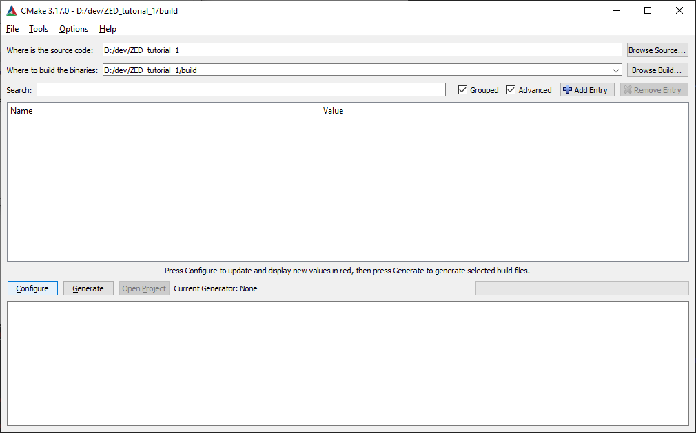

- Open cmake-gui.
- In “Where is the source code“, enter the path of the project folder where the CMakeLists.txt is located. Here we created a project folder “ZED_Tutorial_1” in Documents.
- In “Where to build the binaries“, enter the previous path and add: /build.

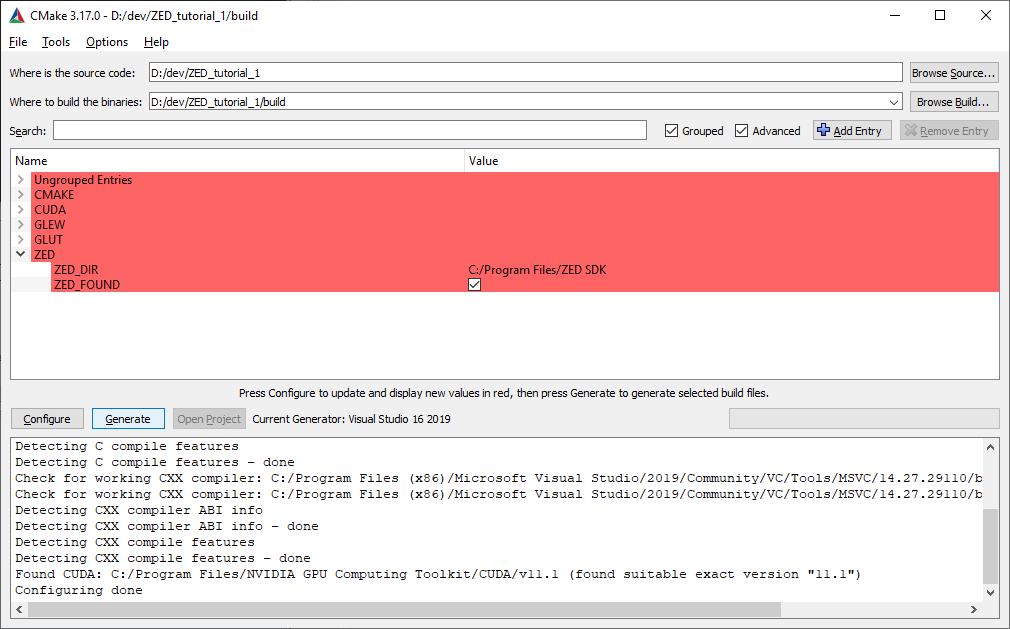

- Click on [Configure].
- A dialog window asks you if CMake can create the “build” folder. Say yes.

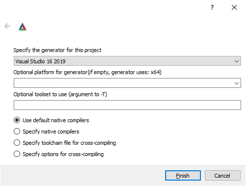

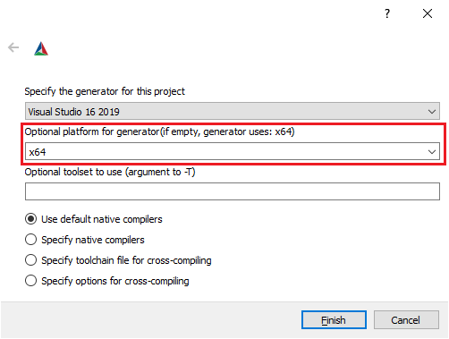

- Another dialog window will ask you to specify a generator for your project. Choose Visual Studio in Win64 and click on [Finish].
📌 Note: CMake needs to define the target platform as x64, on new version it is set by default, if not you can set it.
- CMake may take a few seconds to configure the project.
- Click on [Generate] to build the Visual Studio project files.

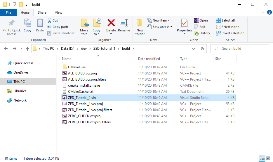

- CMake has now generated your project in the build directory. You can directly open the solution by clicking on [Open Project] or by closing the cmake-gui window and opening the build folder.

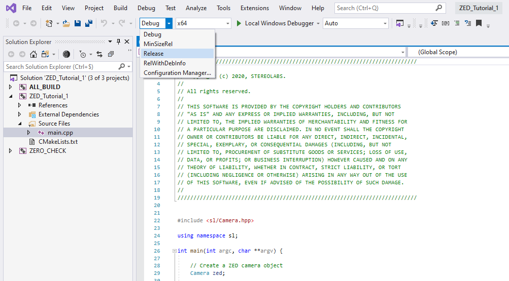

- A Visual Studio solution has been generated. Open Project.sln and set it in
Releasemode.

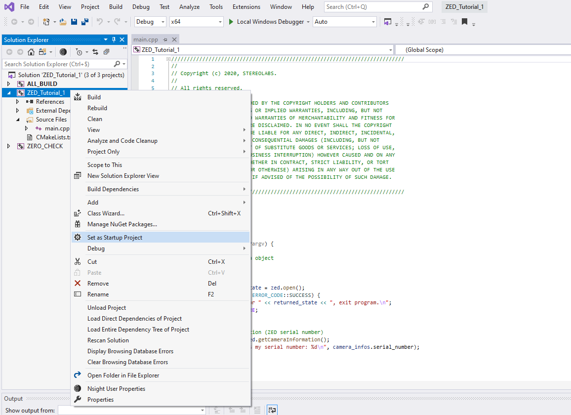

- To run the builds from the Build menu or from keyboard shortcuts, set the
ZED_Tutorial_1target as the startup project.

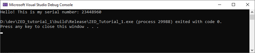

- You can now edit and compile your program in the Visual Studio IDE. Hit the
Ctrl+F5key to launch the program.
