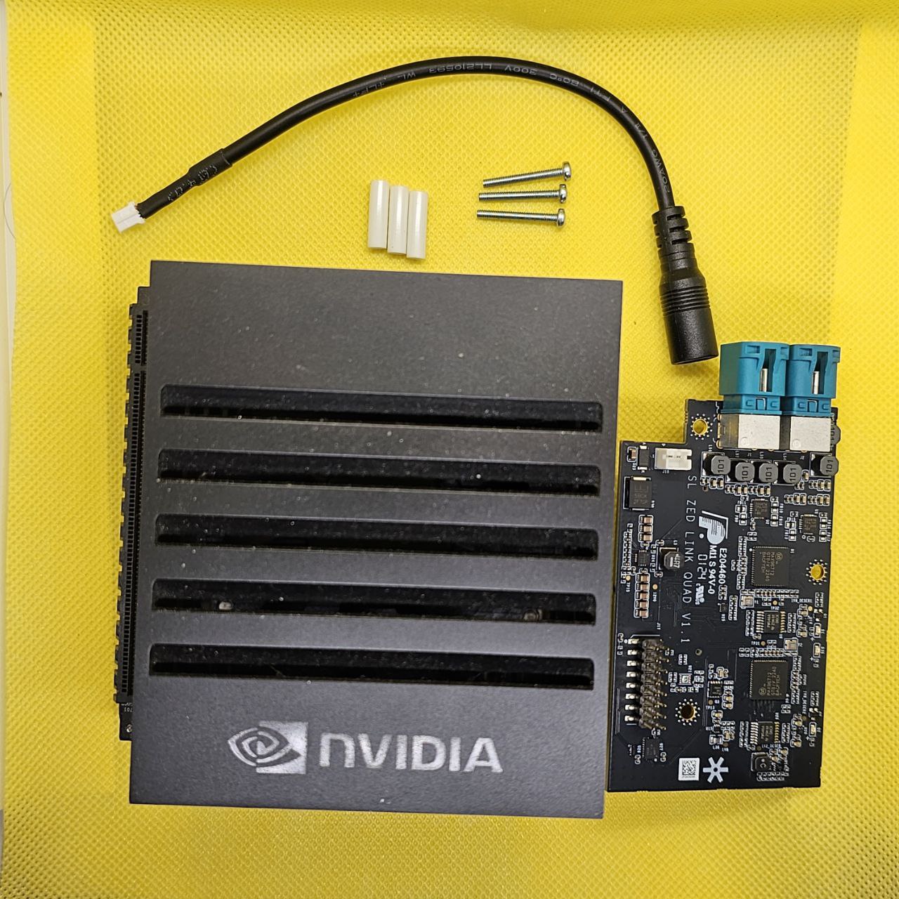

Prerequisites #
- 1x NVIDIA® Jetson™ Xavier AGX Developer Kit.
- 1x ZED Link Quad GMSL2 capture card
- 2x 1-to-4 GMSL2 Fakra Male to Female cable (included in the box)
- 1x NVIDIA® Power supplier to power the Development Kit (included with the devkit)

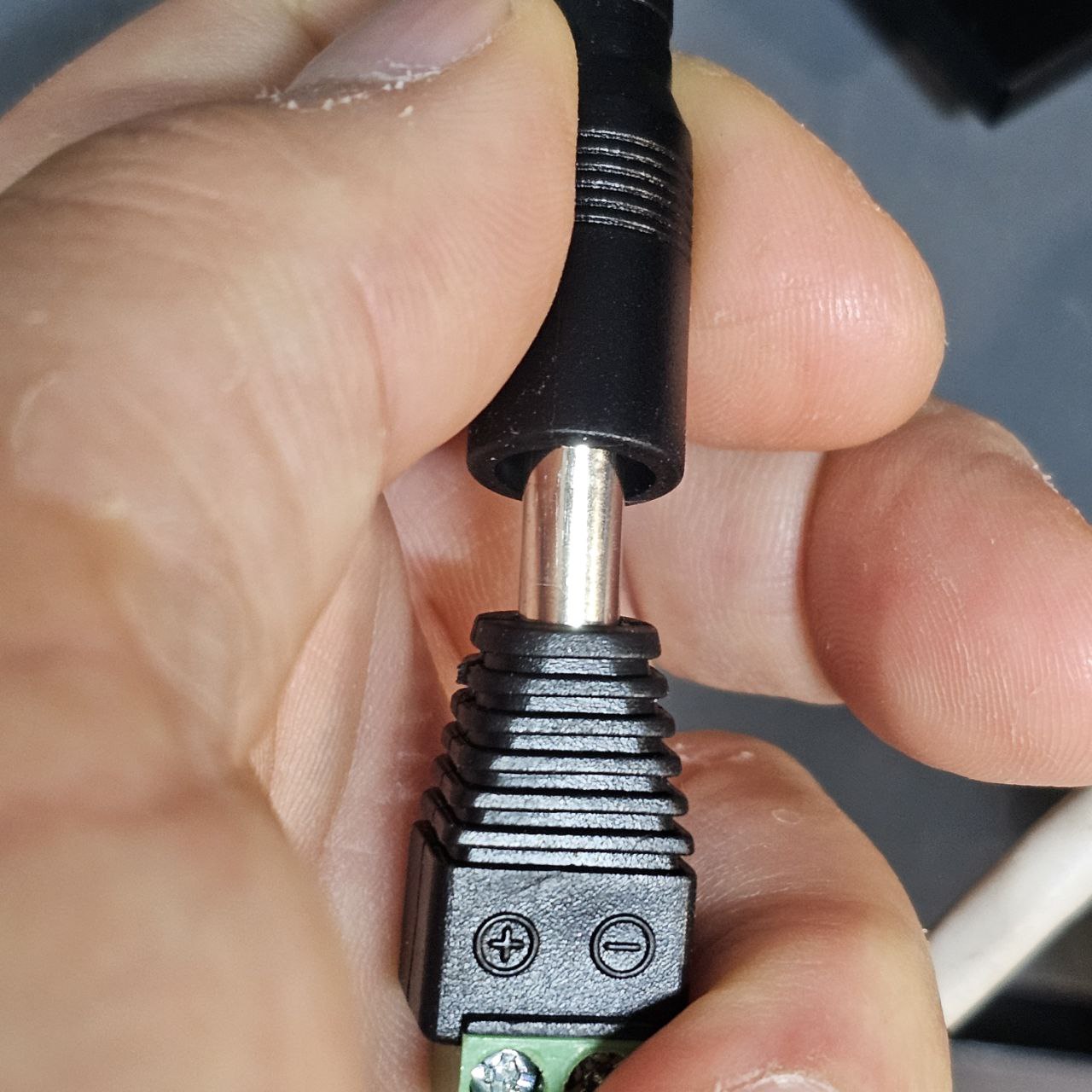

- 9V-19V (min 6W) power input (Barrel Jack 5.5 mm outer diameter, 2.5 mm inner diameter) to power the GMSL2 capture card (not included)

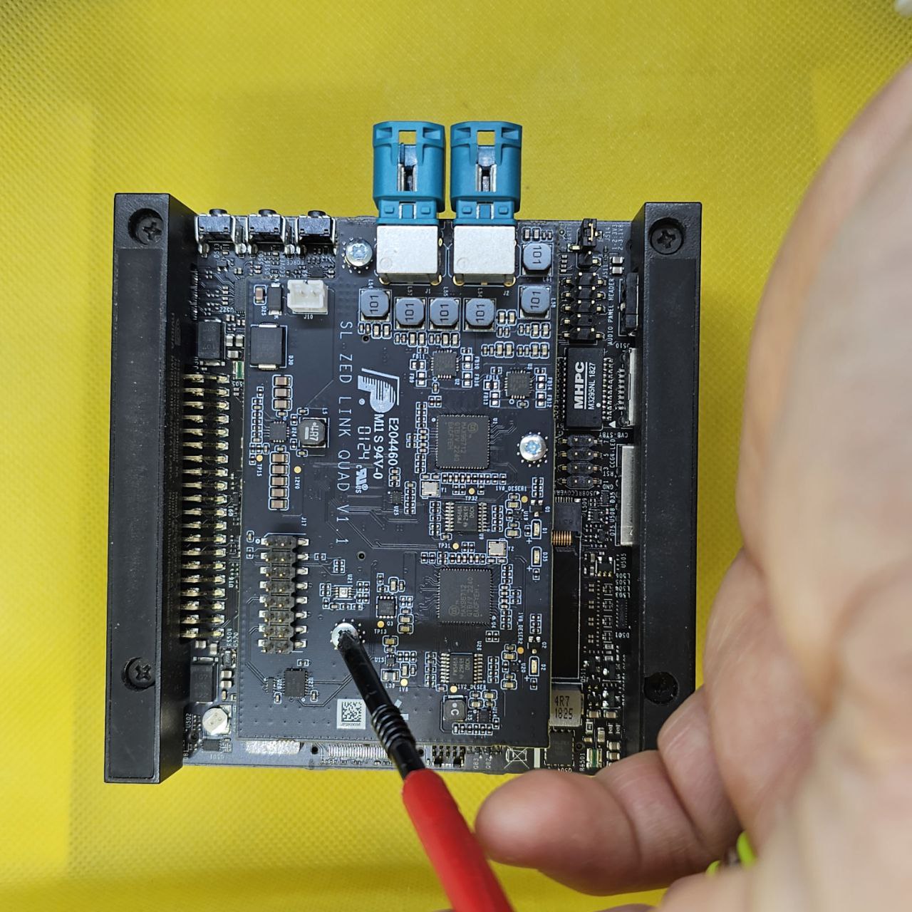

Install the GMSL2 Capture Card #

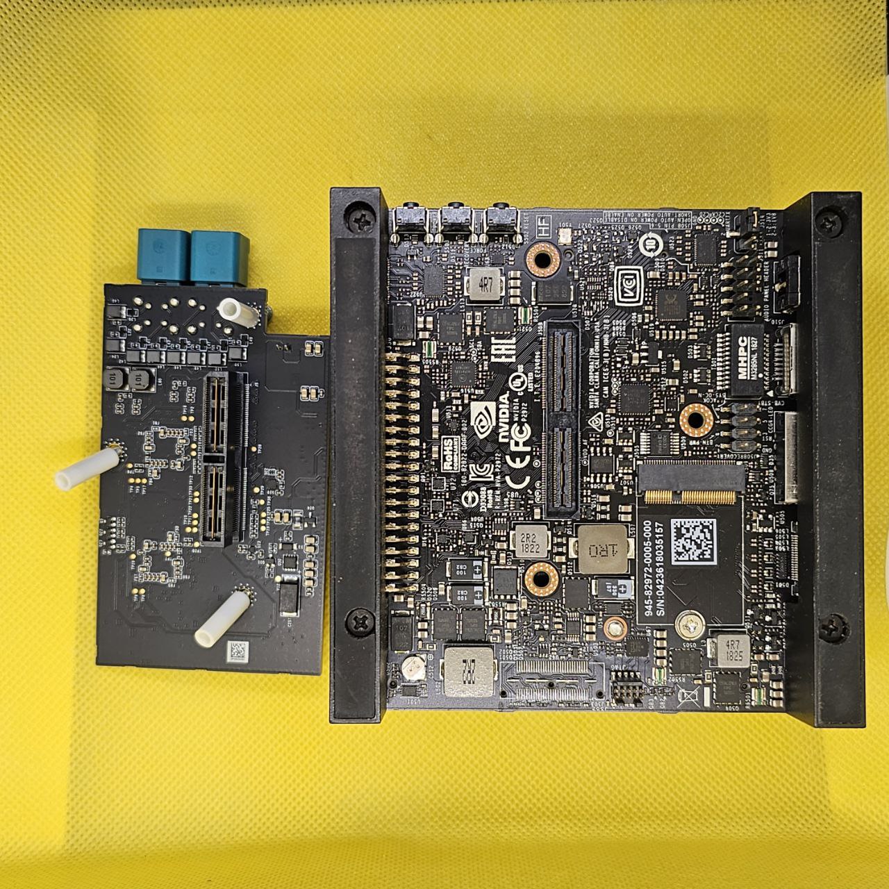

Plug in the capture card in the ‘Camera connector’ slot and fix it by using the three provided screws:
⚠️ Warning: It’s important to use the provided spacers and screws to ensure a secure fit and avoid damaging the ZED Link device and the NVIDIA® Jetson™ AGX Developer Kit carrier board. StereoLabs is not responsible for any damage caused by improper installation and will not provide support for issues arising from incorrect installation procedures.

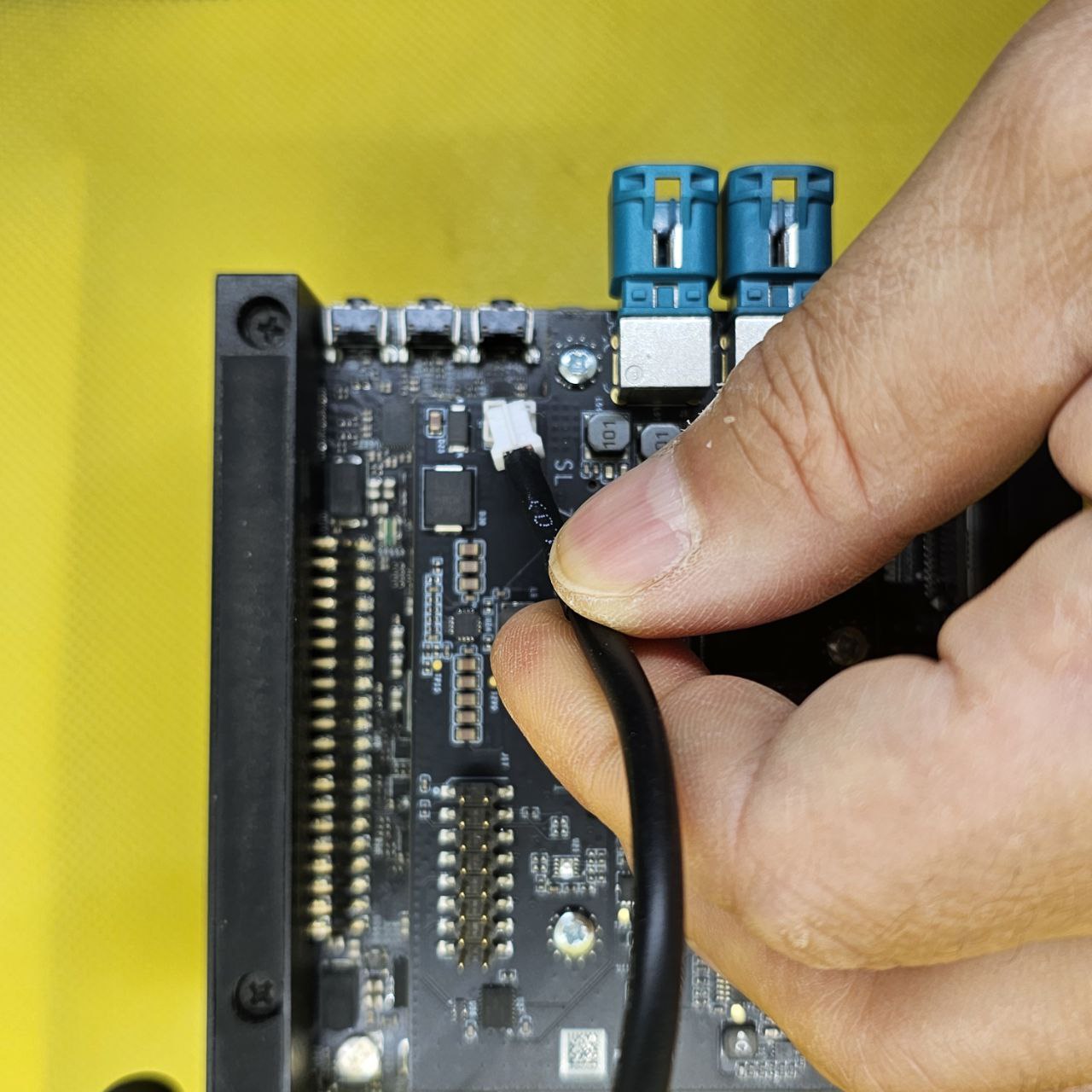

Connect the camera #
📌 Note: GMSL2 cameras must be ideally plugged before booting up. If it is not the case, you can restart the
zed_x_daemonthat will be installed by the driver in the next section.

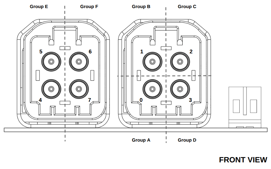

Multi-camera configurations #
- Group A: port #0
- Group B: port #1
- Group C: port #2
- Group D: port #3
- Group E: ports #4 and #5
- Group F: ports #6 and #7
| Camera Type | Camera Model | Max number of camerasper Group | Max Resolution/FPSper Group |
| Monocular | ZED X One GSZED X One S | Up to 2 cameras | HD1200@60fpsHD1080@60fpsSVGA@120fps |
| Monocular | ZED X One 4k | 1 cameraonly to port #4, #6 | 4k@15fpsHD1080@60fpsSVGA@60fps |
| Stereo | ZED XZED X Mini | 1 Camera | HD1200@60fpsHD1080@60fpsSVGA@120fps |
| Stereo | ZED XZED X Mini | Up to 2 Cameras | HD1200@30fpsHD1080@30fpsSVGA@60fps |
| Mixed | ZED X One GS/ZED X One S+ZED X/ZED X Mini | 1 ZED X One GS/S + 1 ZED X/Mini | HD1200@60fpsHD1080@60fpsSVGA@120fps |
📌 Note: Maximum resolution and framerate require no more than 2 cameras per 4-wire GMSL2 Fakra connector.

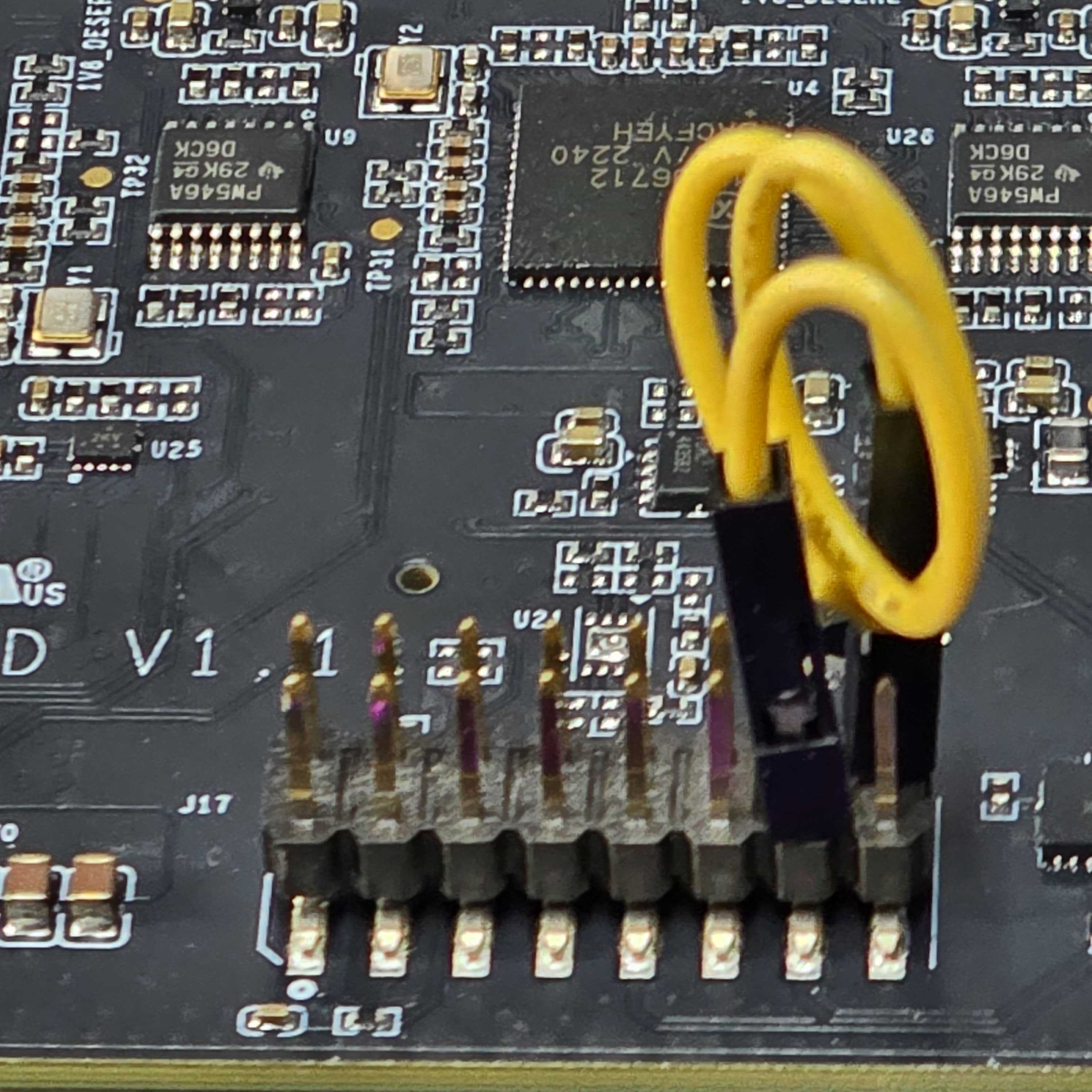

Enable full onboard synchronization #
The ZED Link Quad card is essentially a composition of two ZED Link Duo cards. By default, the two GMSL2 deserializers on the card are not synchronized together causing the cameras connected to one 4-wire GMSL2 Fakra connector to have different capture timestamps with respect to the other cameras connected to the second 4-wire GMSL2 Fakra connector. To enable full synchronization, you must follow this procedure:
Open a terminal (
Ctrl+Alt+T)Edit the zed_x_daemon service file:
sudo nano /etc/systemd/system/zed_x_daemon.service- Search for
sync_mode=<x>and change it tosync_mode=1 - Save the file and exit (
Ctrl+X,Y,Enter)
- Search for
Instruct
systemdto reload all service files and update its internal configurationsudo systemctl daemon-reloadConnect the pin #13 to the pin #16 of the synchronization connector.
📌 Note: It’s not required to connect the GND pins together as they are already connected internally on the board.
Restart the zed_x_daemon service
📌 Note: Although frames are hardware-synchronized with 15µs precision, software timestamps are assigned upon driver receipt and may exhibit slight millisecond-level jitter. Frames are considered synchronized if the timestamp difference is less than one frame period (
1000/FPSms).
