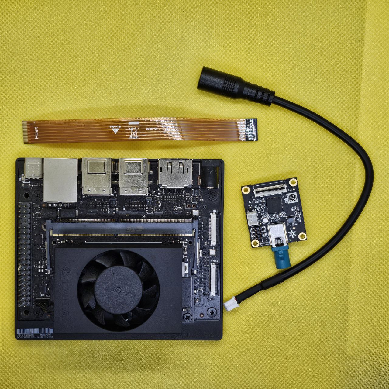

- 1x NVIDIA® Jetson™ Orin Nano Developer Kit or NVIDIA® Jetson™ Orin Nano Developer Kit mounting an Orin NX module.

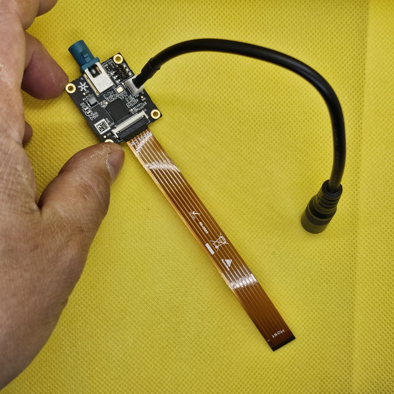

- 1x ZED Link Mono GMSL2 capture card
- 1x NVIDIA® Power supplier to power the Development Kit (included with the devkit)
- 1x FPC Camera Cable 22-pin 0.5mm Pitch (included in the box)

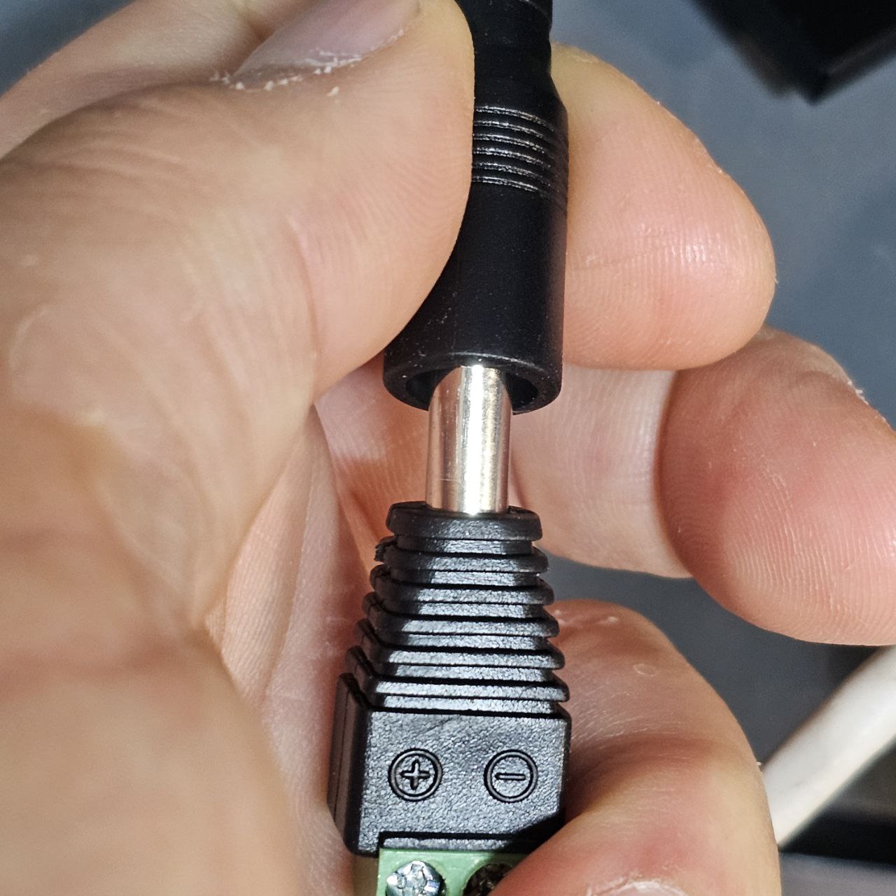

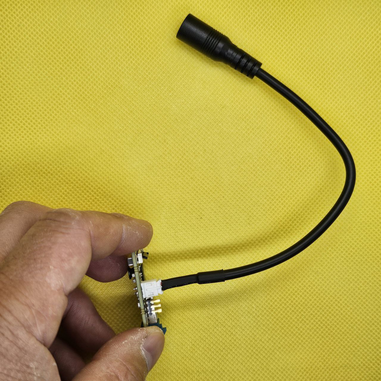

- 9V-14V (min 2W) power input (Barrel Jack 5.5 mm outer diameter, 2.5 mm inner diameter) to power the GMSL2 capture card (not included)

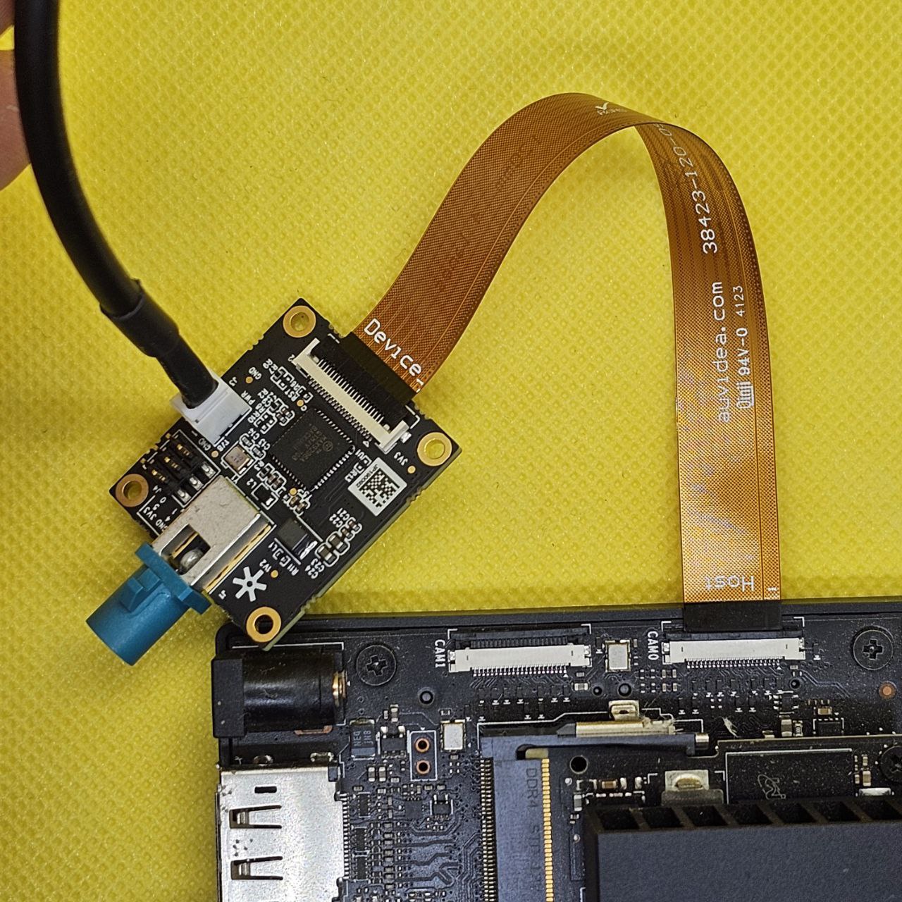

Connect the CSI cables at the MIPI 22-pin port of the capture card. Make sure the correct side is plugged in.
Warning: Inverting the side might damage the carrier board or the capture card.
Cabling the Carrier Board #

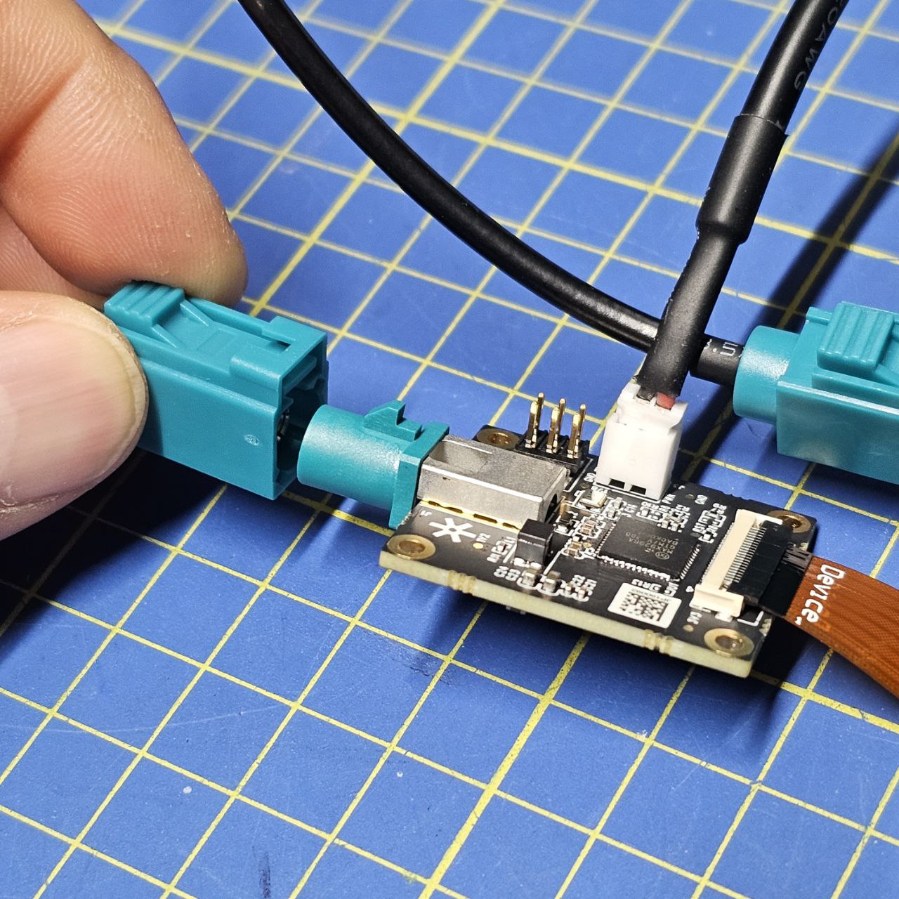

Connect the camera #
With the capture card still powered off, connect the female end of the cable to the capture card’s GMSL2 input. Again, a click informs you that the cable is secured.
📌 Note: GMSL2 cameras must be ideally plugged before booting up. If it is not the case, you can restart the
zed_x_daemonthat will be installed by the driver in the next section.
Once the cables are connected, plug the power for the GMSL2 capture card (9V-14V) so that cameras will be powered through the FAKRA cable (PoC).
