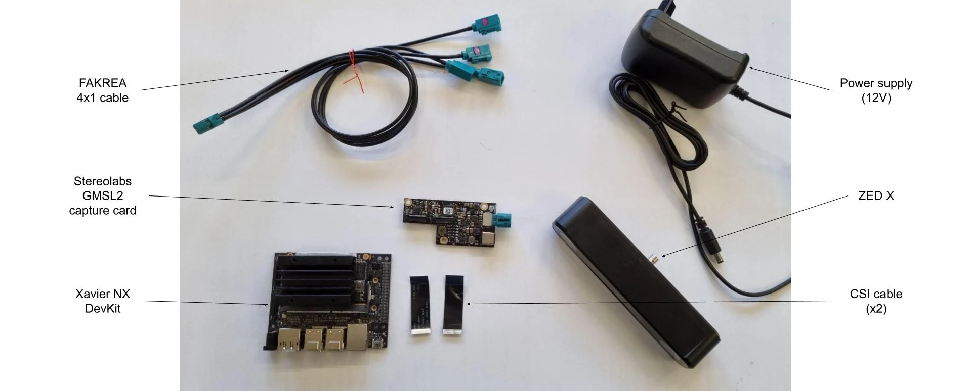

Prerequisites #
- 1x NVIDIA® Jetson™ Xavier NX Developer Kit.
- 1x ZED Link Duo GMSL2 capture card
- 1x 1-to-4 GMSL2 Fakra Male to Female cable (included in the box)
- 1x NVIDIA® Power supplier to power the Development Kit (included with the devkit)
- 2x FPC Camera Cable 15-pin 1.0mm (not included)*
- 9V-19V (min 2W) power input (Barrel Jack 5.5 mm outer diameter, 2.5 mm inner diameter) to power the GMSL2 capture card (not included)

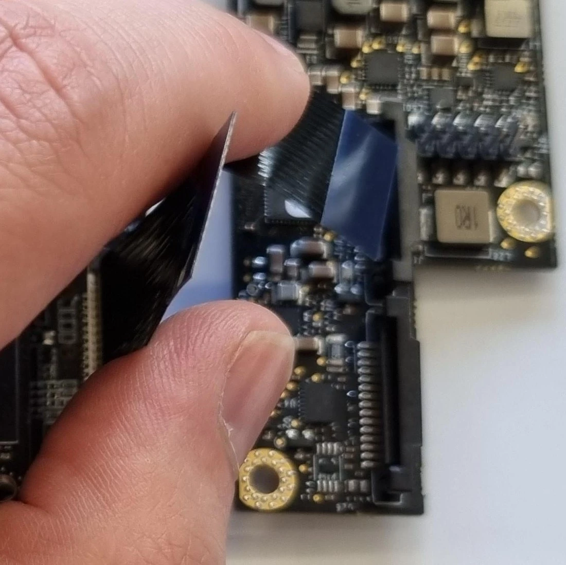

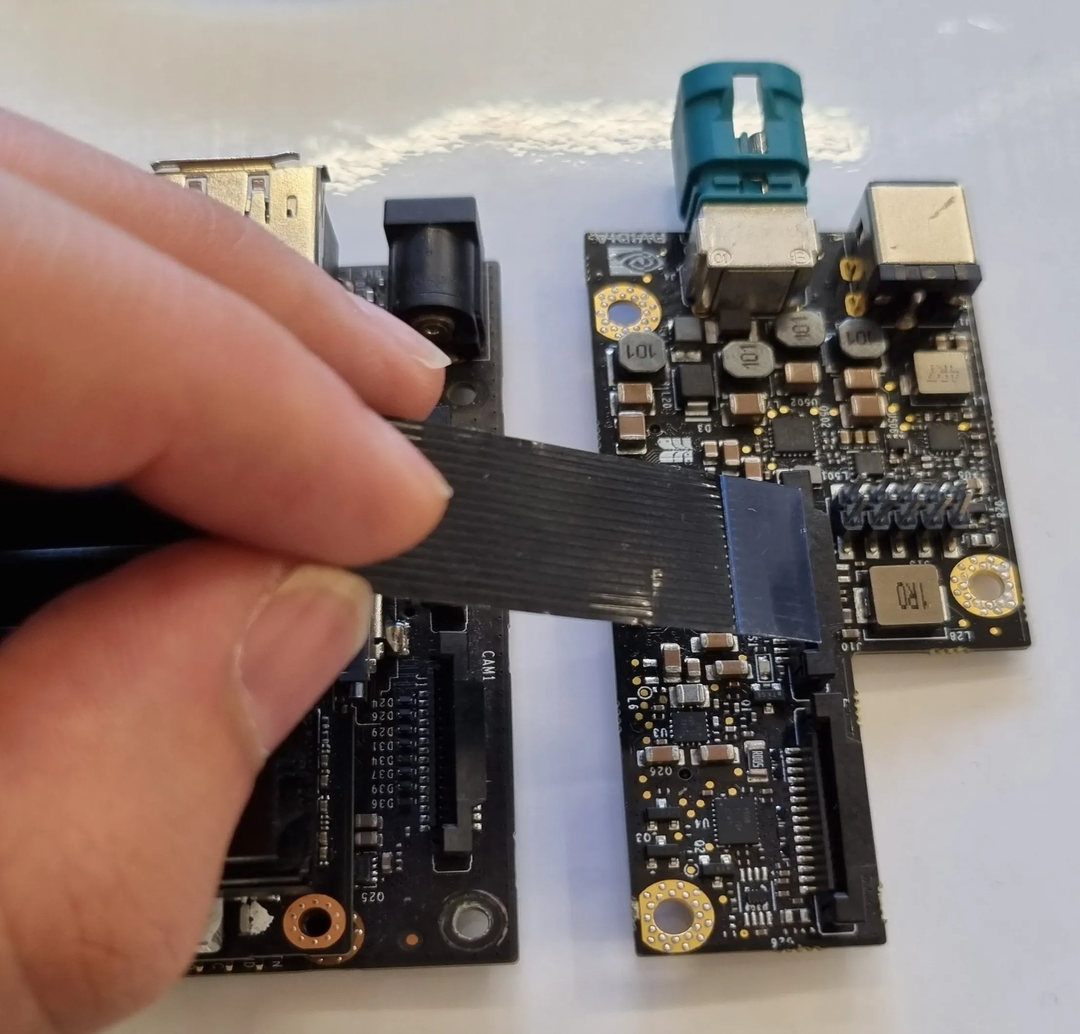

Connect the CSI cable at each MIPI 15-pin port of the carrier board. Make sure the correct side is plugged in for each port.
Warning: Inverting the side might damage the carrier board or the capture card.
Both MIPI cables must be connected to have access to 2x ZED GMSL2 cameras on the capture card.

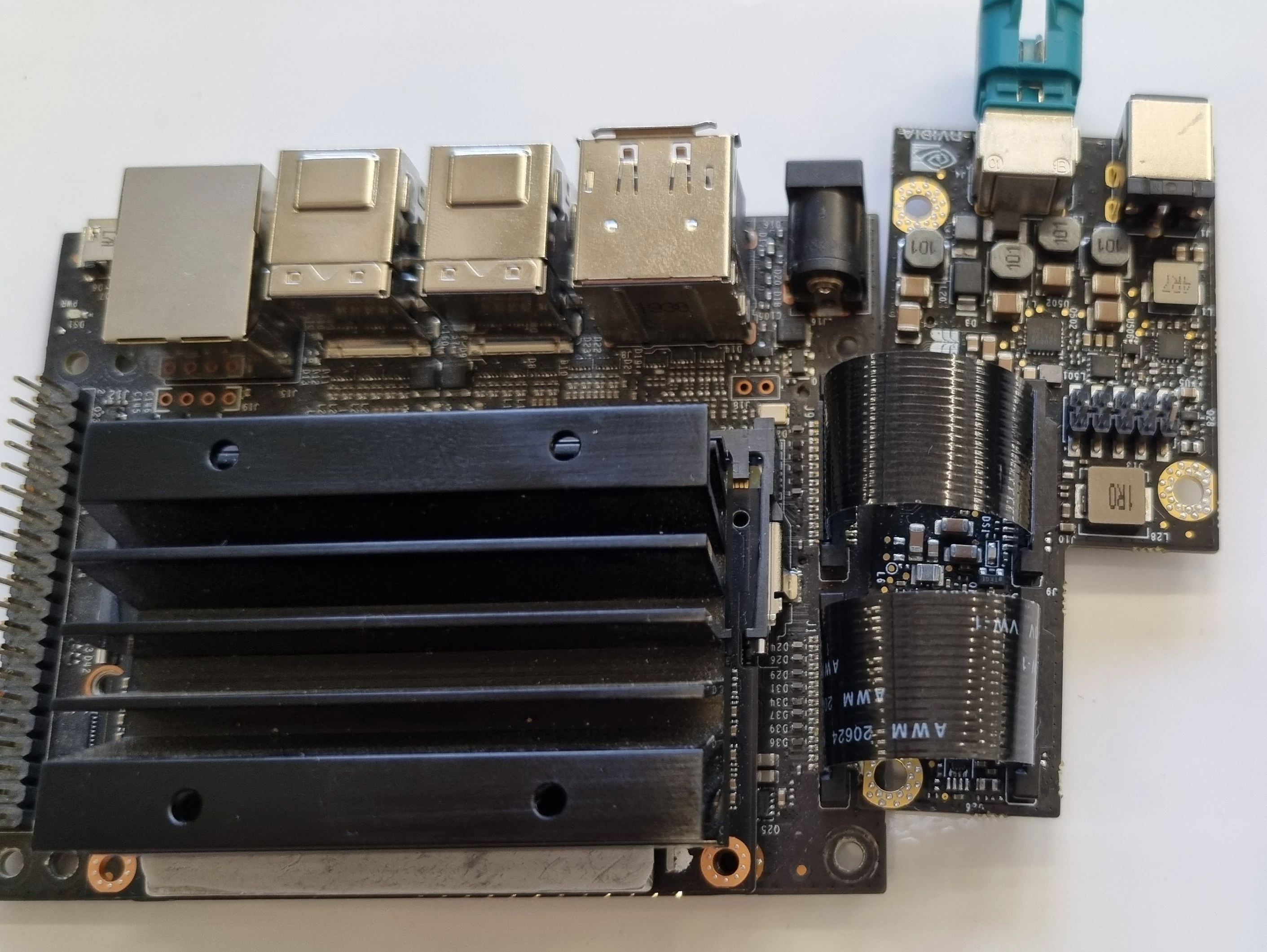

Cabling the Carrier Board #
Connect the CSI cable to the capture card.
Make sure that J9/CAM0 is connected to the centered MIPI port of the GMSL2 capture card.
J1/CAM1 must be connected to the MIPI port close to the edge.
Once connected, the setup should look like as in the following picture:

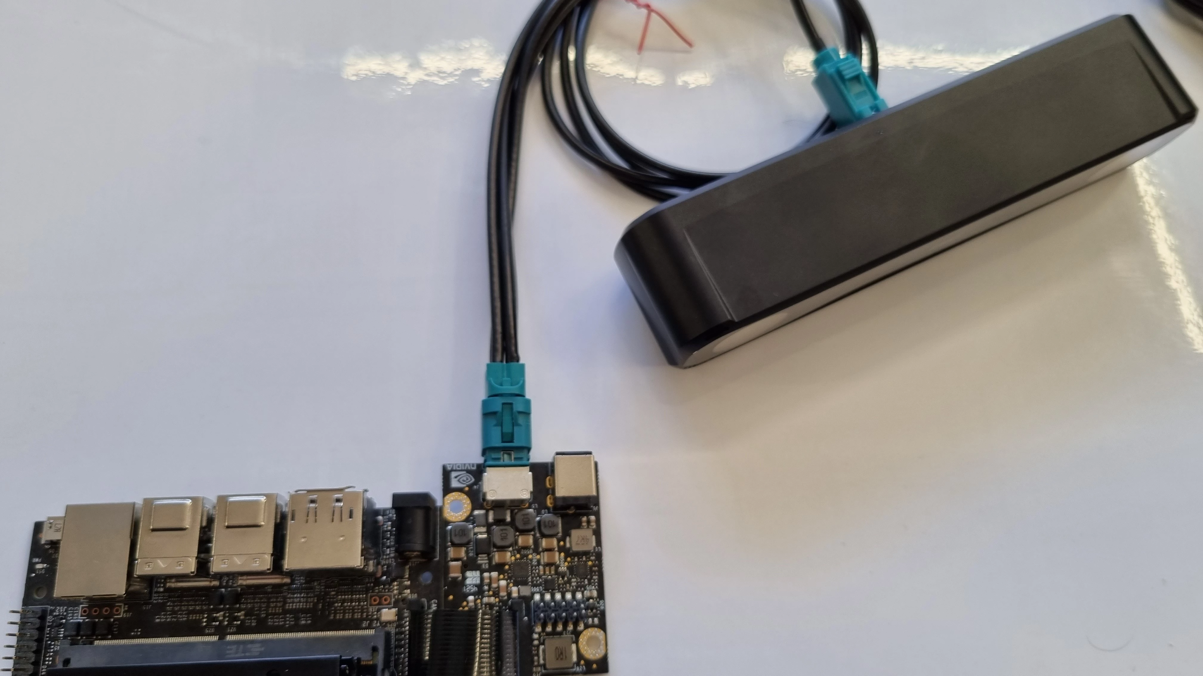

Connect the camera #
Connect the GMSL2 Fakra cable female end to your ZED X. When you hear a click, the cable is securely connected to the camera.
📌 Note: GMSL2 cameras must be ideally plugged before booting up. If it is not the case, you can restart the
zed_x_daemonthat will be installed by the driver in the next section.

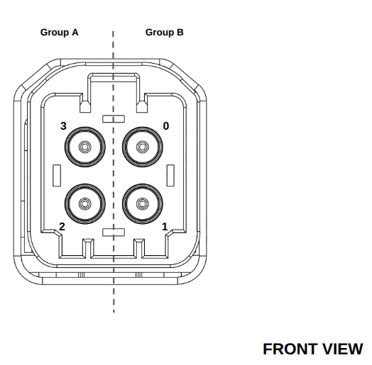

Multi-camera configurations #
- Group A: port #0 and port #1
- Group B: port #2 and port #3
| Camera Type | Camera Model | Max number of camerasper Group | Max Resolution/FPSper Group |
| Monocular | ZED X One GSZED X One S | Up to 2 cameras | HD1200@60fpsHD1080@60fpsSVGA@120fps |
| Monocular | ZED X One 4k | 1 cameraonly to port #0, #2 | 4k@15fpsHD1080@60fpsSVGA@60fps |
| Stereo | ZED XZED X Mini | 1 Camera | HD1200@60fpsHD1080@60fpsSVGA@120fps |
| Stereo | ZED XZED X Mini | Up to 2 Cameras | HD1200@30fpsHD1080@30fpsSVGA@60fps |
📌 Note: Maximum resolution and framerate require no more than 2 cameras per 4-wire GMSL2 Fakra connector.
