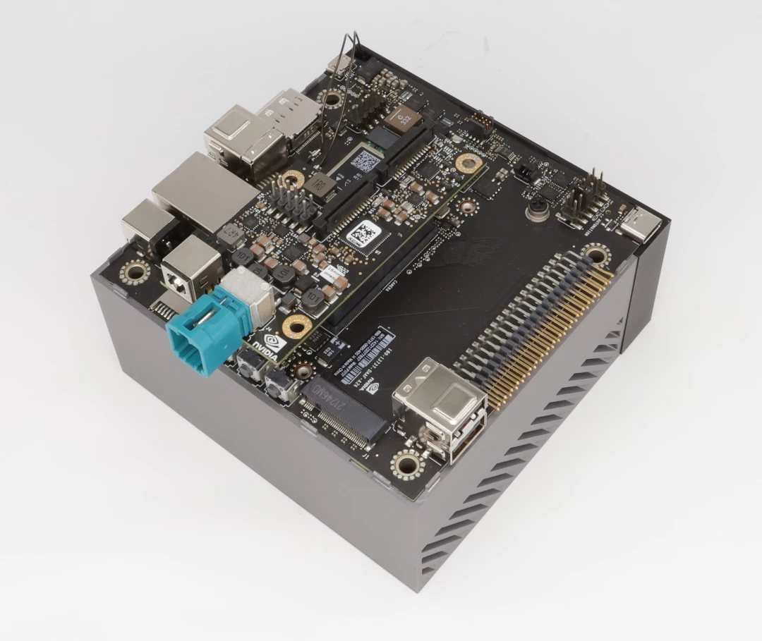

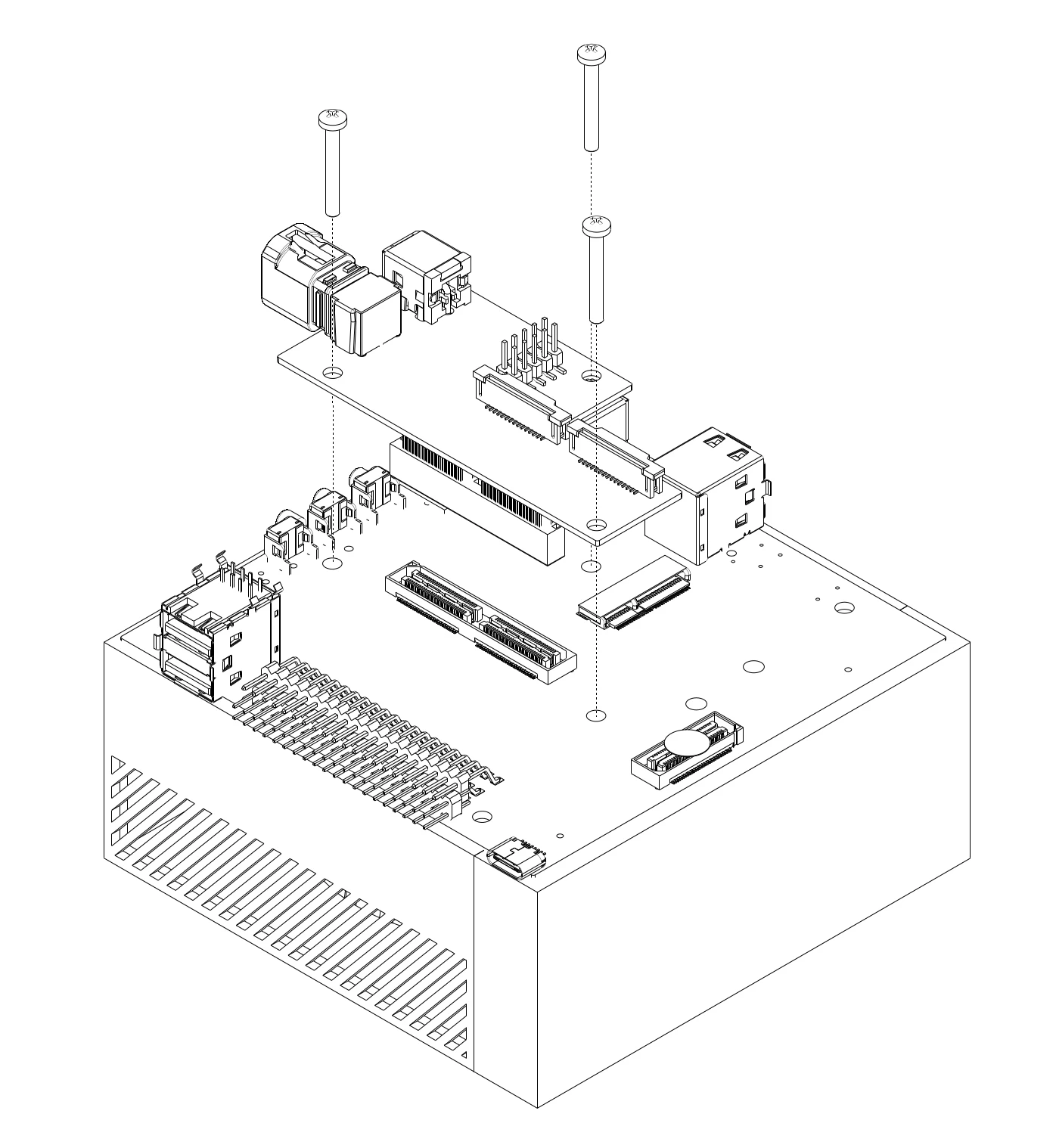

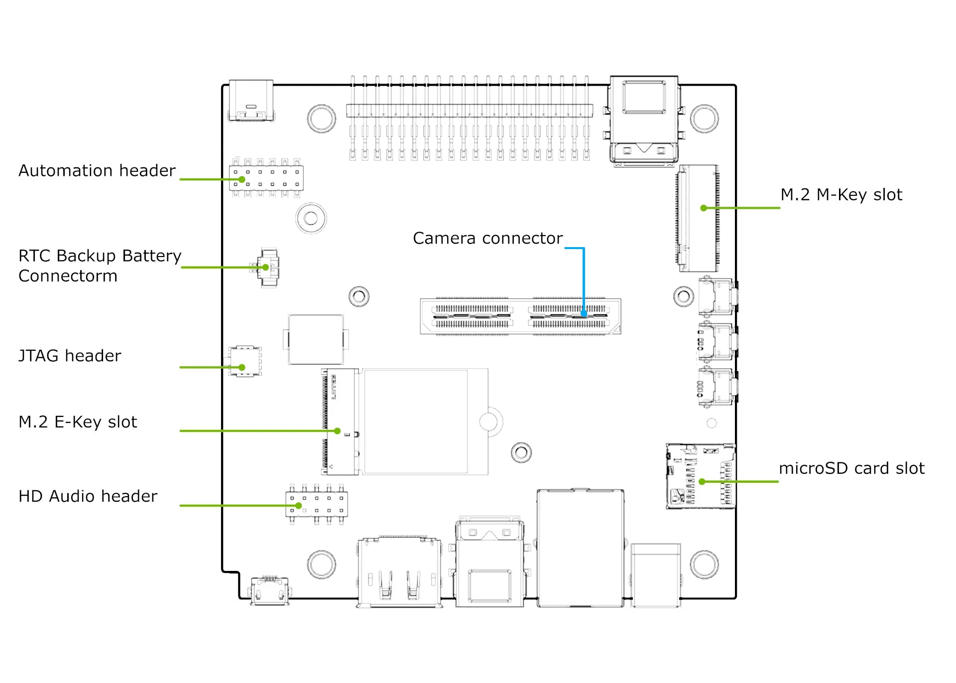

Plug in the capture card in the ‘Camera connector’ slot and fix it by using the three provided screws, as shown in the following diagrams:
⚠️ Warning: It’s important to use the provided spacers and screws to ensure a secure fit and avoid damaging the ZED Link device and the NVIDIA® Jetson™ AGX Developer Kit carrier board. StereoLabs is not responsible for any damage caused by improper installation and will not provide support for issues arising from incorrect installation procedures.
📌 Note: The capture card is powered by the Dev Kit, therefore you do not need to use an additional power supply for the card.

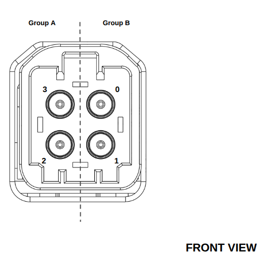

- Group A: port #0 and port #1
- Group B: port #2 and port #3
| Camera Type | Camera Model | Max number of camerasper Group | Max Resolution/FPSper Group |
| Monocular | ZED X One GSZED X One S | Up to 2 cameras | HD1200@60fpsHD1080@60fpsSVGA@120fps |
| Monocular | ZED X One 4k | 1 cameraonly to port #0, #2 | 4k@15fpsHD1080@60fpsSVGA@60fps |
| Stereo | ZED XZED X Mini | 1 Camera | HD1200@60fpsHD1080@60fpsSVGA@120fps |
| Stereo | ZED XZED X Mini | Up to 2 Cameras | HD1200@30fpsHD1080@30fpsSVGA@60fps |
| Mixed | ZED X One GS/ZED X One S+ZED X/ZED X Mini | 1 ZED X One GS/S + 1 ZED X/Mini | HD1200@60fpsHD1080@60fpsSVGA@120fps |
📌 Note: Maximum resolution and framerate require no more than 2 cameras per 4-wire GMSL2 Fakra connector.
