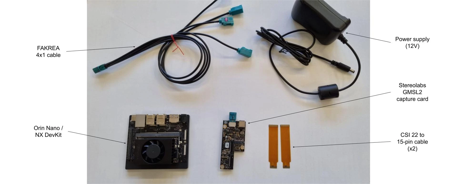

- 1x NVIDIA® Jetson™ Orin Nano Developer Kit or NVIDIA® Jetson™ Orin Nano Developer Kit mounting an Orin NX module.
- 1x ZED Link Duo GMSL2 capture card
- 1x 1-to-4 GMSL2 Fakra Male to Female cable (included in the box)
- 1x NVIDIA® Power supplier to power the Development Kit (included with the devkit)

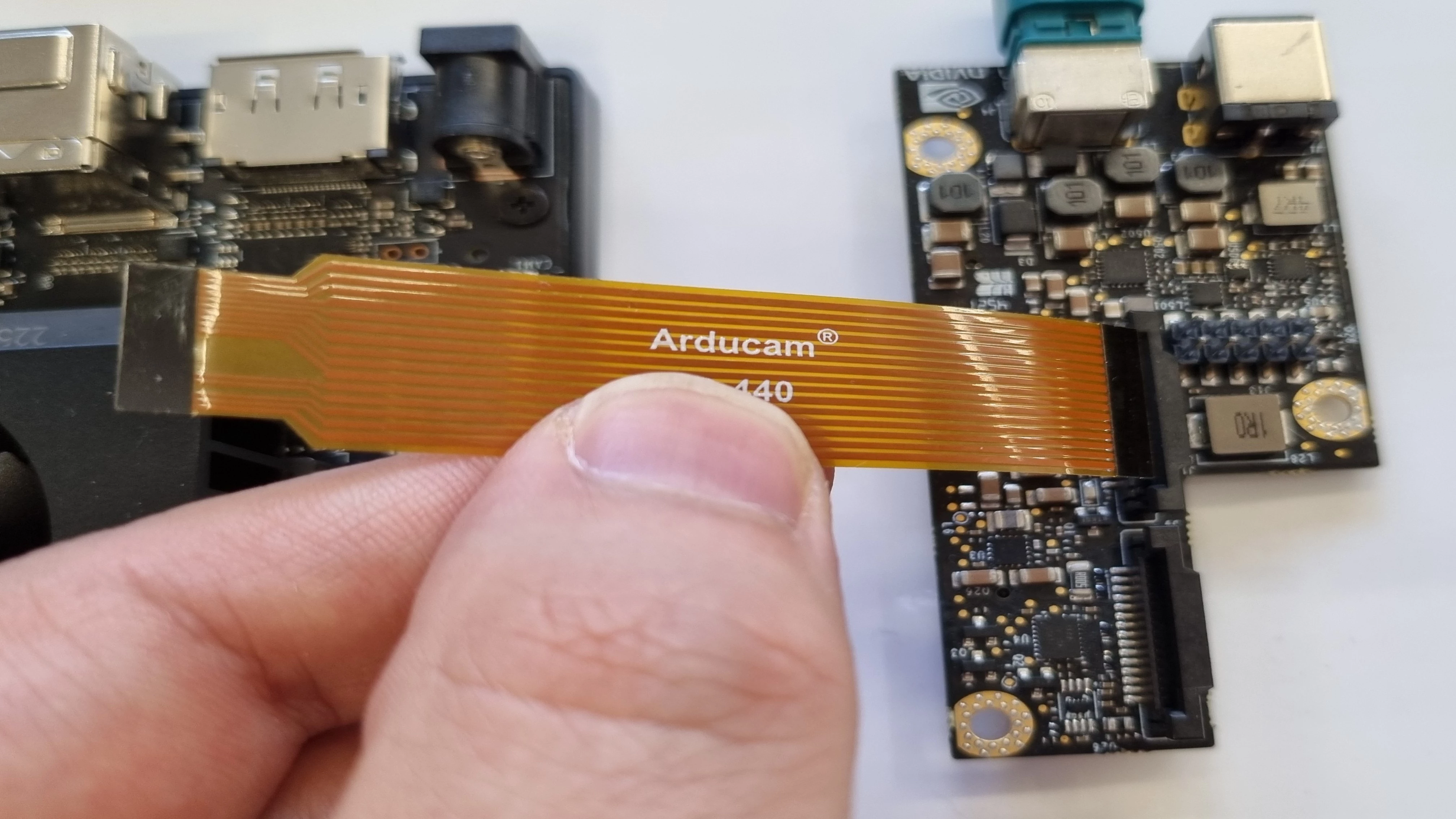

- 2x FPC Camera Cable 22-pin 0.5mm Pitch to 15-pin 1.0mm Pitch (not included)*
- 9V-19V (min 2W) power input (Barrel Jack 5.5 mm outer diameter, 2.5 mm inner diameter) to power the GMSL2 capture card (not included)
📌 Note: PC Camera Cables transmit video signals. If the cable length exceeds 12 cm, the video signal may become noisy or corrupted. It is recommended to keep the cable length within this limit.

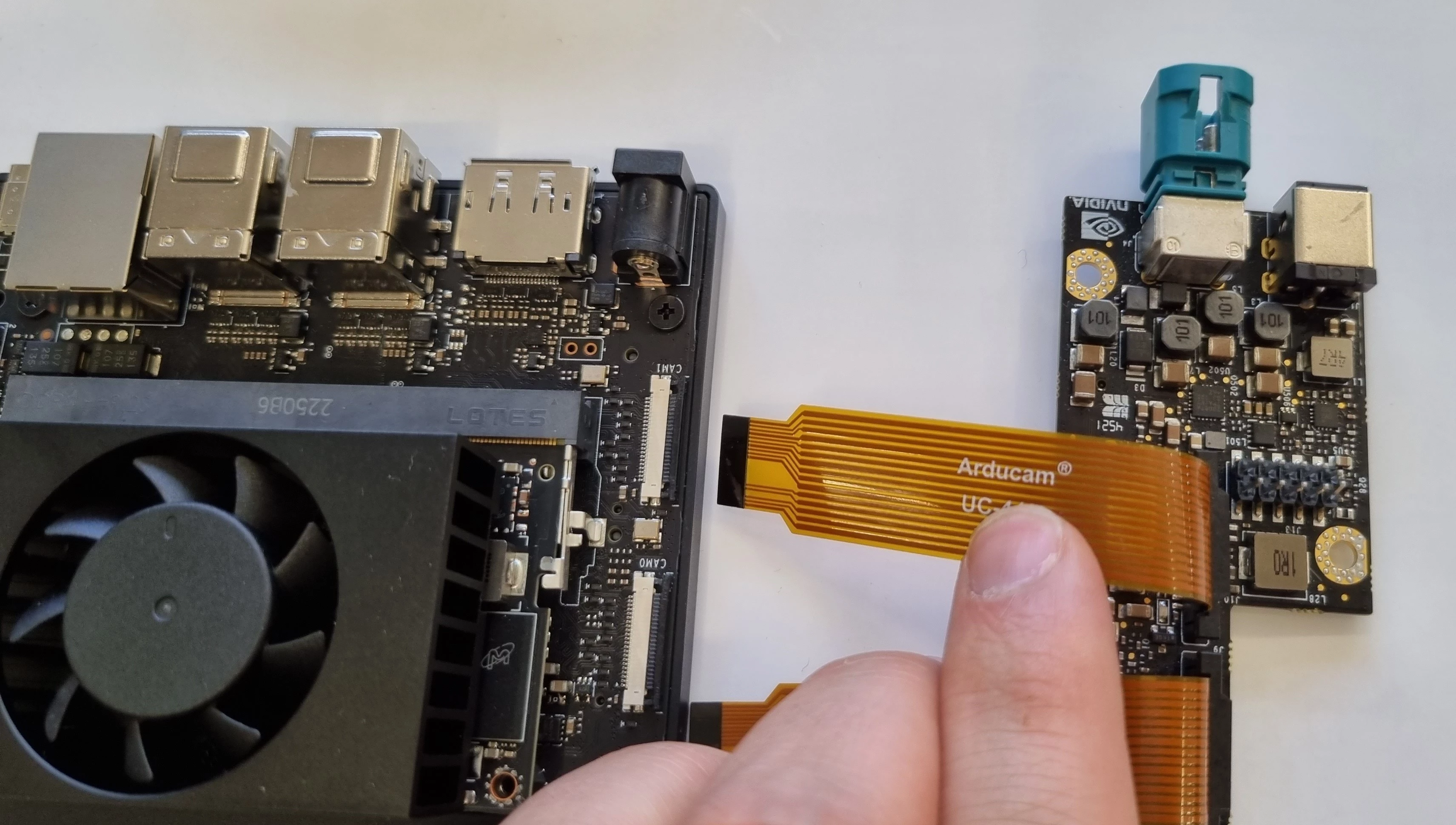

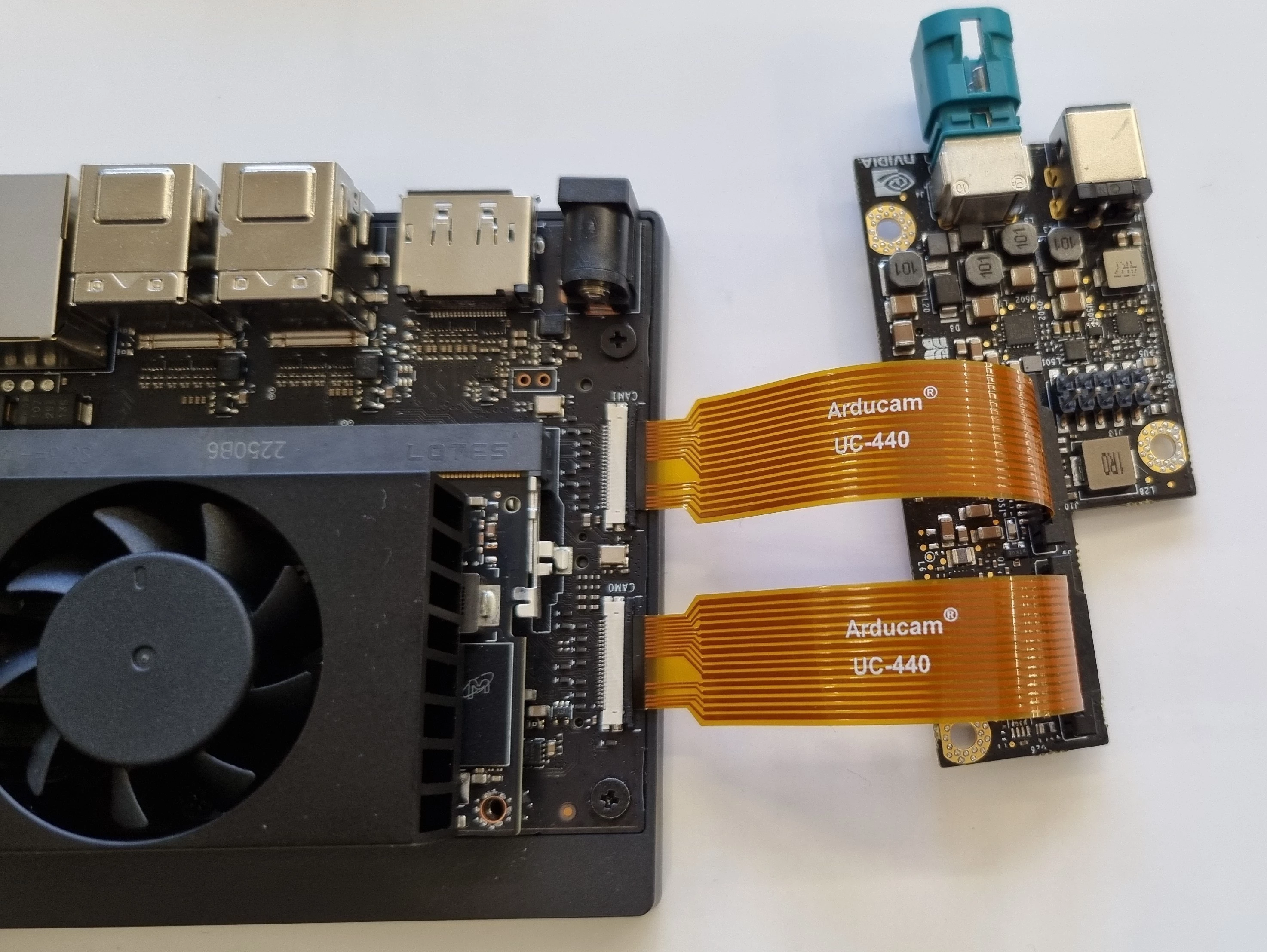

Connect both CSI cables at each MIPI 22-pin port of the capture card. Make sure the correct side is plugged in for each port.
Warning: Inverting the side might damage the carrier board or the capture card.
Both MIPI cables must be connected to have access to 2x ZED X on the capture card.
Cabling the Carrier Board #
Make sure that CAM1 is connected to the centered MIPI port of the GMSL2 capture card.
CAM0 must be connected to the MIPI port close to the edge.

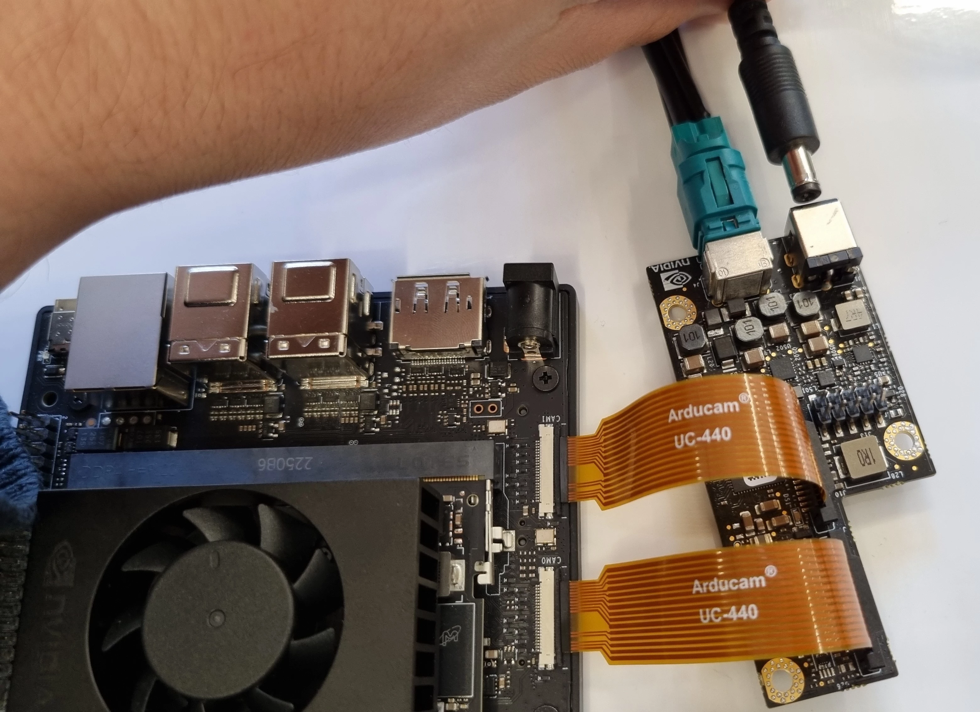

Once connected, the setup should look like as in the following picture:
Connect the camera #
Connect the GMSL2 Fakra cable female end to your ZED X. When you hear a click, the cable is securely connected to the camera.

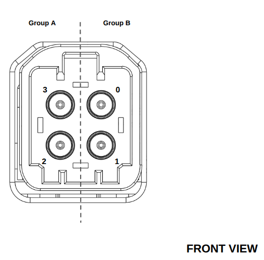

Multi-camera configurations #
- Group A: port #0 and port #1
- Group B: port #2 and port #3

📌 Note: Maximum resolution and framerate require no more than 2 cameras per 4-wire GMSL2 Fakra connector.
