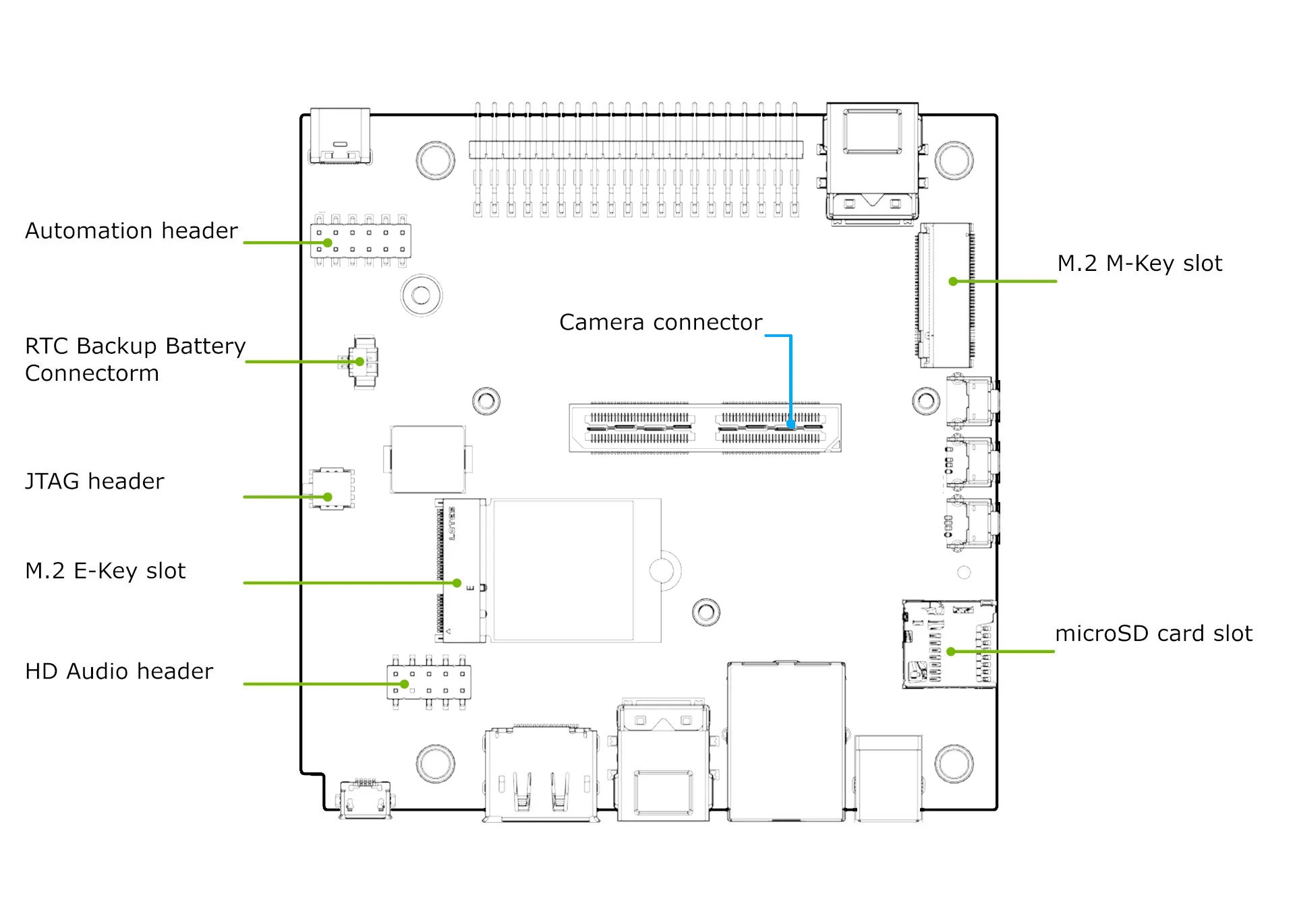

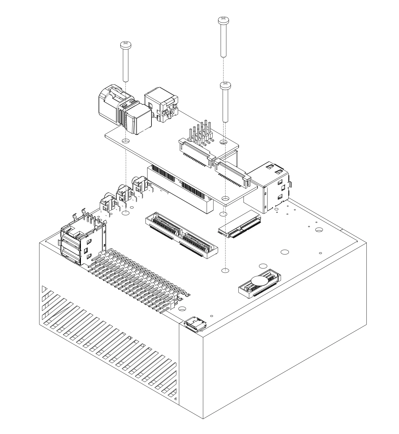

Install the GMSL2 Capture Card #
Plug in the capture card in the ‘Camera connector’ slot and fix it by using the three provided screws, as shown in the following diagrams:
⚠️ Warning: It’s important to use the provided spacers and screws to ensure a secure fit and avoid damaging the ZED Link device and the NVIDIA® Jetson™ AGX Developer Kit carrier board. StereoLabs is not responsible for any damage caused by improper installation and will not provide support for issues arising from incorrect installation procedures.
📌 Note: The capture card is powered by the Dev Kit, therefore you do not need to use an additional power supply for the card.

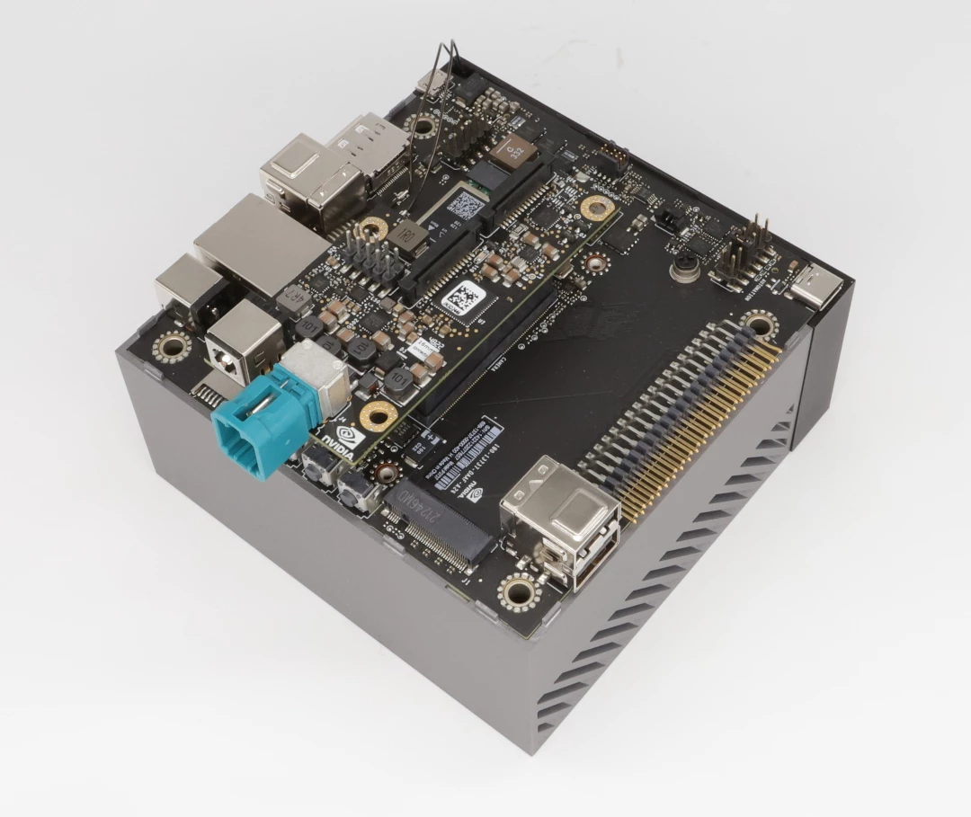

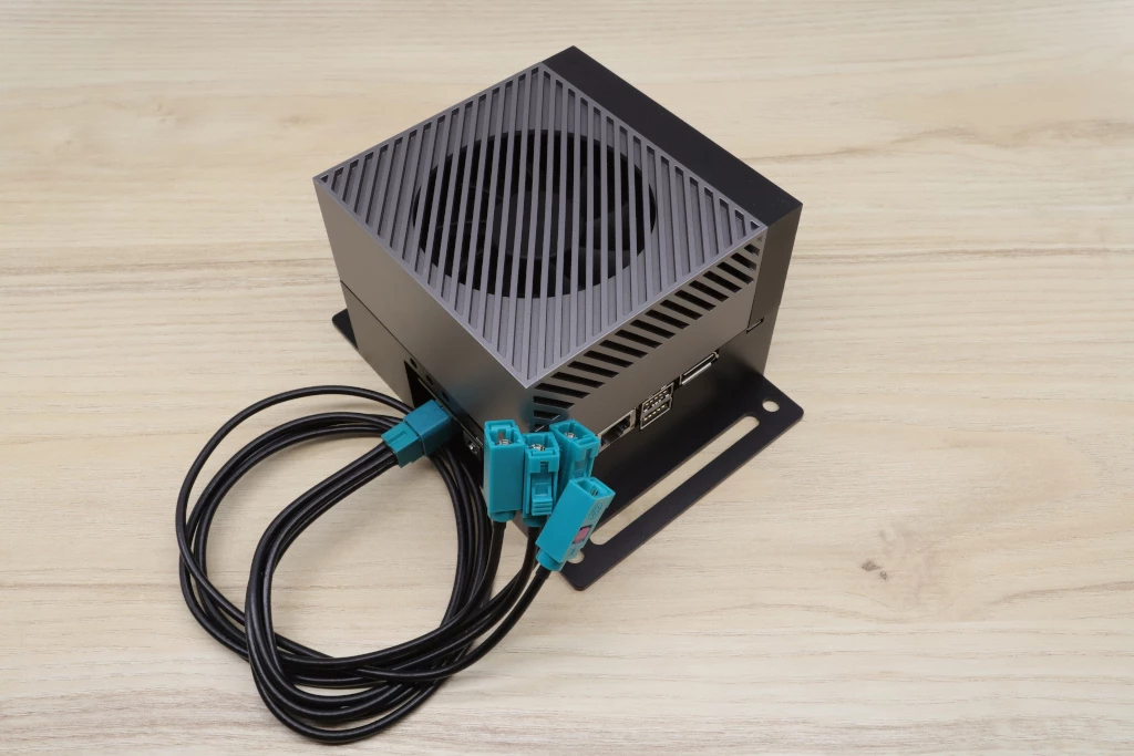

Connect the camera #
Connect the GMSL2 Fakra cable female end to your GMSL2. When you hear a click, the cable is securely connected to the camera.

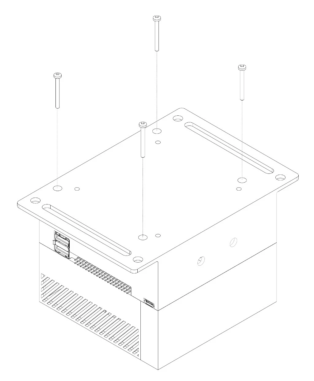

AGX Orin Developer Kit Enclosure #
If you are using an AGX Orin Developer Kit, we recommend you use the Enclosure for the AGX Orin Developer Kit available for purchase on the Stereolabs store, to securely integrate our GMSL2 Capture Card while keeping the electronics safe. It also allows you to mount the Dev Kit on any surface using VESA 75x75, and gives the possibility to add WiFi antennas to boost your AGX Orin wireless transmissions.
Installing the AGX Orin Enclosure

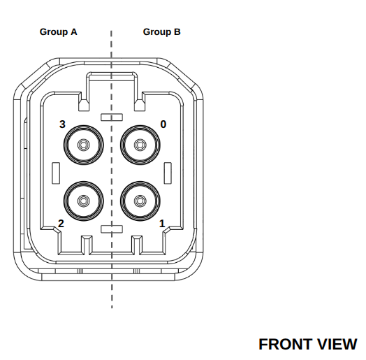

Multi-camera configurations #
- Group A: port #0 and port #1
- Group B: port #2 and port #3
