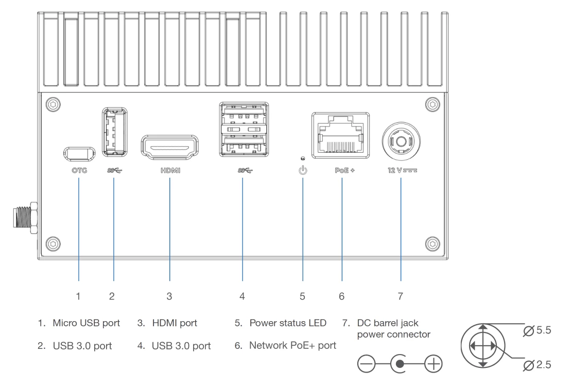

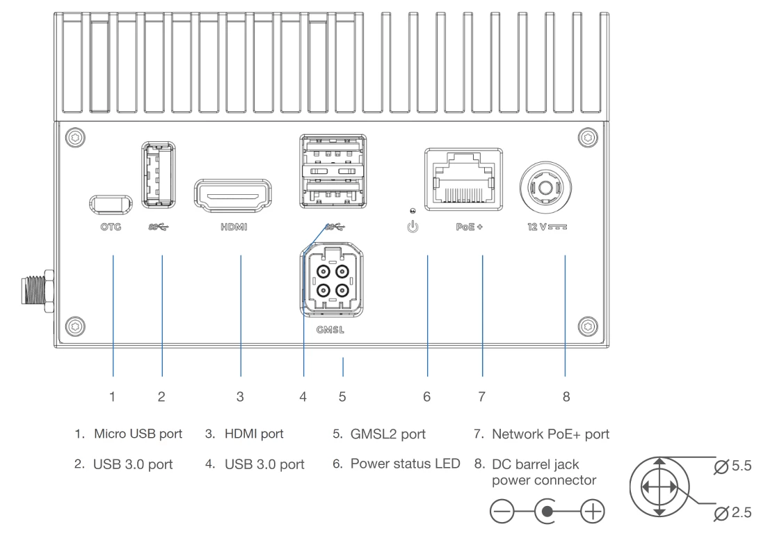

Connection panel
All the connection ports are available in the front panel.
GMSL panel Connection panel
PoE+ specifications:
  • Max Power Mode: 15 W
  • Voltage: 42.5 ~ 57 V
  • Current: 600 mA
  • Cabling: Category 5

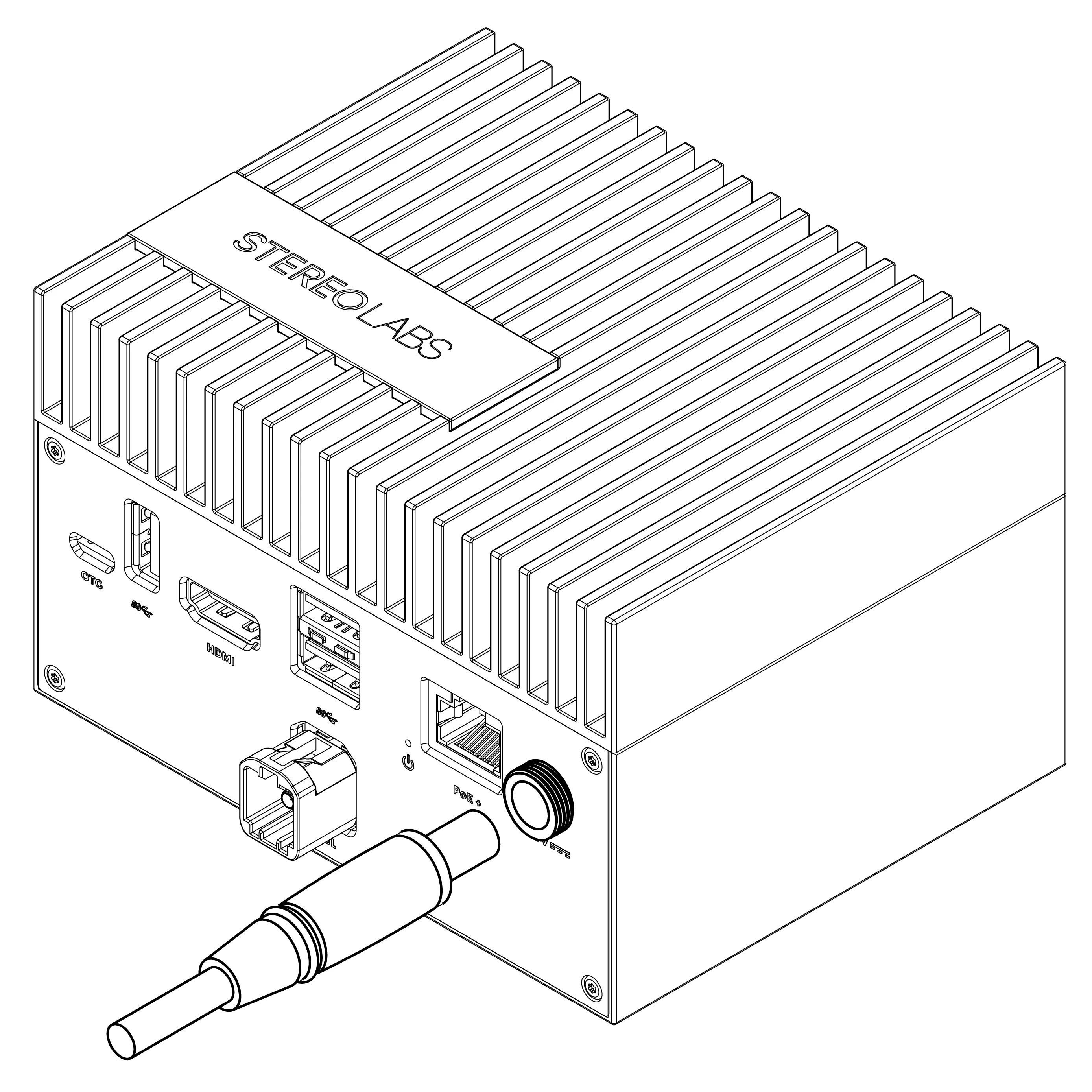

01. Plug in the power supply
Always unplug the power supply from the wall outlet before connecting or disconnecting the jack connector from the ZED Box. Plugging or unplugging the jack connector while the power supply is powered can generate high voltage spikes that may permanently damage the ZED Box carrier board.
Connect the provided power supply to the jack connector, if you do not use the PoE+ feature.
With the power supplied by the jack connector, the ZED Box can use the 25W power mode.
You can supply the ZED Box with PoE+ instead of the jack connector. But in that case, do not exceed the 15W power mode on your ZED Box.

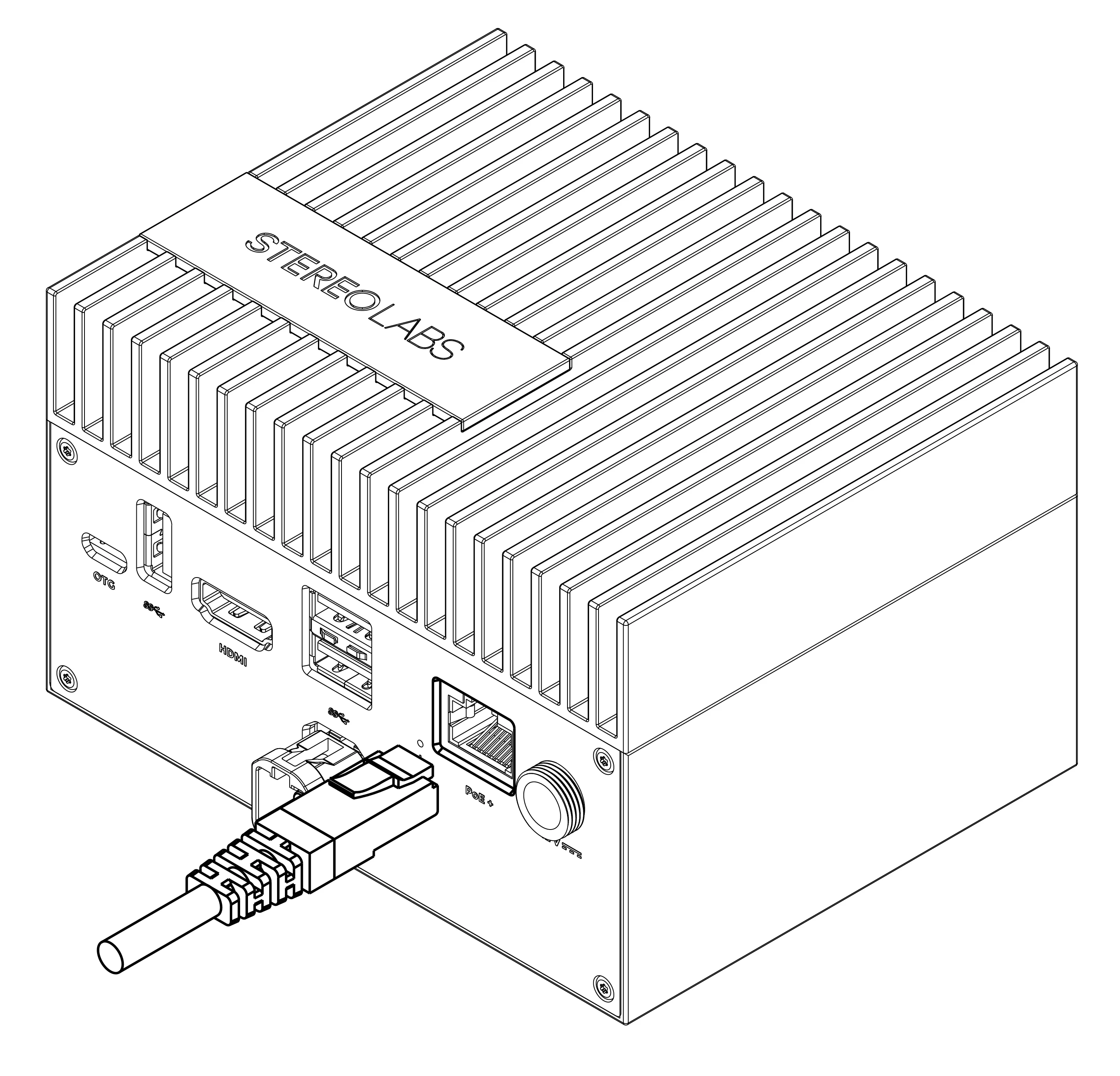

02. Connect to your network
Connect to your network using the Ethernet port.
A PoE+-enabled switch allows you to power the system without using the jack connector.
In PoE+, do not exceed the 15W power mode on your ZED Box.

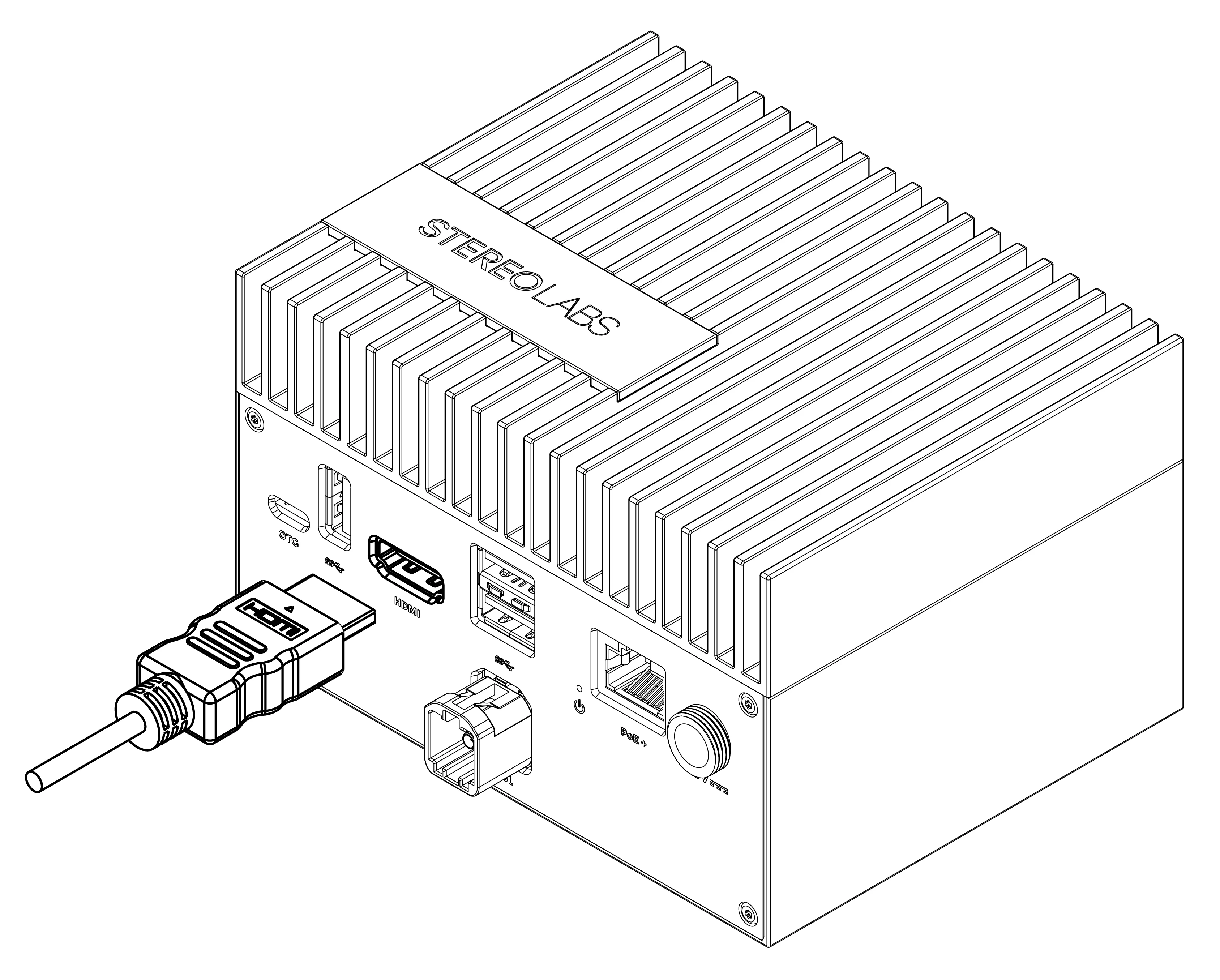

03. Connect to your display
Connect to your display by using the HDMI port.

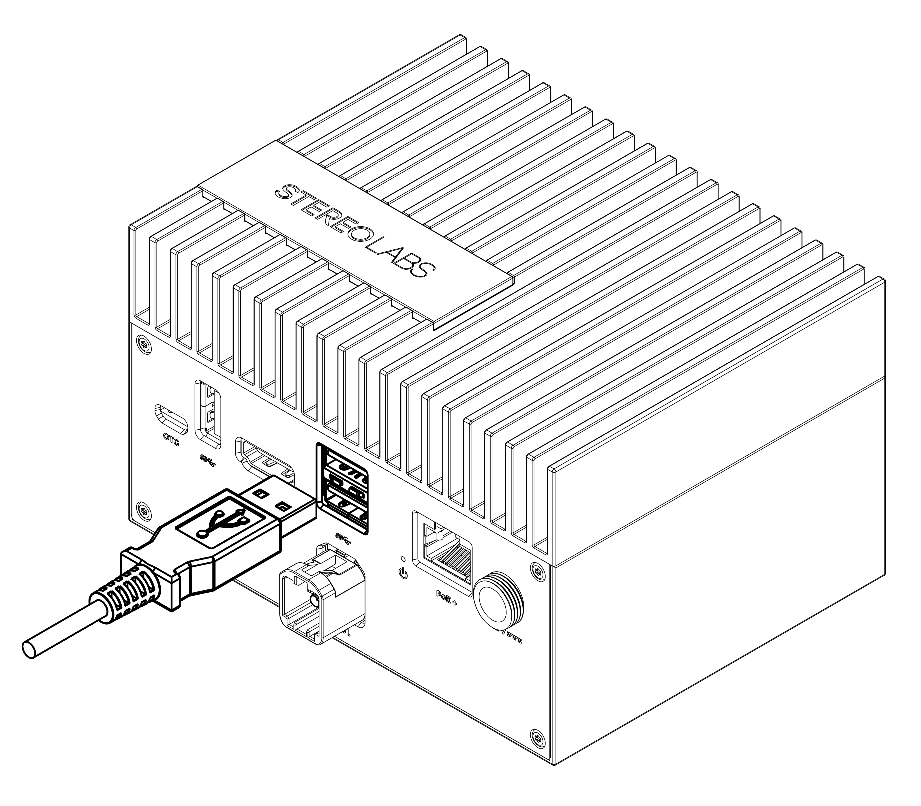

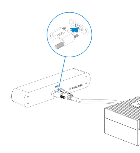

06. Connect your ZED camera
06.a Connect your ZED USB camera
The ZED camera must be connected to the USB 3.0 port to be able to acquire data at maximum resolution and framerate.

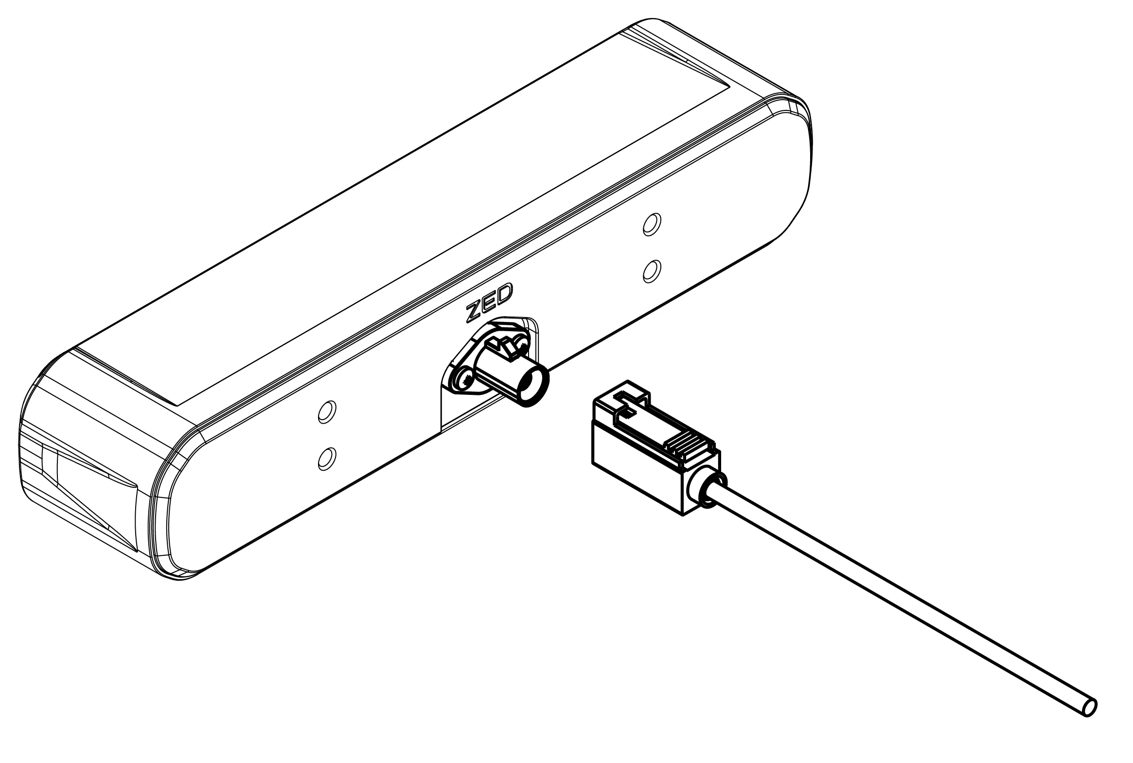

06.b Connect your ZED GMSL camera
When using the ZED X One 4K, only two of them are supported simultaneously, or one ZED X One 4K together with one Global Shutter model (stereo or monocular), respecting the index rule: the 4K model must always be connected to the lower-ranked port index.
When using 4x cameras on a single 4-wire GMSL2 Fakra connector, the maximum frame rate is limited to 30 FPS for HD Resolutions or 60 FPS for SVGA resolution. Please refer to the multi-camera guide for details on the allowed multi-camera configurations.

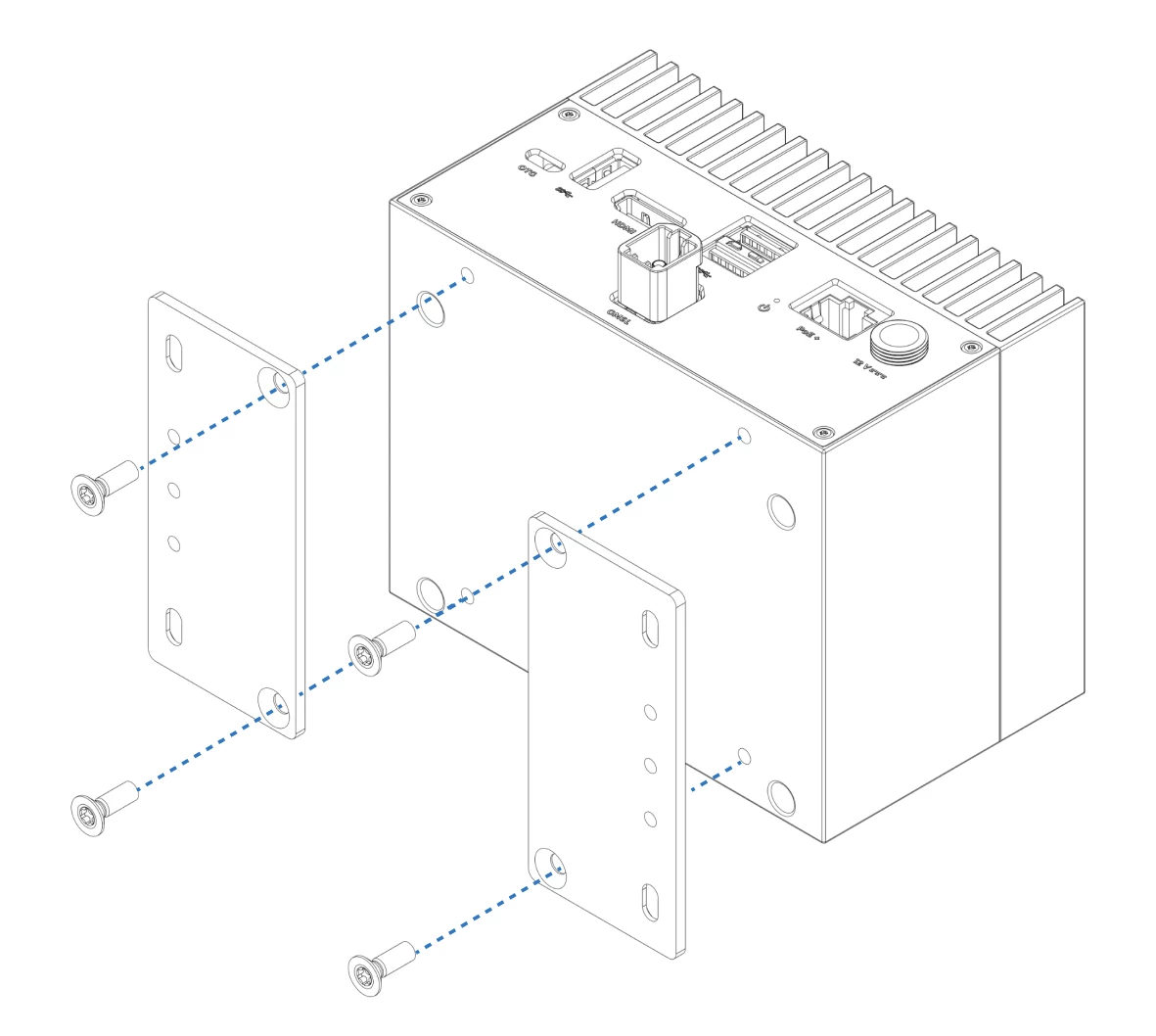

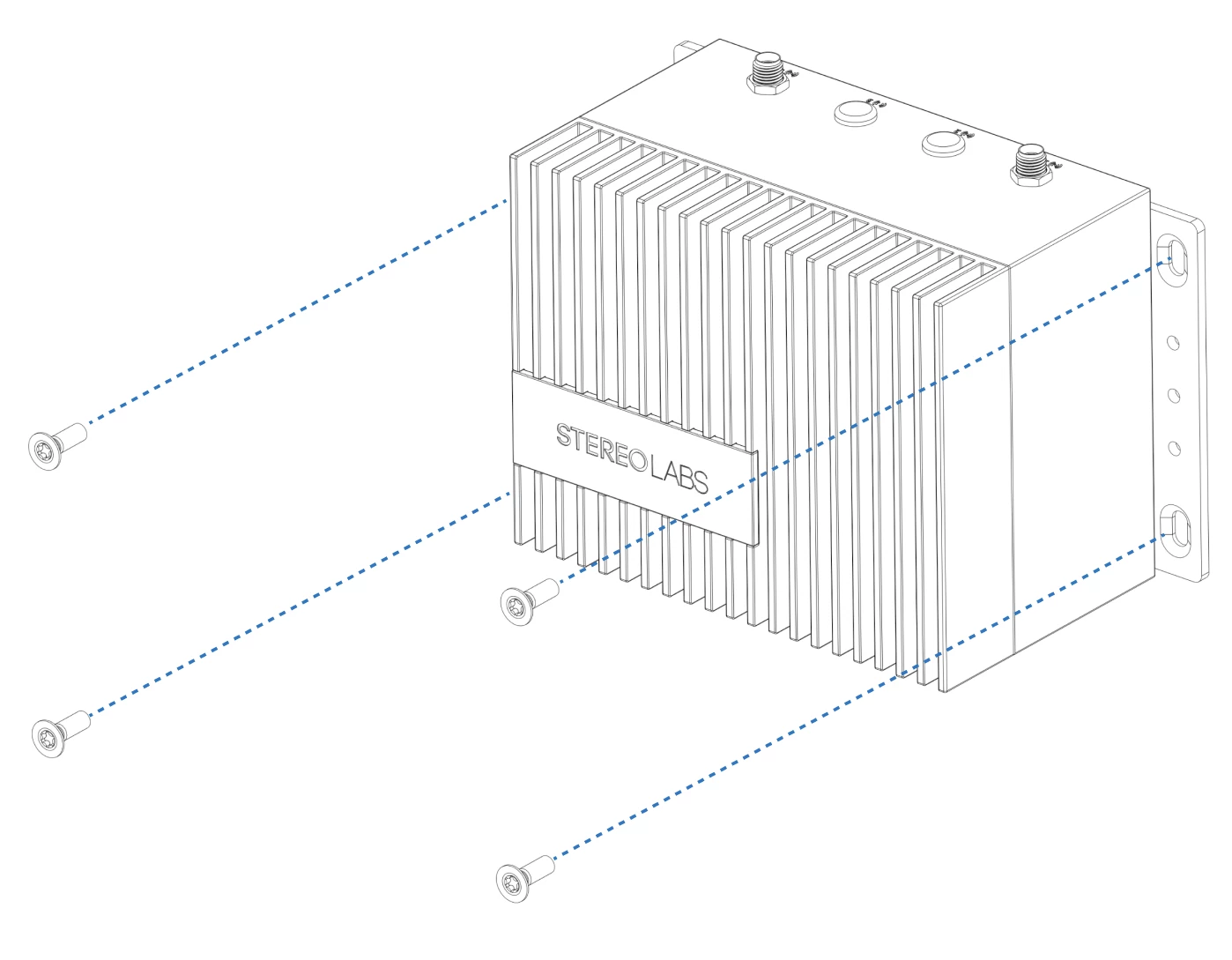

Install on a wall with brackets
Screw the brackets to the case:
Screw the ZED Box to the wall:
Screws for the wall are not included.
