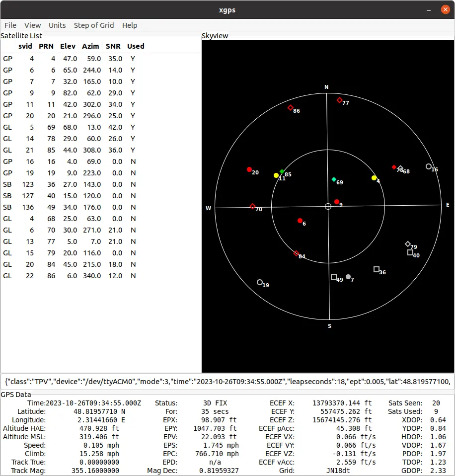

You can test that gpsd is working properly with the tool installed with gpsd:
# GNSS and satellite data in graphical interface
xgps

You can now run xgps and wait for the GNSS to get an RTK fix. (The ECEF pAcc gives the horizontal accuracy; with an RTK FIX status this value should be of about *a few centimeters)
