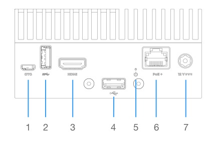

Connection panel #
All the connection ports are available in the front panel.
  1. Micro USB port (OTG - Firmware upgrade)
  2. USB 3.0 port
  3. HDMI port
  4. USB 2.0 port
  5. Power Status LED
  6. Network PoE+ * port
  7. 12V AC/DC Power Adapter port

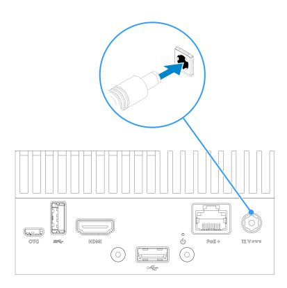

01. Plug in the power supply (optional) #
Connect the provided power supply to the jack connector, if you do not use PoE+ feature.

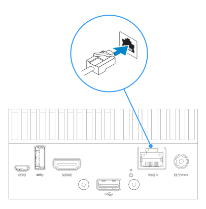

02. Connect to your network #
Connect to your network using the PoE+ Ethernet port.
📌 Note: A PoE+* enabled switch is needed to power the system without using the jack connector.

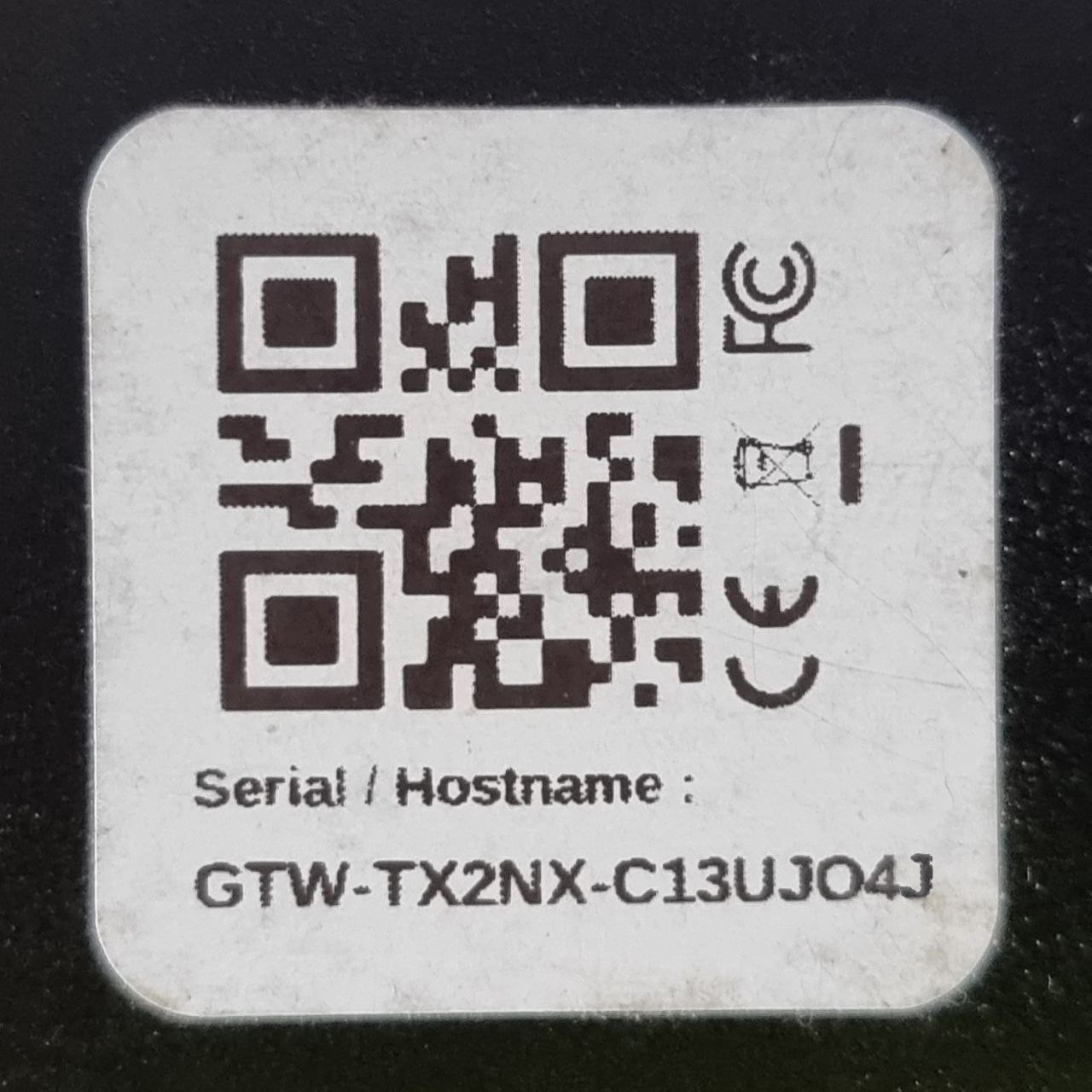

📌 Note: The default hostname of the device is its serial number and it is reported on the bottom of the case below the QR-Code.

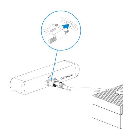

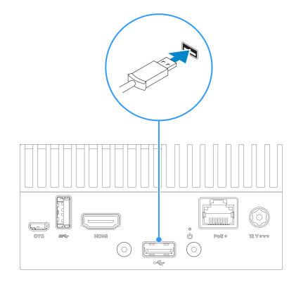

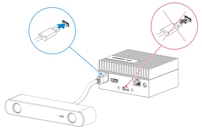

06. Connect your ZED camera #
📌 Note: The ZED camera must be connected to the USB 3.0 port to be able to acquire data at maximum resolution and framerate.

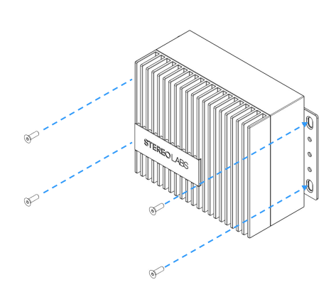

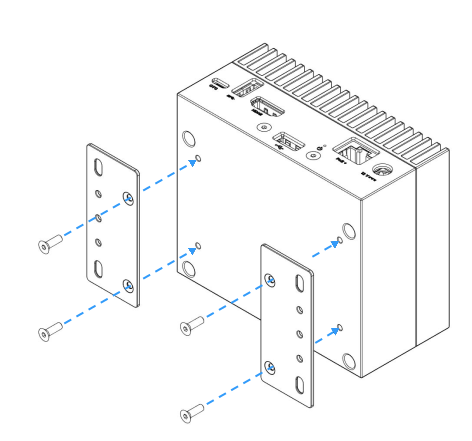

Install on a wall with brackets #
Screw the brackets to the case:
Screw the ZED Box to the wall:
📌 Note: Screws for the wall are not included.

You can use the IP address of the ZED Box, if you know it, or the hostname that is reported on the bottom of the case just below the QR Code.

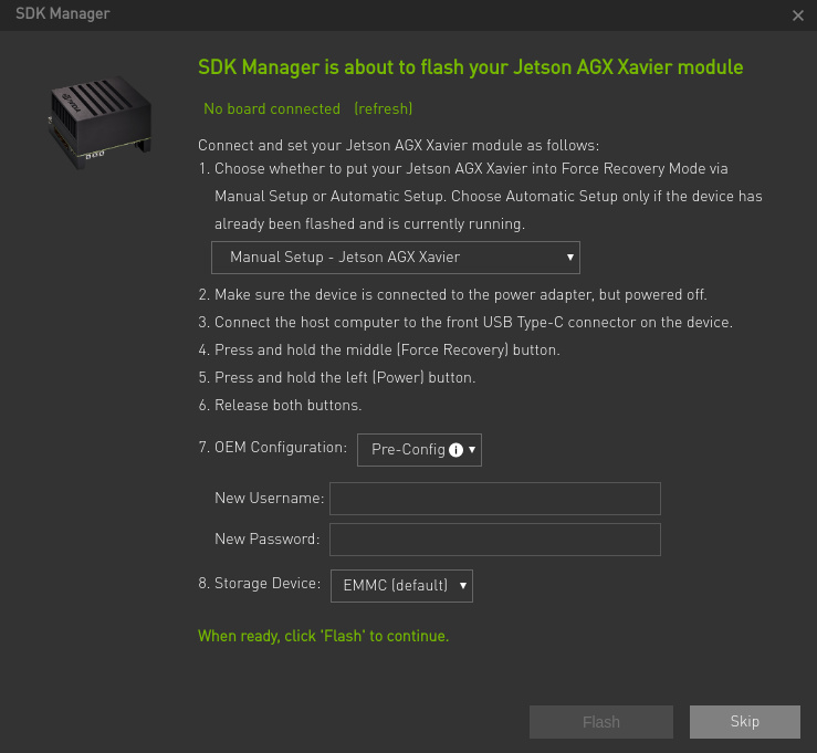

When upgrading the Xavier NX model to the latest NVIDIA® JetPack v5.0.2/L4T v35.1 or later, do not select the M.2 SDD NVMe as storage device. Otherwise, the installation will fail. If you want to use the SSD storage of the ZED Box. We provide a script that moves everything to the NVMe after the installation.
When the SDK Manager shows the following window, please select EMMC in the combo box 8. Storage Device, and click the Flash button to start the process:
When the flash process is completed, SDK manager asks for the IP address of the ZED Box to install the JetPack.
Do not continue the installation. Keep the SDK Manager open. Keep the OTG USB cable plugged in.

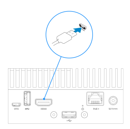

  • connect a micro USB cable to the host PC performing the upgrade/reset.
  • connect the cable to the micro USB port of the device labeled as OTG.
  • power on the device.
