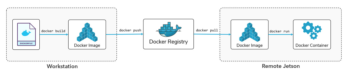

In the previous section, Linux-ZED SDK docker images along with OpenCV and ROS support were discussed. Here, we learn to run and build ZED-SDK with OpenCV and ROS docker images for NVIDIA® Jetson™.
Creating the image and using OpenCV or ROS in Docker is very much similar to that discussed earlier. The difference here would be that the Docker images are created for NVIDIA® Jetson™ platforms and hence the parent image also changes to the one that is built for the same platform.
Running OpenCV and ROS sample applications will be entirely the same as running them on desktop-based images hence this tutorial only discusses creating Docker images using Dockerfile and build scripts

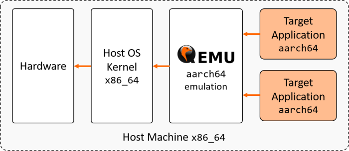

Before you go ahead and try creating the Docker images we suggest you go through an earlier tutorial that explains Running and Building ARM Docker Containers on x86.
