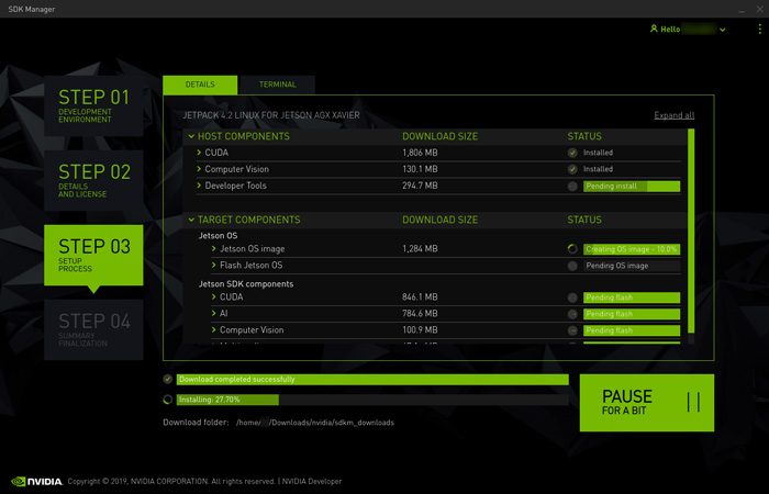

NVIDIA® Jetson™ boards need to be flashed first with JetPack (their operating system). We recommend using the NVIDIA® SDK Manager to flash your NVIDIA® Jetson™ with the latest OS image and developer tools.
Go to the JetPack section of NVIDIA’s website, and click on Download SDK Manager. More installation instructions are available on Install Jetson™ Software with SDK Manager.
