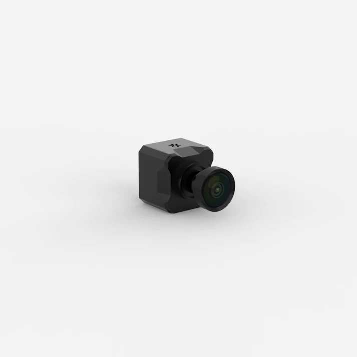

The ZED X One cameras are a professional-grade camera designed specifically for robotic applications in production environments. Multiple options are available to better fit the usage, such as Global or Rolling Shutter, 4K HDR with unparalleled low light capabilities, wide or narrow field of view lens options. Its high-performance IMU unlocks positional tracking capabilities as well.
Additionally, its secure GMSL2 connection allows for low-latency video transmission without EMI interference, making it ideal to integrate into robotics platforms.
How to use ZED X One #
Monocular Camera #
The ZED X One can be used as a standalone monocular camera.
You can use it to capture high-resolution images, video, and sensor data. The ZED X One is accessible through the ZED SDK using the sl:CameraOne object.

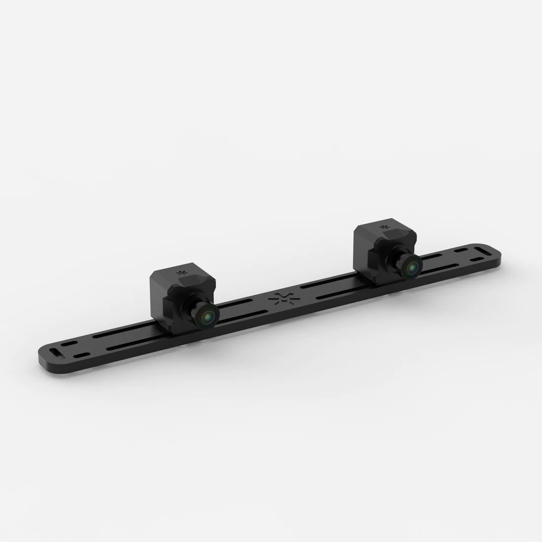

Stereo Camera #
The ZED X One can be used in a stereo camera system with a modular baseline. This mode requires to put 2 ZED X Ones side by side at a fixed distance, rigidly mounted. The distance between the cameras will impact the 3D depth range.
Cameras with a small baseline will be able to see accurately very close, while cameras with a larger baseline will have a longer range but the minimum working distance will increase. The lens option will also impact the effective depth range. More information on setting up a stereo rig can be found here.
In a stereo camera configuration, the system will require a calibration procedure once the system is mechanically set up. The calibration will compute the relative position between the 2 ZED X Ones to be later used for depth computation. More information on this step here.
Once the system is calibrated, the ZED X Ones can be used as a standard input in the ZED SDK, and all its features will be available seamlessly.
