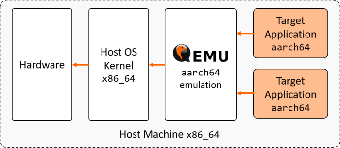

Setting Up ARM Emulation on x86
We’ll be using QEMU and Docker to set up our emulated environment. QEMU is an open-source machine emulator and virtualizer. It allows users to build ARM CUDA binaries on their x86 machine without needing a cross-compiler.
First, let’s see what happens, before setting up the emulation, when we try to execute a program compiled for a different architecture:
$uname -m # Display the host architecture
$#x86_64
$docker run --platform=linux/arm64/v8 --rm -t arm64v8/ubuntu uname -m # Run an executable made for aarch64 on x86_64
$# exec /usr/bin/uname: exec format error
As expected, the instructions are not recognized since the packages are not installed yet. Installing the following packages should enable support for aarch64 containers on your x86 workstation:
$sudo apt-get install qemu binfmt-support qemu-user-static # Install the qemu packages
$docker run --rm --privileged multiarch/qemu-user-static --reset -p yes # This step will execute the registering scripts
$docker run --platform=linux/arm64/v8 --rm -t arm64v8/ubuntu uname -m # Testing the emulation environment
$#aarch64
The installation was successful and the emulation is working. At this point, we can run aarch64 programs on the host x86_64 workstation. However, it is not yet possible to build and run CUDA-accelerated applications with QEMU. To add this feature, we will need to use a Linux for Tegra (L4T) base image from NVIDIA® DockerHub (see next section for additional details).
For advanced details on using QEMU and Docker, please refer to this repository on GitHub.

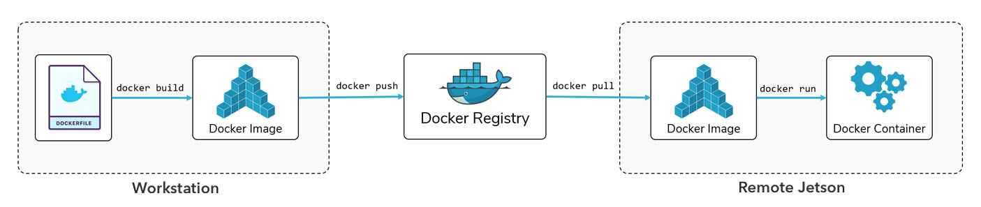

Deploying your Image to NVIDIA® Jetson
We recommend the above workflow for building and deploying your applications with Docker on NVIDIA® Jetson™. In this workflow, your source code and Dockerfiles are present on your local device (host machine). The image is built from the Dockerfile on the host and pushed to a Docker registry that makes it accessible from a remote device (target machine). On the target machine, the Docker image is pulled from the registry and run in a Docker container.
Build a Docker Image on the Host
To build a Docker image on the host machine you will need to:
  • Write a Dockerfile for your application (see Creating your Image section).
  • Run the docker build command.
Run a Docker Image on the Target
Pull your image from DockerHub on the target machine, and use the following command to run it in a Docker container:
$docker pull {user}/{custom_image}:{custom_tag}
$docker run --privileged --runtime nvidia --rm {user}/{custom_image}:{custom_tag}
If the image has not been pulled previously, docker run will pull it from the registry.
