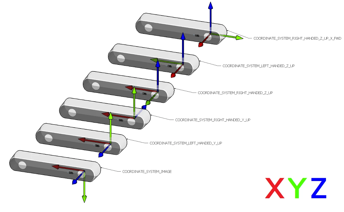

| enum | SL_COORDINATE_SYSTEM |
| Lists available coordinates systems for positional tracking and 3D measures. More... | |

| enum SL_COORDINATE_SYSTEM |
| Enumerator | |
| SL_COORDINATE_SYSTEM_IMAGE | Standard coordinates system in computer vision. |
| SL_COORDINATE_SYSTEM_LEFT_HANDED_Y_UP | Left-handed with Y up and Z forward. |
| SL_COORDINATE_SYSTEM_RIGHT_HANDED_Y_UP | Right-handed with Y pointing up and Z backward. |
| SL_COORDINATE_SYSTEM_RIGHT_HANDED_Z_UP | Right-handed with Z pointing up and Y forward. |
| SL_COORDINATE_SYSTEM_LEFT_HANDED_Z_UP | Left-handed with Z axis pointing up and X forward. |
| SL_COORDINATE_SYSTEM_RIGHT_HANDED_Z_UP_X_FWD | Right-handed with Z pointing up and X forward. |
