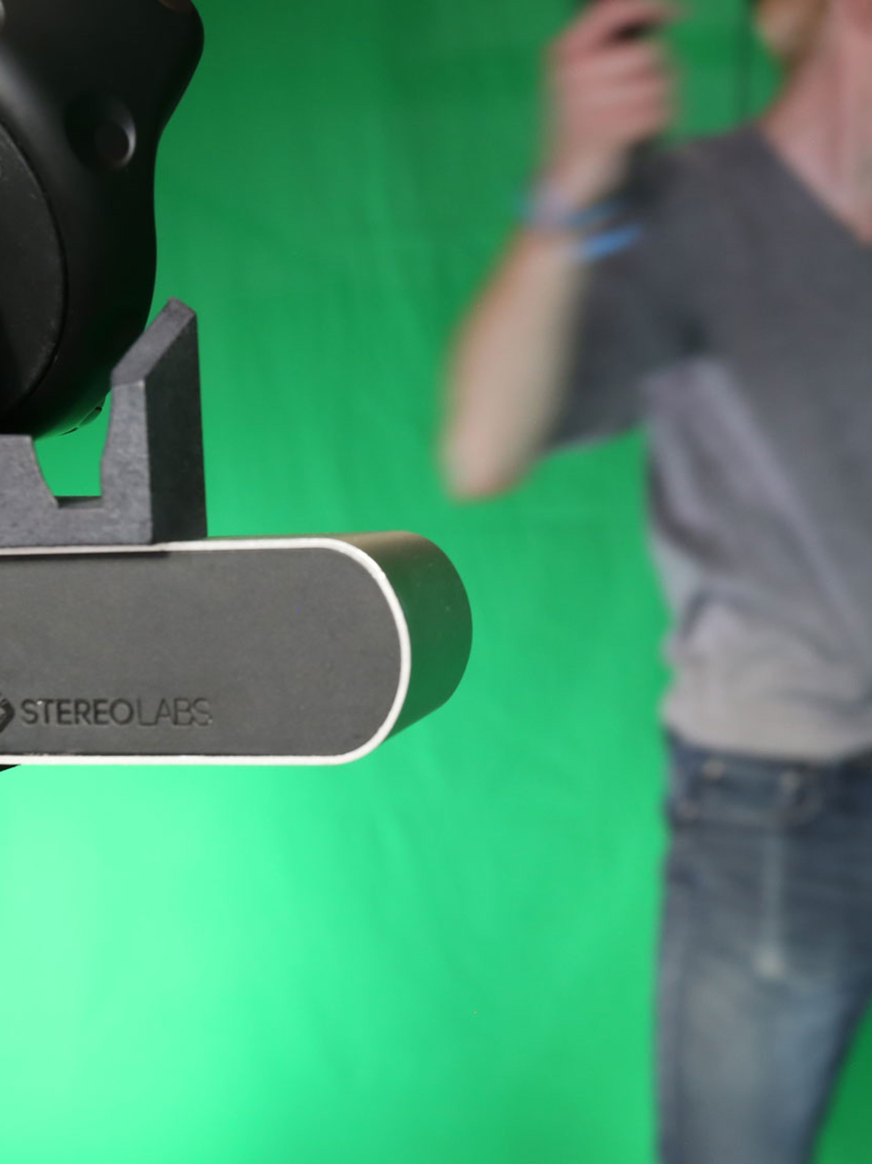

      Vive Tracker or Extra Controller
      Because Rift and Vive tracked objects are continuously tracked from fixed points in your room, attaching such a device to your ZED is the best way to make sure your camera’s position and rotation are perfectly aligned. You can launch a scene without worrying about its starting point. And as the Rift’s Sensors or Vive’s Lighthouses provide known, fixed points of reference, the tracking is less error prone than any inside-out solution (including the ZED’s) which are designed to function when such references aren’t available.
      You can use an Oculus Touch Controller, a Vive Controller, or a Vive Tracker. Whichever you pick, you’ll have to physically attach it to your ZED. There are many ways to do that. If you have access to a 3D printer, you can download our mounting brace template (.step, .stl) and print it out. The same mount will fit a Vive Tracker, a Vive controller or an Oculus Touch.
      If you don’t have access to a 3D printer, feel free to improvise with clamps, tape, etc. But you must ensure two things: First, that your attachment mechanism doesn’t occlude too many of the device’s sensors (hidden in Touch controllers, but indicated with divots in Vive Controllers and Trackers). Second, your attachment must be firm (no wobbling) or else you will have to recalibrate constantly.
      Note: Our printable mounting brace does not fit the new ZED mini.
      Note: If you’re not sure where on the ZED you should mount your controller or Tracker for the best results, know that it’s not especially significant as the calibration accounts for the offset. Mount it where you can best keep it steady. However, mounting it directly to or closer to the ZED will minimize the effect of any wobbling that does occur.
