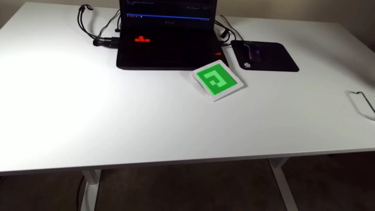

It’s best to print out markers onto non-glossy paper. From there, you can cut them out, leaving white borders around the image. These borders will prevent the marker’s edges from blending in with dark objects. Optionally, you can also tape/glue the markers to something rigid, like cardboard, to hold the paper flat.
If you don’t have access to a printer, you can display the markers on a screen like a cell phone. If you do, make sure the brightness is turned up all the way and avoid resizing the image during development.

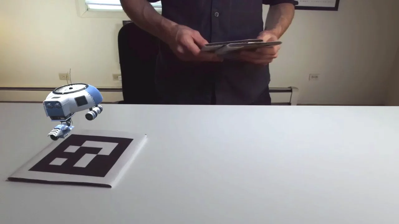

Run the Scene
With your ZED plugged in, start the scene and point your camera at your ArUco marker. The drone will appear over the marker whenever it’s visible.

  • If you want to spawn multiple objects, like in the Simple Marker Placement and ArUco Drone Wars samples, you’ll need to print out more markers of different indexes – 0-4 for example. We include the first five markers of the 4×4 dictionary as .png images in the package, and you can find the rest here.
  • It’s possible to use multiple copies of the same marker to spawn copies of the same object. Use the MarkerObject_CreateObjectsAtMarkers for this. However, note that this is not as robust as using multiple markers, as it has to estimate which marker object corresponds to which from frame to frame.
