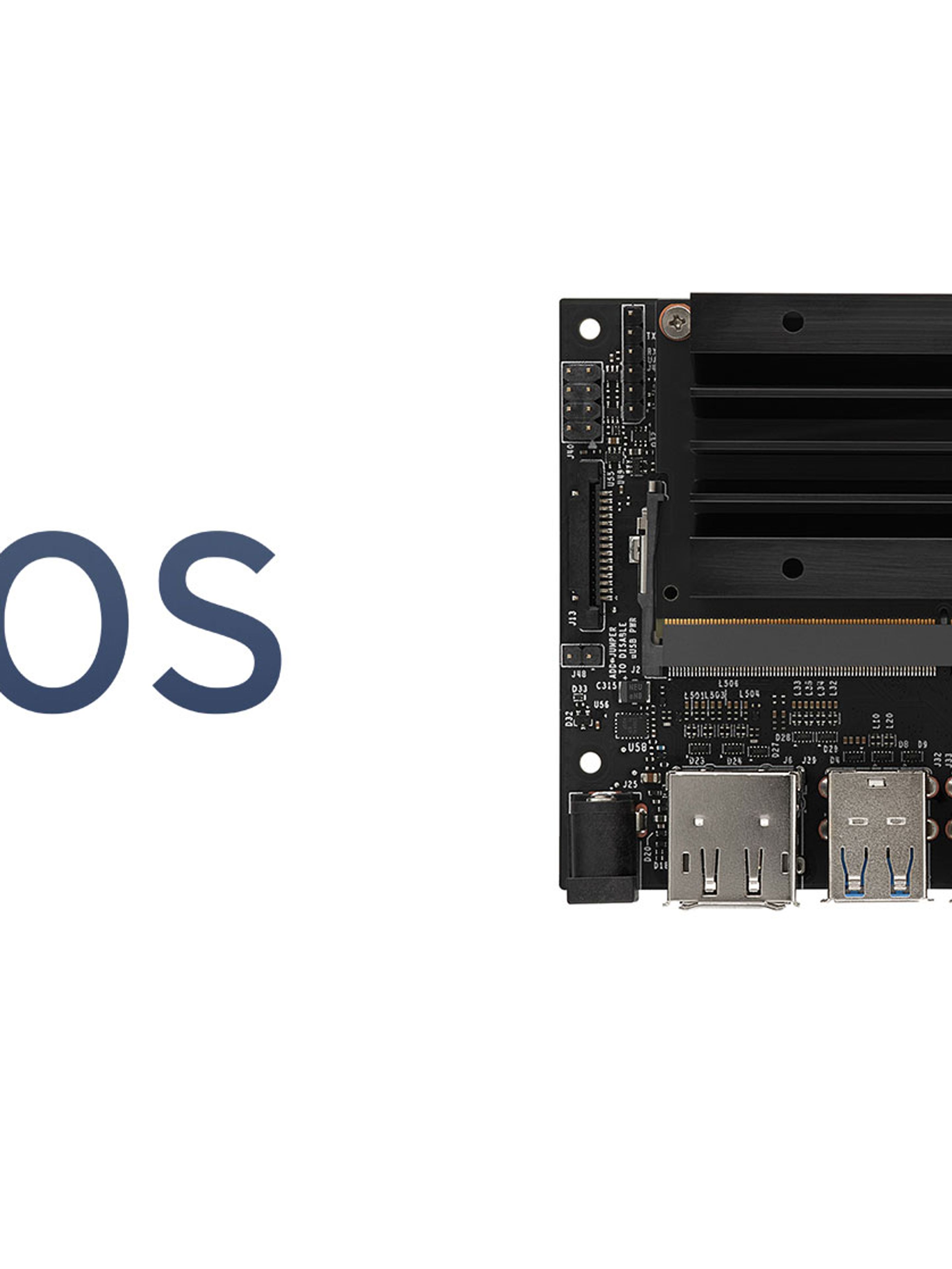

Getting Started with ROS on Jetson Nano
The new embedded board from NVIDIA® is an ideal fit for autonomous robotics. Learn how to get started with ROS on the new Jetson™ Nano.
The Jetson Nano is the latest embedded board of the NVIDIA Jetson family. Designed for autonomous machines, it is a tiny, low power and affordable platform with a high level of computing power allowing to perform real time computer vision and mobile-level deep learning operations at the edge.
ROS is the natural choice when building a multi-sensory autonomous robot.
After setting up the Jetson Nano with its JetPack image using our Getting Started guide, we are going to install the latest version of ROS that runs on Ubuntu 18 Bionic Beaver: Melodic Morenia.
