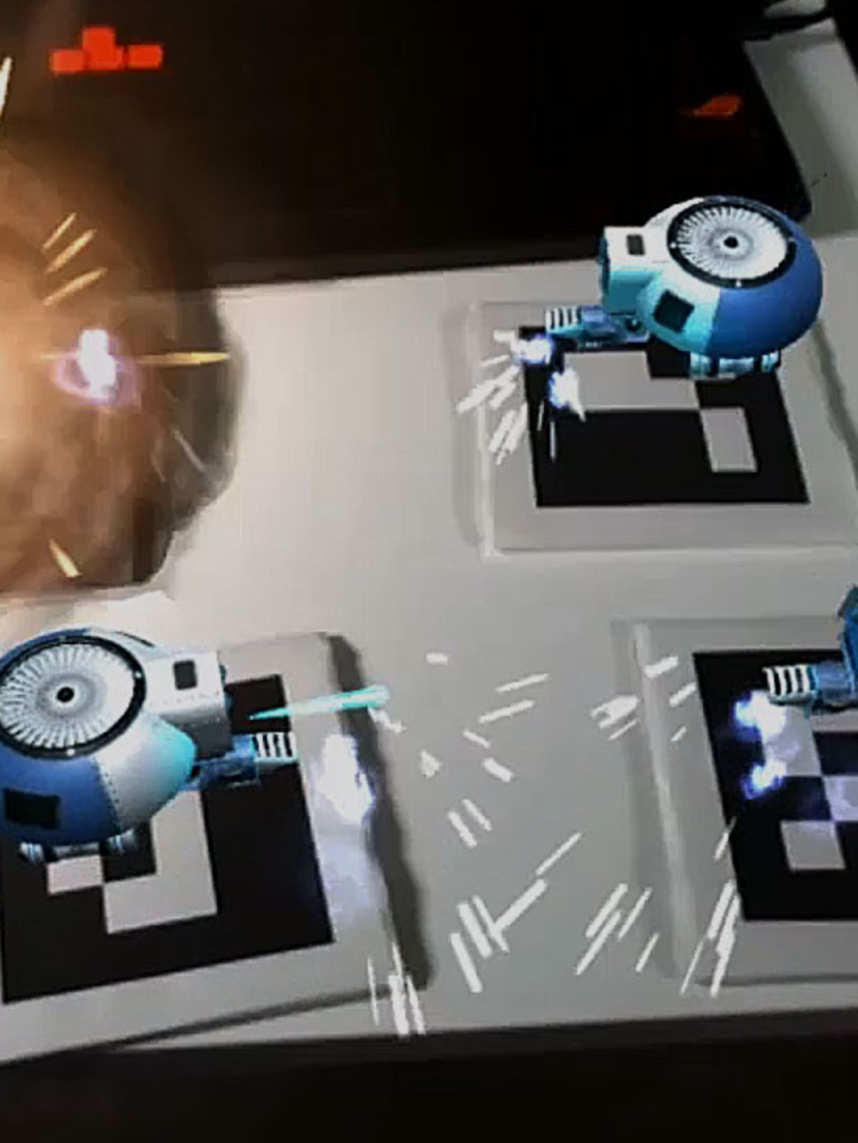

With your ZED plugged in, start the scene and point your camera at your ArUco marker. The drone will appear over the marker whenever it’s visible.

  • Each marker it finds has an ID that represents the marker’s index in the pre-defined dictionary we chose. For all IDs with a MarkerObject script in the scene, ZEDArUcoDetectionManager calculates the 3D position and rotation of the marker, and uses them to call each MarkerObject‘s MarkerDetected method so it can reposition itself.
  • For all MarkerObjects where its ID wasn’t detected, we call its MarkerNotDetected method, so it can turn itself off.
