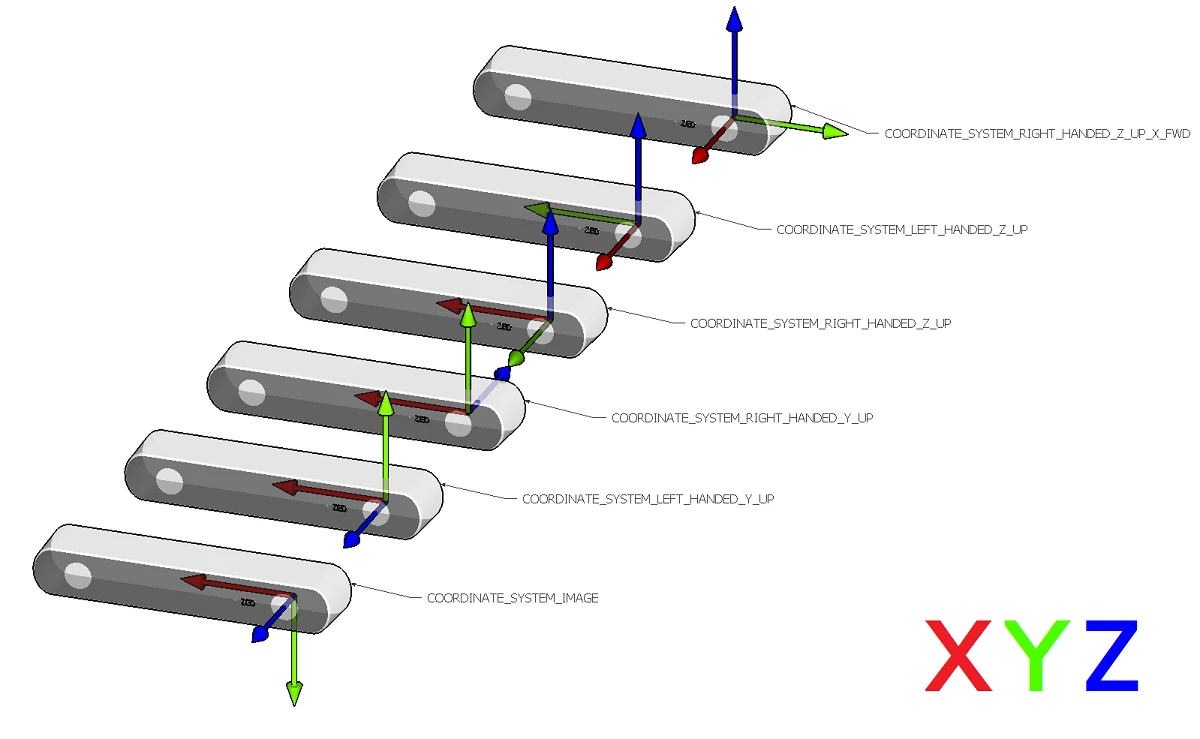

strong |
Lists available coordinates systems for positional tracking and 3D measures.
| Enumerator | |
| IMAGE | Standard coordinates system in computer vision. |
| LEFT_HANDED_Y_UP | Left-handed with Y up and Z forward. |
| RIGHT_HANDED_Y_UP | Right-handed with Y pointing up and Z backward. |
| RIGHT_HANDED_Z_UP | Right-handed with Z pointing up and Y forward. |
| LEFT_HANDED_Z_UP | Left-handed with Z axis pointing up and X forward |
| RIGHT_HANDED_Z_UP_X_FWD | Right-handed with Z pointing up and X forward. |
