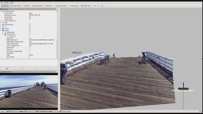

You can now visualize the video and depth data that your ZED camera captures using this simple command:
$ roslaunch zed_display_rviz display_zedm.launch # if using ZED Mini
$ roslaunch zed_display_rviz display_zed2.launch # if using ZED 2
