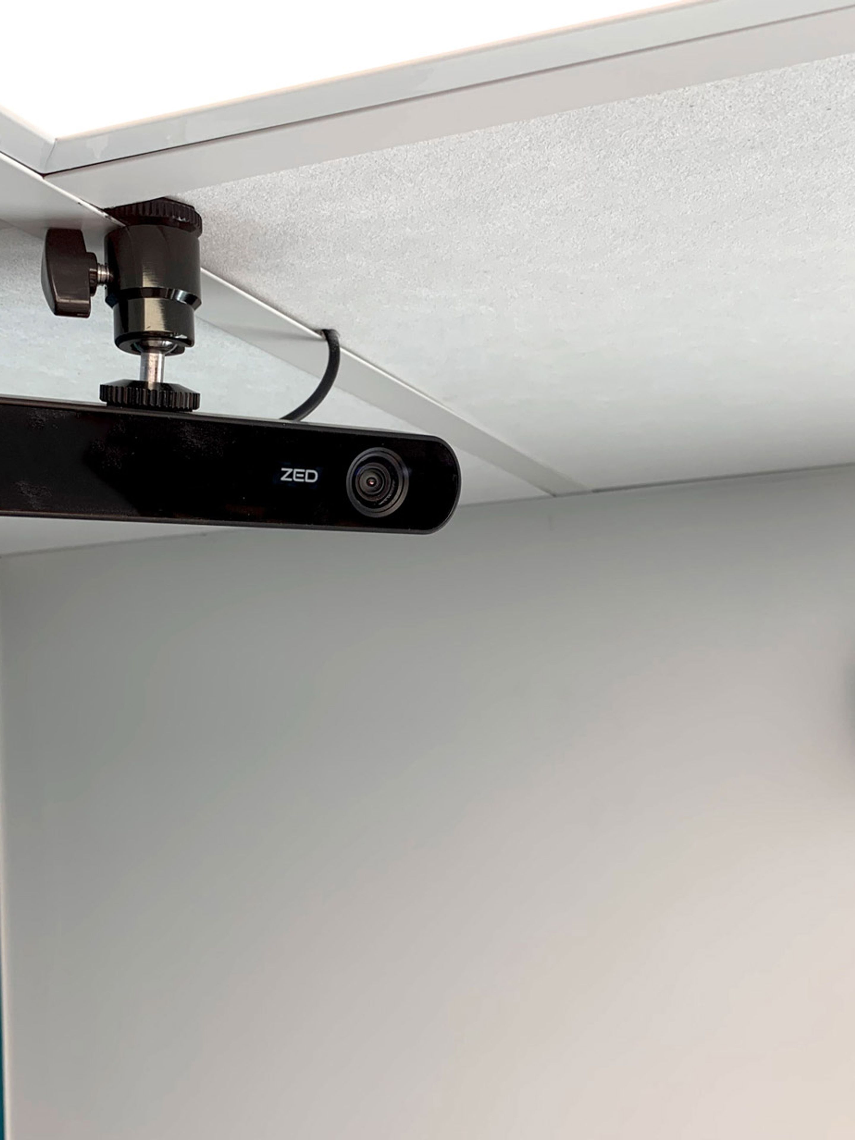

ZED 2 displays visual alerts when people are too close.
We use a ZED 2 wide-angle stereo camera that we connect to a Jetson Nano AI gateway. Processing is done in real-time at the edge, ensuring low latency alerts and data privacy. We add an Amazon Echo Dot speaker to serve as alarm.
