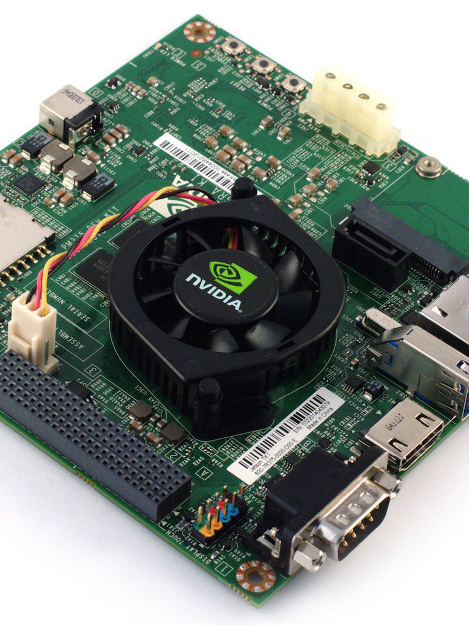

      In this tutorial, you will learn how to set up NVIDIA Jetson TK1 to use the ZED stereo camera. For additional information, you can also check NVIDIA Developer documentation here.
      To set up the Jetson TK1, you will need a micro-USB cable connected to a host computer running Ubuntu. Ubuntu 12.04 or 14.04 64 bits are recommended. If you are on Windows, you can use VirtualBox to run Linux in a virtual machine.

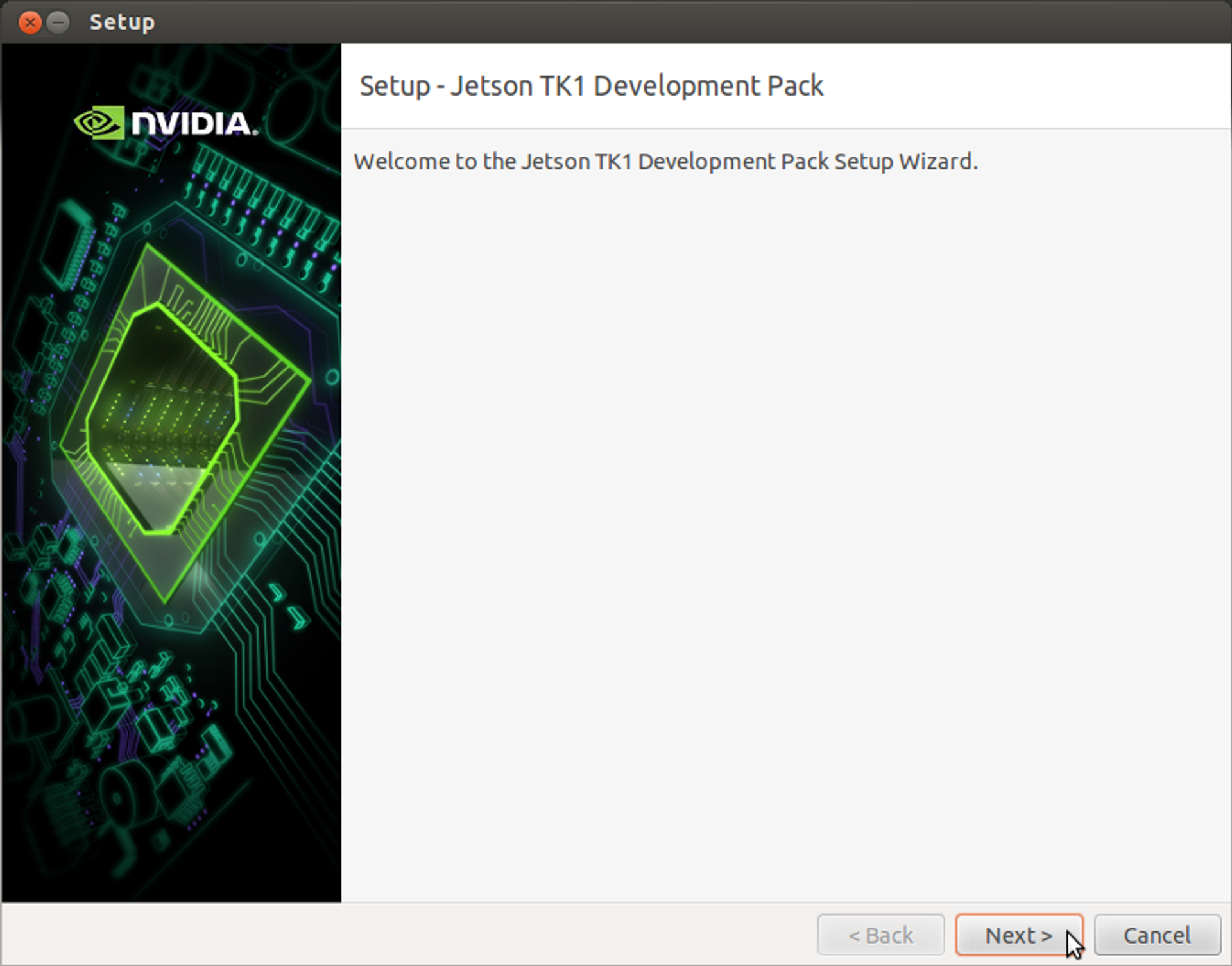

      1. Download the latest version of the JetPack TK1 here. At the time of writing, the latest release is 1.2 with Linux for Tegra r21.4. For more information, feel free to check the official documentation here.
      2. Make sure the run file has the exec permission and launch the graphical installer, in a terminal:
      chmod +x JetPackTK1-*.run
      ./JetPackTK1-*.run
      3. After you accept the license agreement, select the target folder where JetPack will be installed and a “Complete” installation type. Configure your proxy if necessary. The installer might ask the administrator password to install the necessary packages on the host machine.

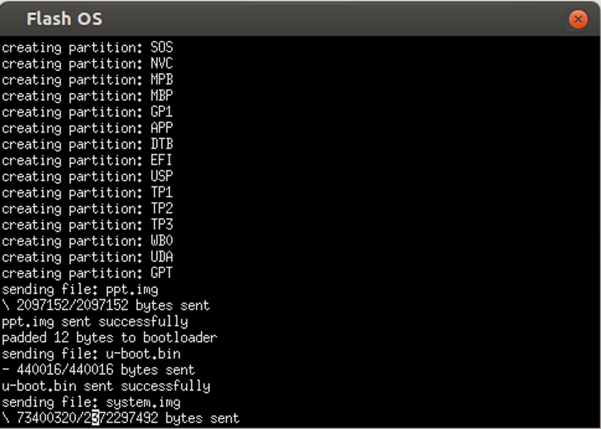

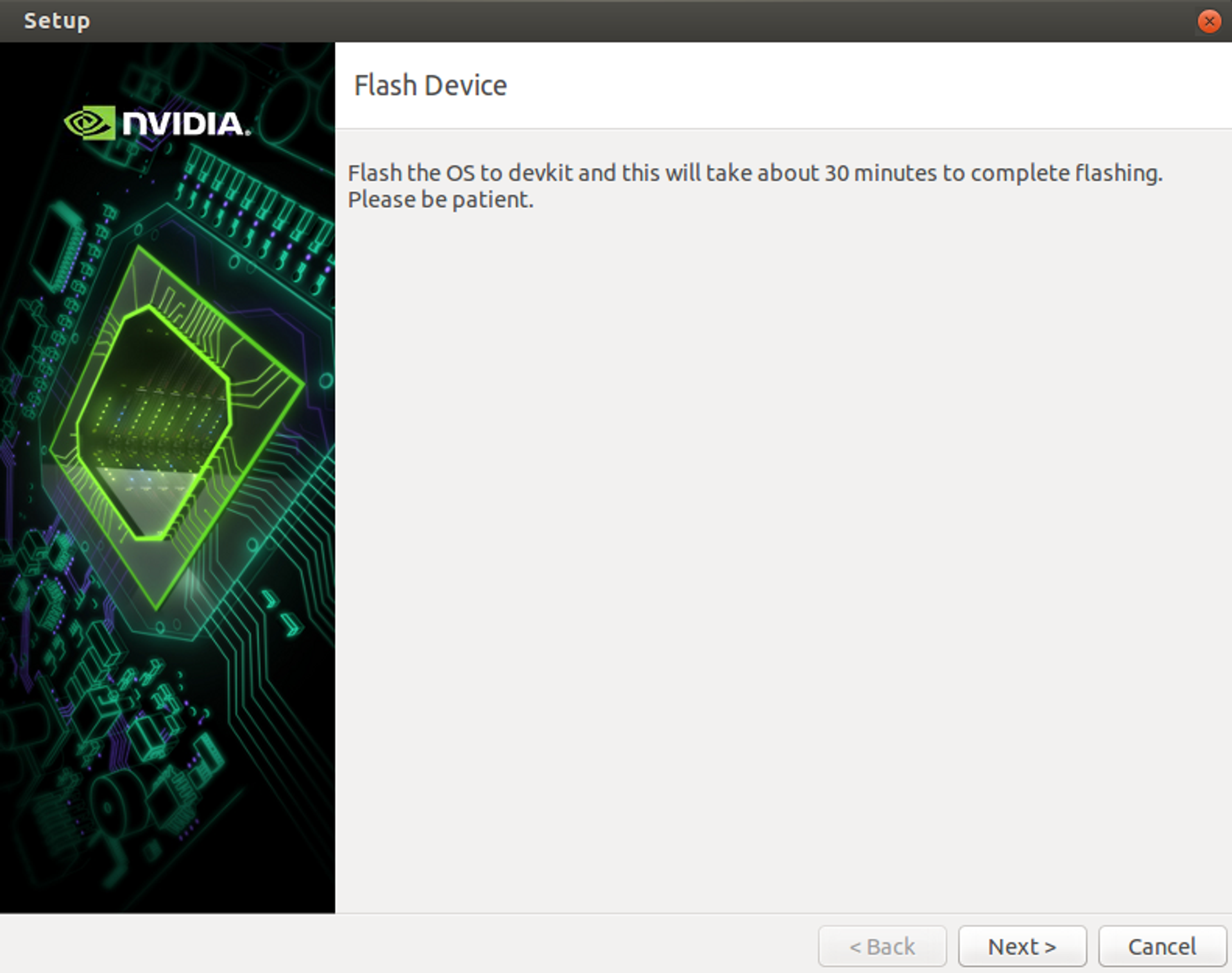

      1. After JetPack TK1 setup is complete, you will need to flash the OS to your devkit.
      2. You will see instructions in a pop-up window to put your device into “recovery mode”. Follow the instructions. The installer will begin flashing your device.
      If an error occurs, simply click “Back” then “Next” and put the Jetson in recovery mode to try flashing the Jetson again.

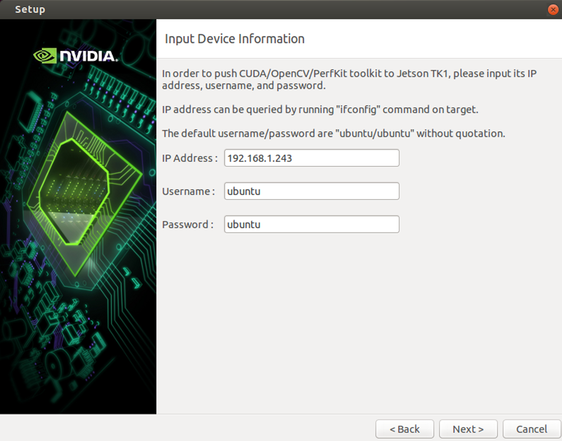

      3. After flashing the device, a dialog screen will appear that requests the device information.

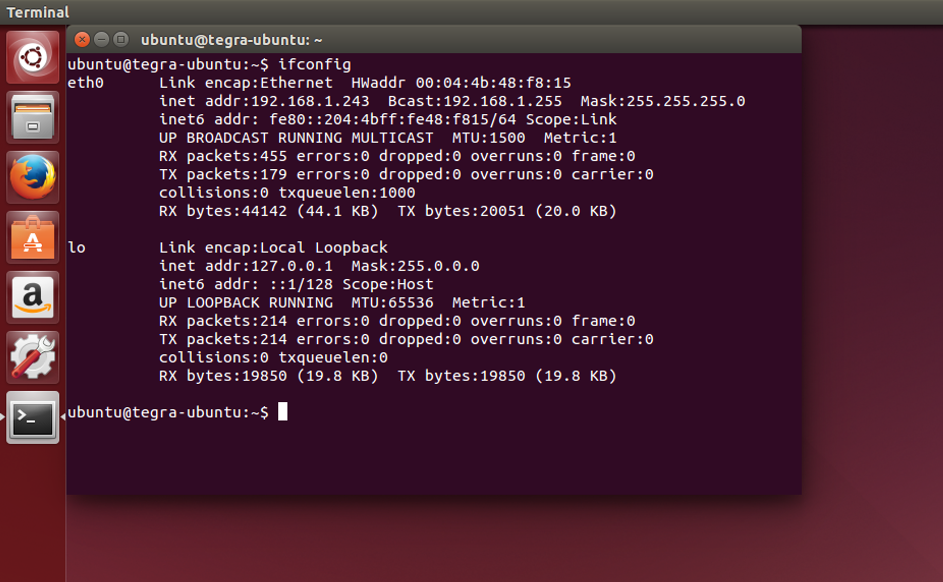

      To get the IP address, you will need to connect the Jetson on the same network as the host computer (with an ethernet cable) and then log into the Jetson. Username/password is ‘ubuntu’. Then in a terminal type this command to get the IP address:
      ifconfig
      For example:

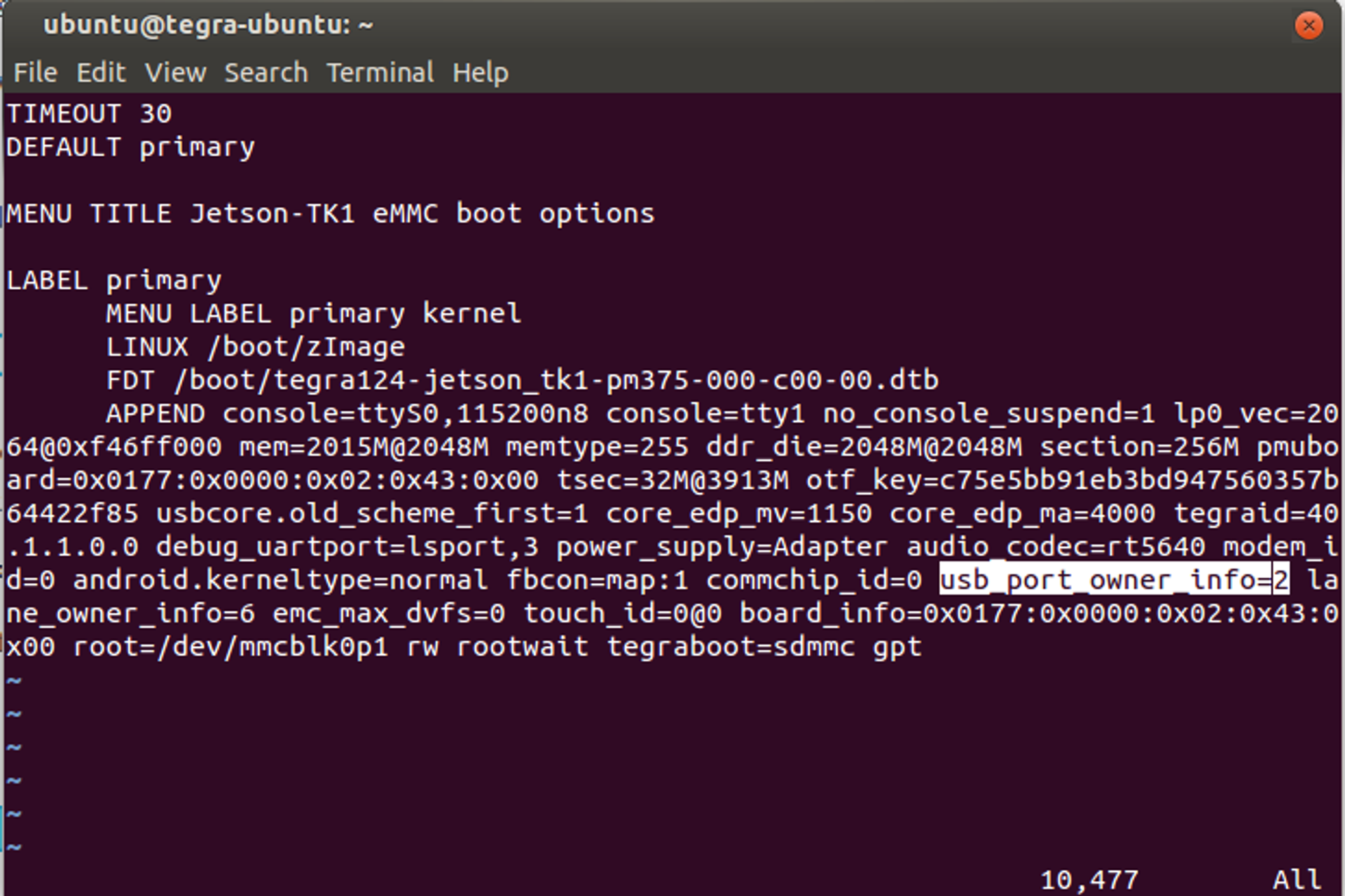

      Enabling USB 3.0 on the Jetson TK1
      By default the USB 3.0 port is recognized as USB 2.0. You will need to configure it as USB 3.0. To do this, open the file /boot/extlinux/extlinux.conf as root in a terminal:
      sudo vi /boot/extlinux/extlinux.conf
      And look for usb_port_owner_info=0. If there is two occurrences, modify the last one. Replace ‘usb_port_owner_info=0‘ by ‘usb_port_owner_info=2‘.
      Save and Exit (with vi: press Escape then ‘:‘,’w‘ and ‘q‘ and press ‘Enter‘) and reboot.
