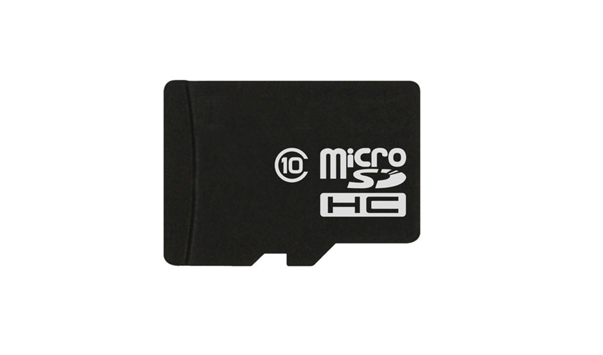

    Preparing the SD Card
    Unlike previous Jetson products, the Jetson Nano uses a removable microSD card as its boot device and storage. Therefore, the Nano is no longer limited to the 16GB/32Gb storage that the integrated eMMC of past models used.
    Since the OS will run on the microSD card, your choice of card is important. Choose a high-level class, such as Class 10, to have a decent writing/reading speed.
    Make sure the PC you are going to use can read and write to the microSD card.
    1. Plug the card into the SD card reader on your PC. The SD card should appear in your list of disks. If not, make sure the microSD card can be mounted.
    2. Download the SD card image file (nv-jetson-nano-sd-card-image-r32.3.1.zip) onto your host and unzip the file. Make sure you have enough empty space; the image size is ~6Gb.
    3. Format the microSD card to ExFAT if it’s a 64Gb or higher card, and to FAT if it’s less.
    4. Once formatted, detect the drive that has the microSD card. You can use GParted for this operation or type the following to list all the drives:
    $ sudo fdisk -l
    The SD card should be listed under /dev/sdc or /dev/sdd. It’s important to make sure that the drive you are targeting is the correct one, otherwise you may erase or write to another device. To make sure it’s the correct one, unplug the card and see if it disappears from the list.

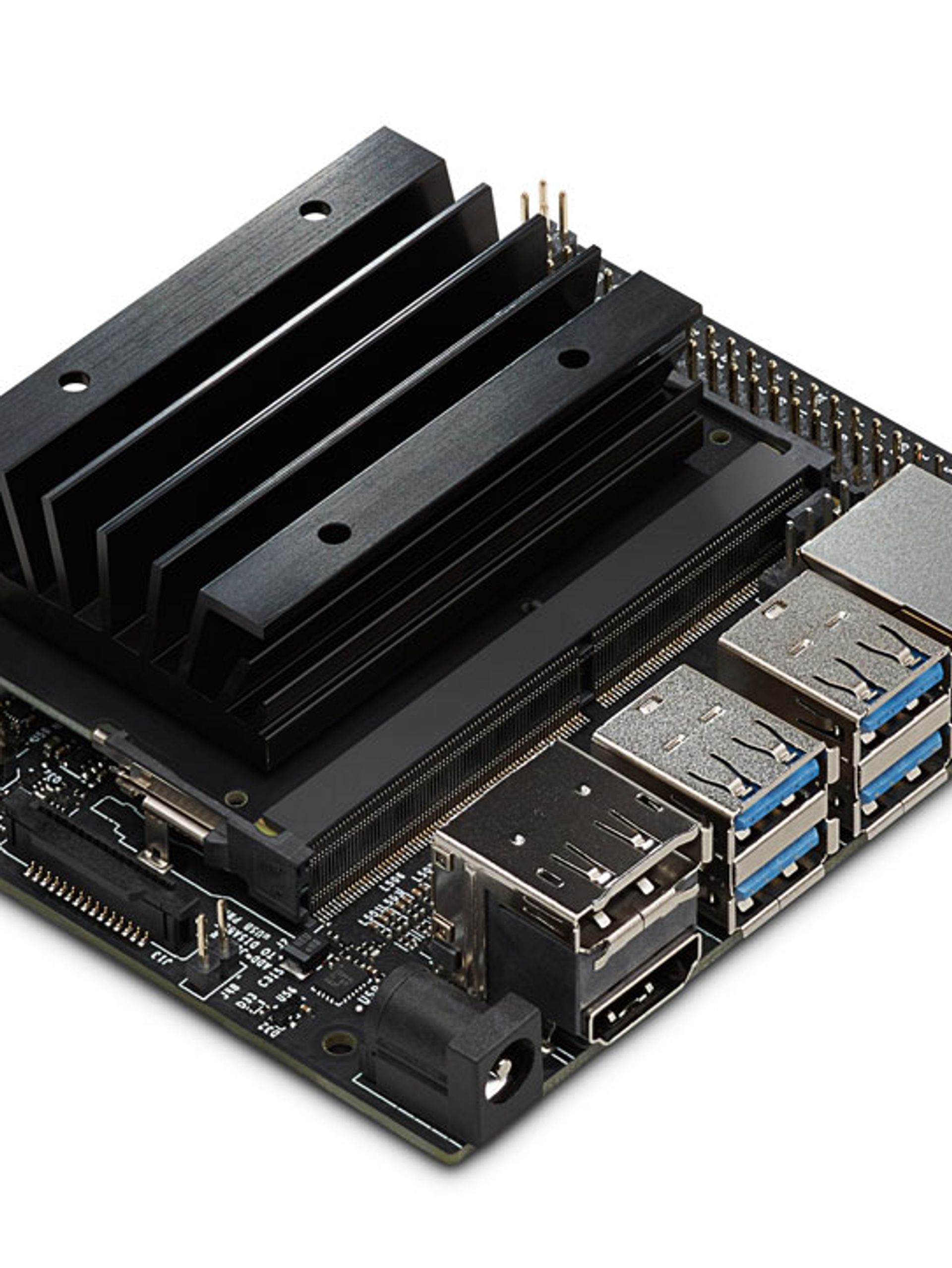

    Setting Up Hardware and Booting
    1. Insert the microSD card into the appropriate slot
    2. Connect the display and USB keyboard /mouse and Ethernet cable.
    3. Depending on the power supply you want to use, you may have to add or remove the jumper for power selection:
      – If using a jack, the jumper must be set.
      – if using USB, the jumper must be off.
    4. Plug in the power supply. The green LED (D53) close to the micro USB port should turn green, and the display should show the NVIDIA logo before booting begins.

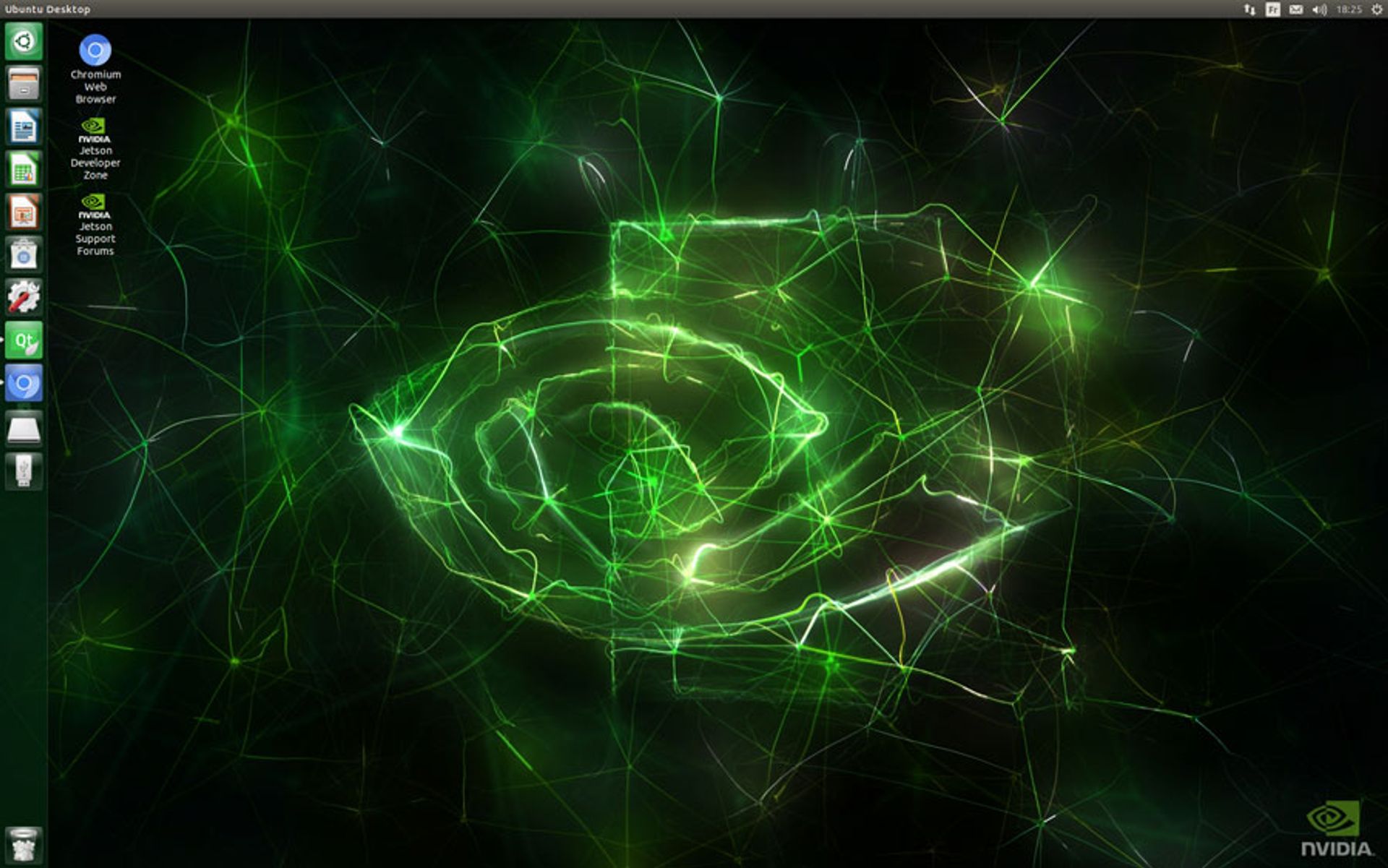

    Ubuntu Configuration
    After the Jetson Nano boots up for the first time, it will start system configuration as a common Ubuntu installation.
    1. Accept the EULA license
    2. Choose language, keyboard, time zone selection
    3. Choose a username/password
    After rebooting, you’ll see a typical Ubuntu desktop with the NVIDIA logo.

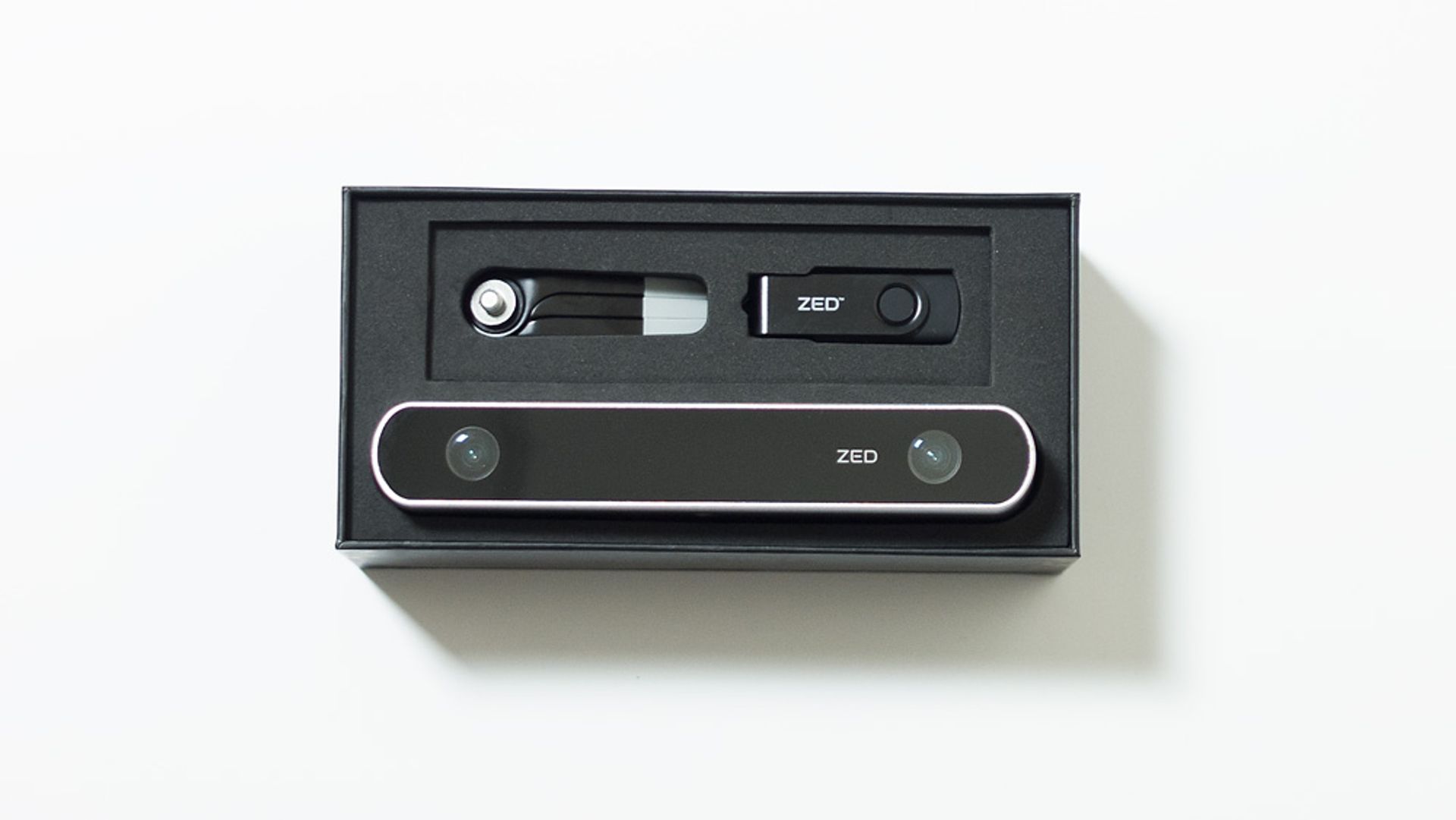

    Adding the ZED camera
    Your Jetson Nano will need an Internet connection to install the ZED SDK as it downloads a number of dependencies. You can use an Ethernet cable or attach a USB Wi-Fi adapter.
    Download the ZED SDK for Jetson Nano and install it by running this command and following the instructions that appear:
    $ chmod +x ZED_SDK* $ ./ZED_SDK_Tegra_JP43_v3.1.2.run
