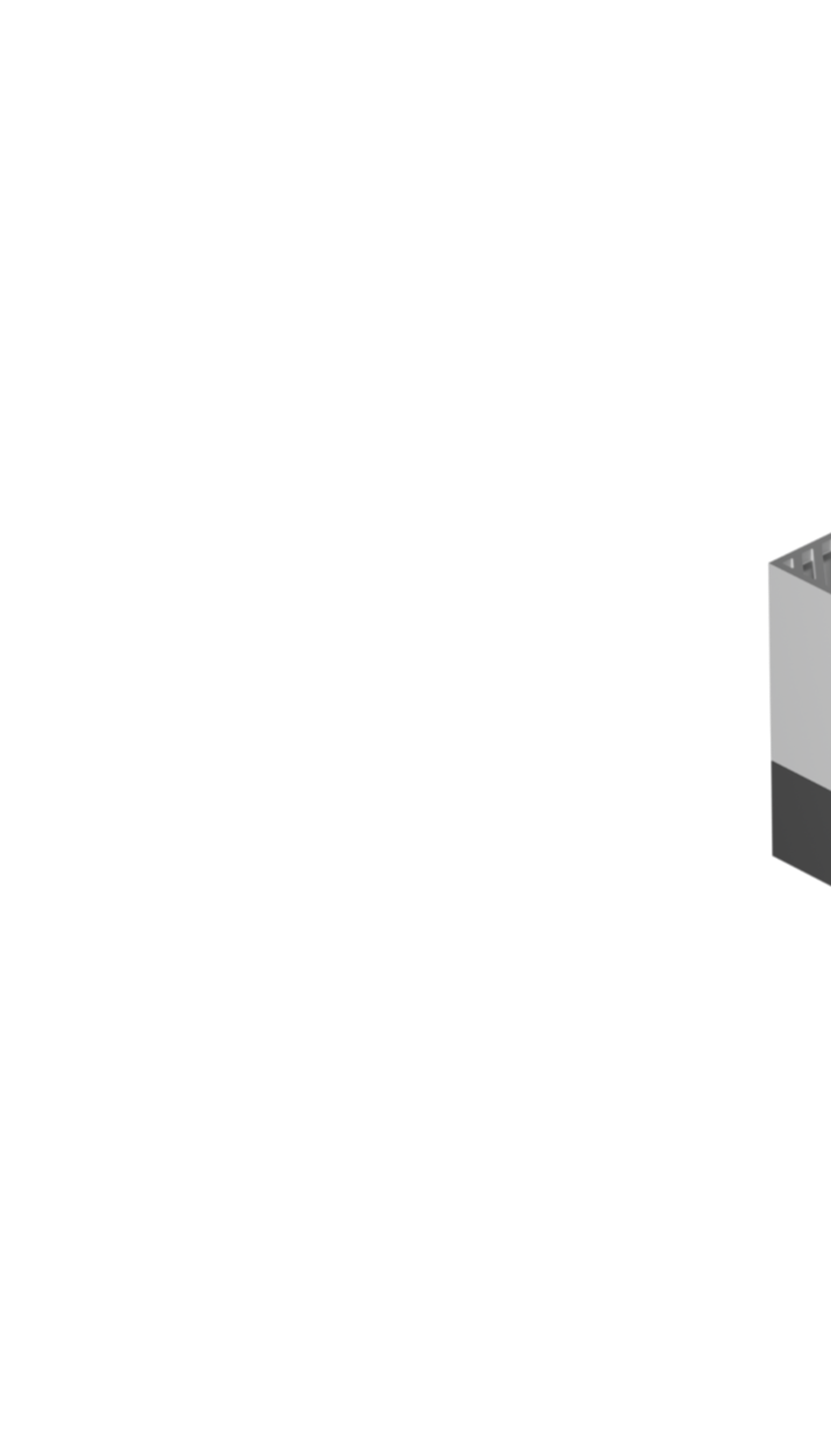

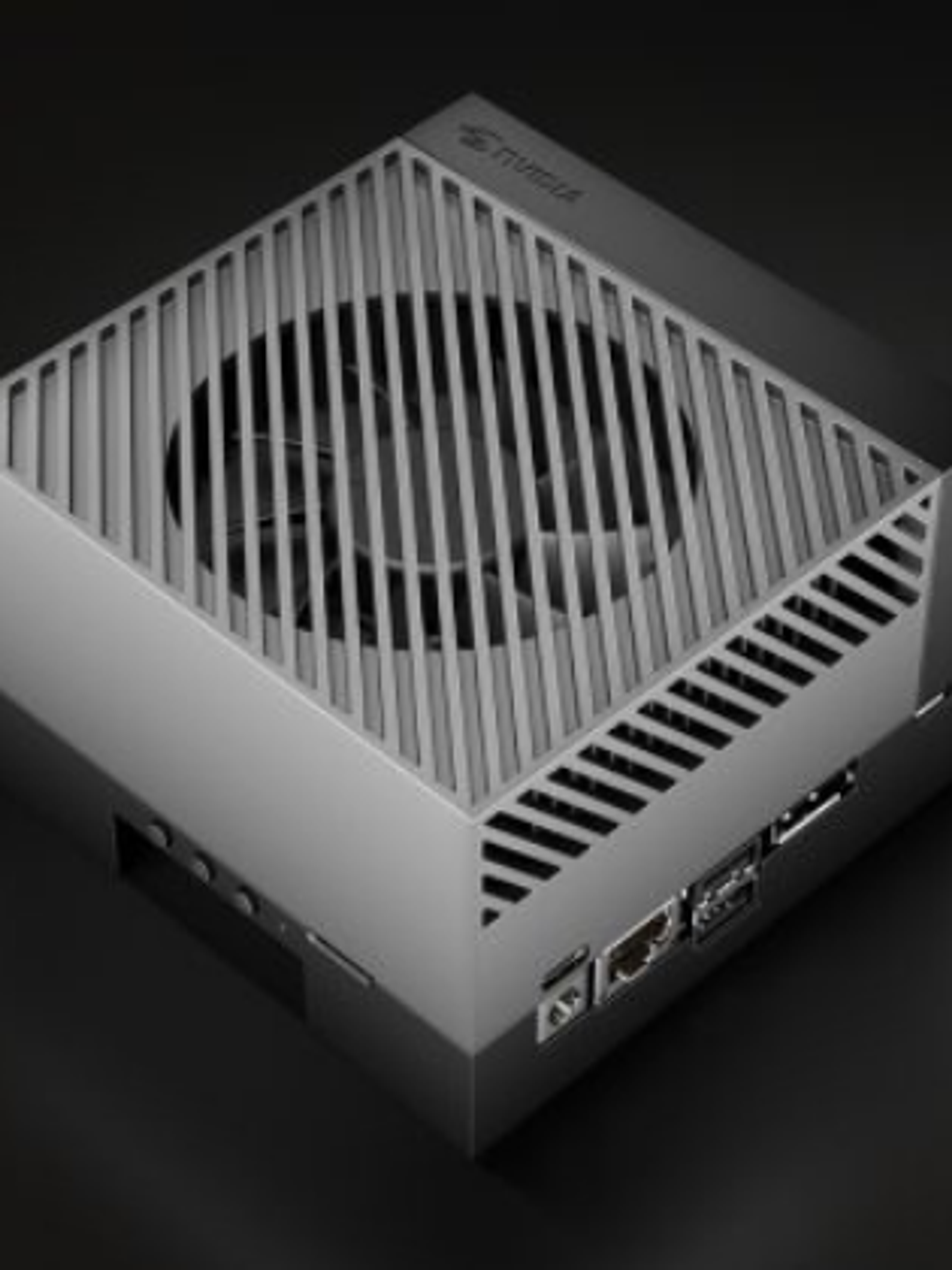

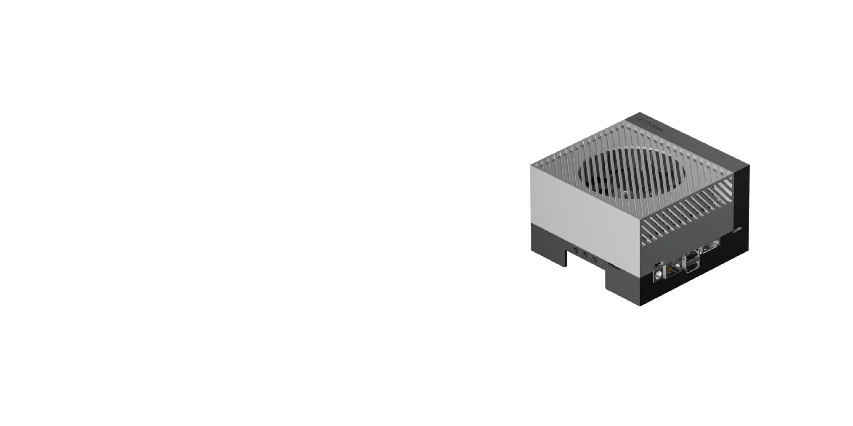

NVIDIA recently launched the most powerful embedded board currently available on the market: Jetson AGX Orin™. Learn how to set up the new Orin board and make it ready to be used with the latest ZED SDK to perceive the world in 3D with ZED cameras.
NVIDIA® Jetson AGX Orin™ Developer Kit enables the development of full-featured AI applications for products based on Jetson Orin modules. It includes a high-performance, power-efficient Jetson AGX Orin module, and can emulate the other Jetson Orin modules that will be launched on the market before the end of the year. It is now available for purchase on the Stereolabs store.
