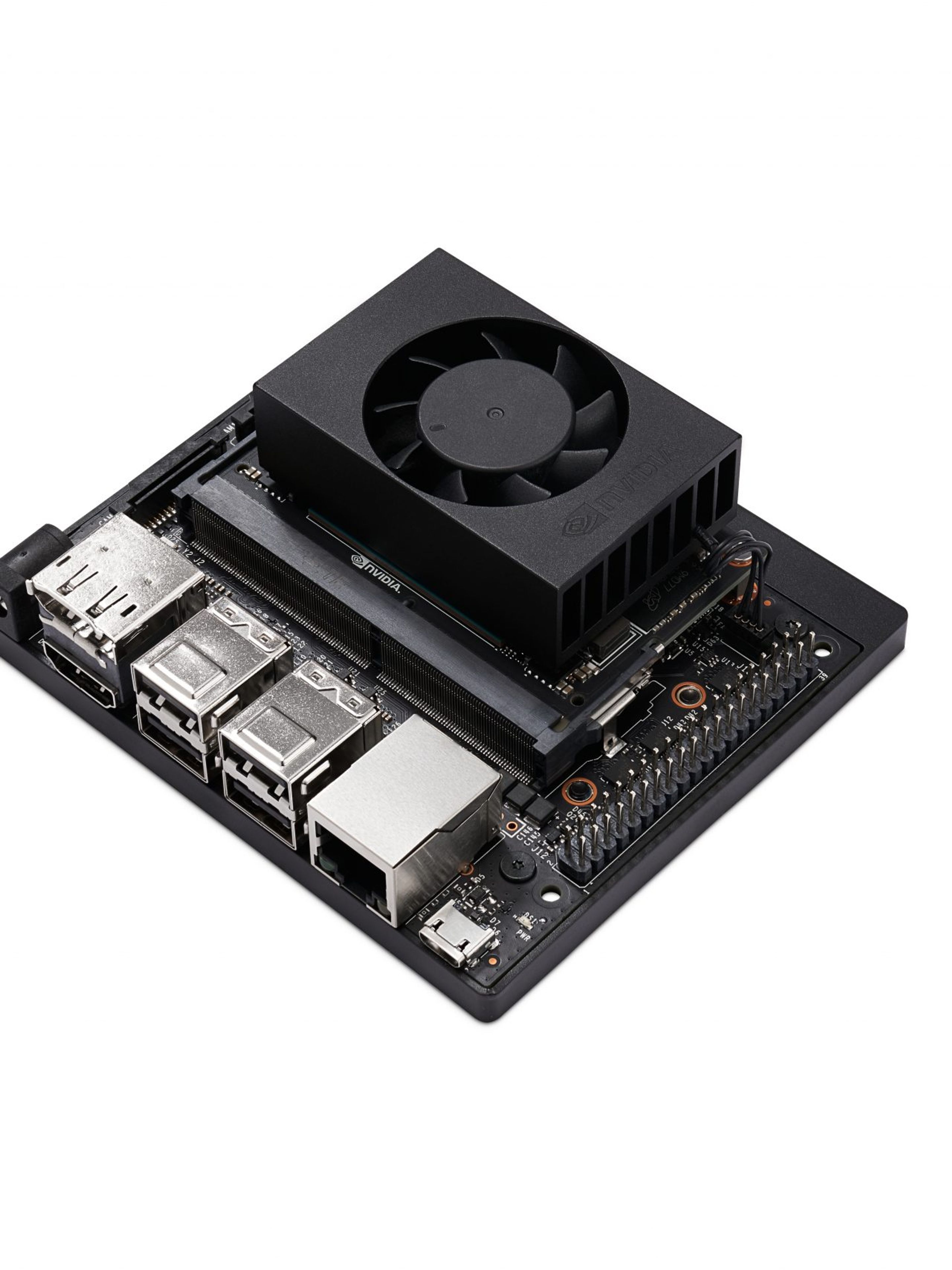

Getting Started with Jetson Xavier NX
Learn how to set up the new NVIDIA Jetson™ Xavier NX and install everything you need to use the full power of this tiny AI-ready embedded board.
