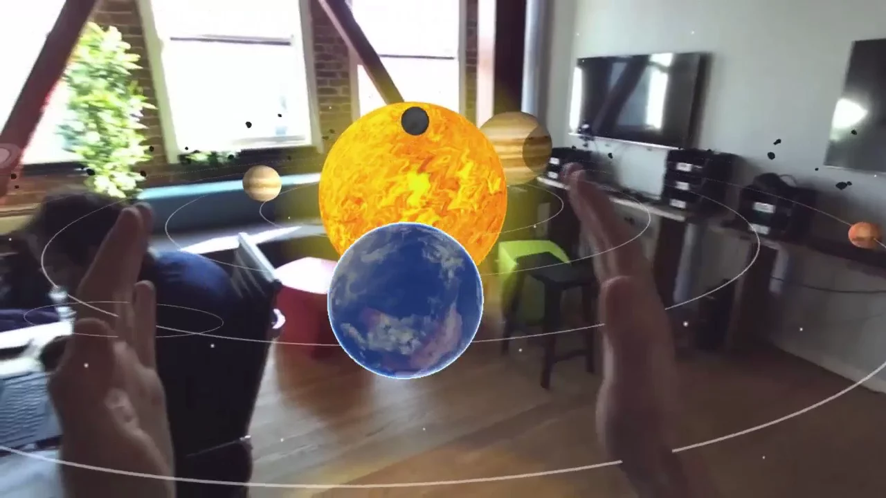

Run the scene and put on your headset. You’ll see your real-life room, but with planets floating around it. Bring your hands in front of you and you’ll see Leap Motion’s hand tracking in action, drawing wires along your hands.

Save, run the scene, and put on your headset. Reach out and poke a planet. Dribble it between your palms. Punch the sun to send it flying toward your buddy. Earth and the rest of the solar system is now in your hands!
Result
