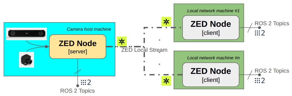

When transmitting data to different nodes across multiple machines in the same ROS 2 network, you can leverage the ZED SDK’s Local Streaming module to optimize bandwidth usage and data transfer throughput.
The Local Streaming module encodes ZED data into a single compressed stream for network transmission, replacing multiple ROS 2 topics with a single raw data stream. This approach is particularly beneficial when working with high-resolution video streams, point clouds, or bandwidth-constrained networks.
The receiving machine must have a compatible NVIDIA® GPU that supports hardware decoding. Both encoding and decoding are GPU-accelerated, significantly reducing CPU load and improving overall performance.
Architecture
This configuration requires a ZED Wrapper node to act as a Streaming Server and one or more ZED Wrapper nodes configured as Streaming Clients that connect to the server instead of directly to a physical ZED camera.
Client nodes operate as standard ZED Wrapper nodes with independent configurations. Instead of connecting to a physical camera, they connect to the server node’s network stream. Each client can independently enable or disable topics, activate features, and set parameters, regardless of the server node’s configuration or other client nodes.
Refer to the ZED Wrapper documentation for more information on configuring node parameters.
Independent client configuration
Each client node operates independently and can be configured to enable only the features and topics needed for its specific use case. This selective processing significantly reduces network bandwidth and computational load.
Example scenario: A remote monitoring station displays camera images and point clouds to an operator.
Client-side optimization:
  • The client generates rectified images and point clouds locally using the ZED SDK
  • Unnecessary features (Positional Tracking, Object Detection) can be disabled
  • Only the compressed stream is transmitted over the network
Server-side optimization:
  • Depth processing can be disabled if not required locally
  • Reduced CPU/GPU load on the server machine
  • Maximized data throughput for streaming
This architecture allows each node to optimize resource usage based on its specific requirements while maintaining full access to ZED SDK capabilities.
