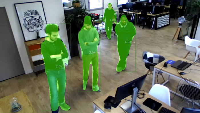

The ZED SDK can be interfaced with a PyTorch project to add 3D localization of objects detected with a custom neural network. In this tutorial, we will combine Mask R-CNN with the ZED SDK to detect, segment, classify and locate objects in 3D using a ZED stereo camera and PyTorch.

Run the code with python3. You should be detecting objects captured by your ZED camera using the Mask R-CNN ResNet 50 model and localizing them in 3D.
