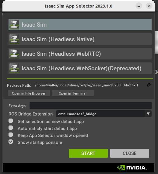

First of all, remember to select the correct ROS Bridge Extension when starting Isaac Sim: omni.isaac.ros2_bridge

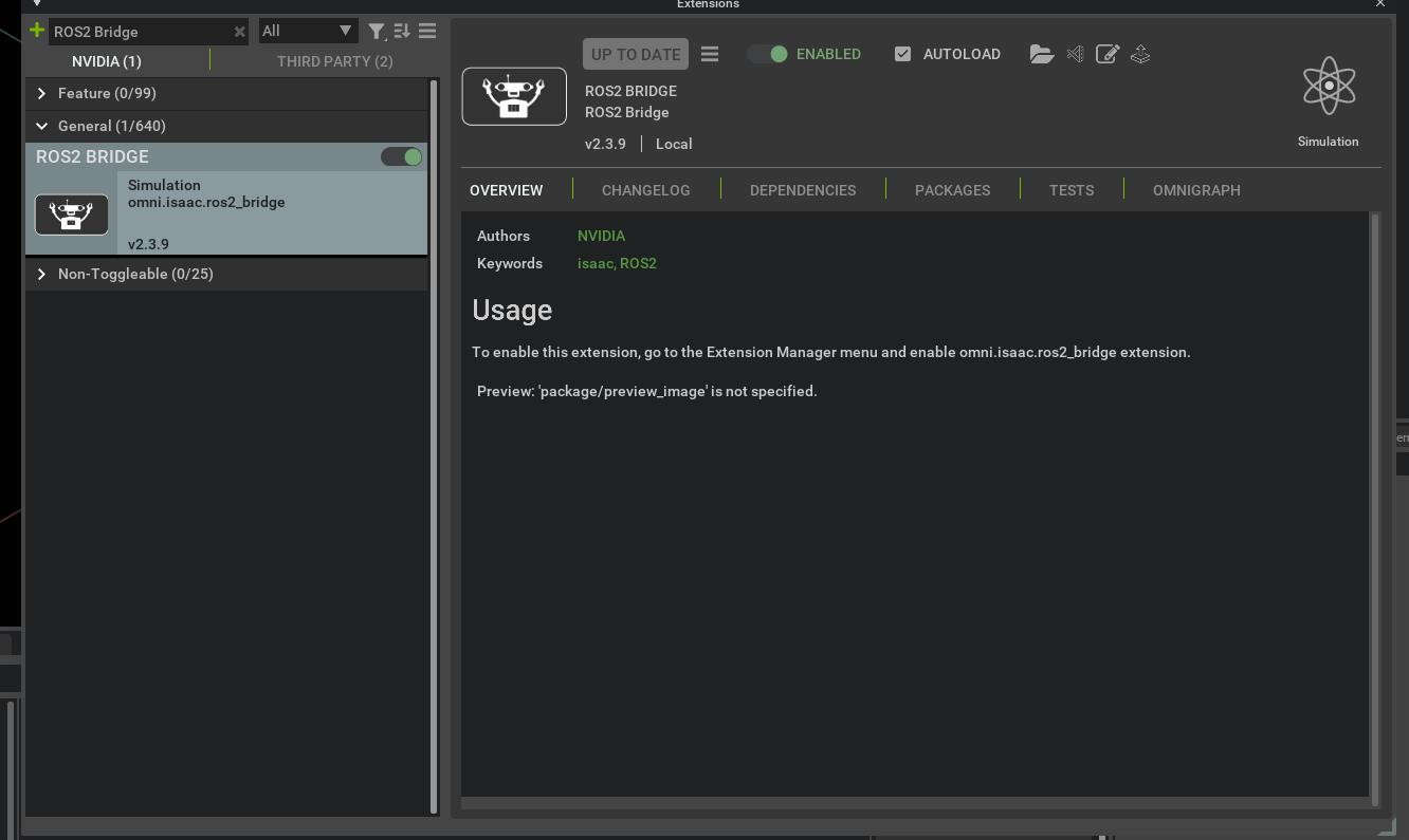

When Isaac Sim is ready you must enable the ROS2 Bridge extension.
- Open the Extension view from the menu, Window -> Extensions.
- Search for ROS2 Bridgeby using the search form in the top left.
- Click the DISABLEDswitch to set it toENABLED.
- [Optional] Flag the AUTOLOADoption to avoid performing these initialization steps each time you start Isaac Sim.

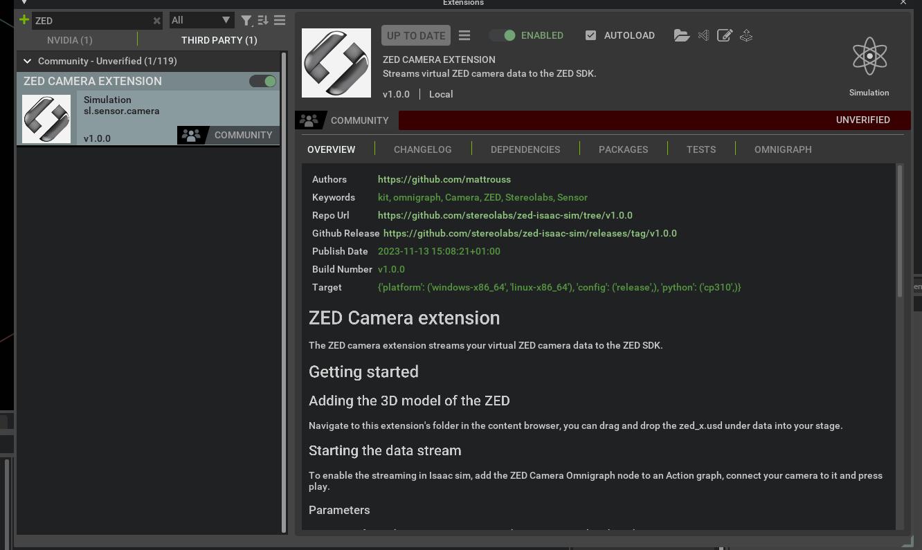

The ZED Camera Extension is required to send the simulated ZED images to the ZED ROS 2 Wrapper.
- Search for “ZED” by using the search form in the top left.- Select THIRD PARTYif you have installed the extension from the GitHub repository (see here for adding the extension if it’s not available).
- Select

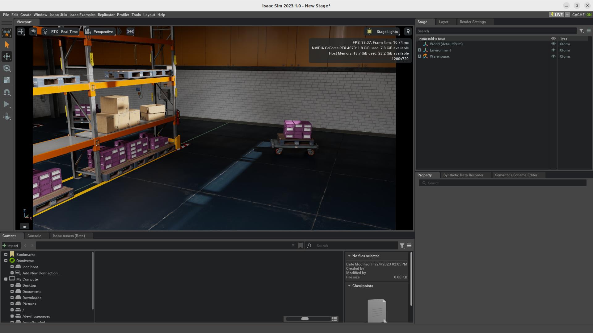

The ZED camera is a visual sensor, so it’s important to add an environment that is rich in visual features for a good simulation experience.
Isaac Sim provides ready environments to be used, from Create -> Isaac -> Environments you can select for example the environment named Small Warehouse with Multiple Shelves.
If you are using Nucleus and you created a local server, a web page will open with a form to insert some user credentials. If it’s the first that you use it, you must create a new user, and then use the new credentials to login to the server.
Wait for the simulator to load the environment. This task can take a while, according to the dimension of the environment that you selected.
When all the object of the scene are finally loaded, the simulator will display the selected environment from the default point of view of the viewport camera.

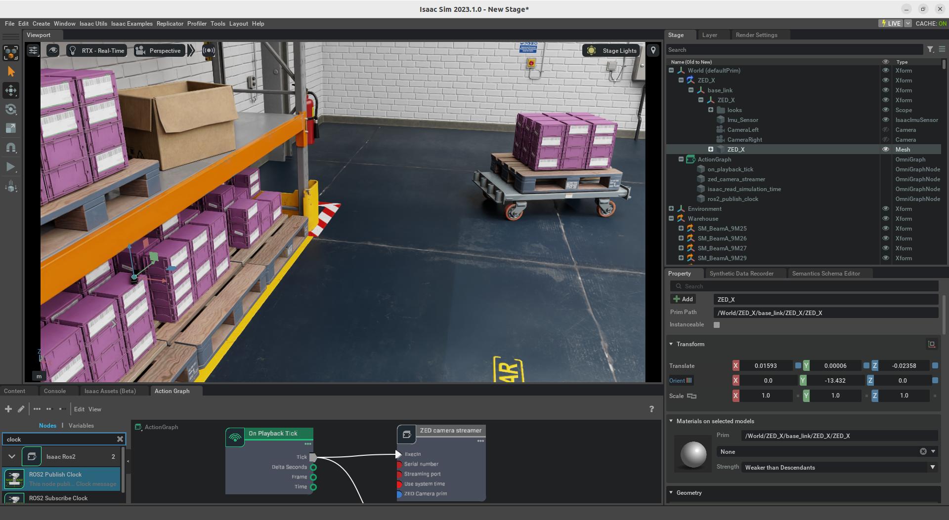

Add a ZED camera to the scene #
The ZED X model will be available in the Isaac Assets tab on the bottom panel, with the latest versions of the Isaac Sim app.
If you cannot find the ZED X Model, then you can manually add it by cloning the GitHub repository:
cd <your_workspace>
git clone git@github.com:stereolabs/zed-isaac-sim.git

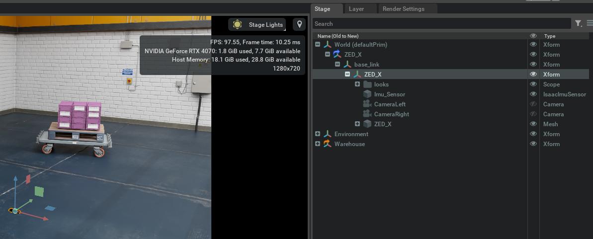

Select the model ZED_X.usd and drag it in the Viewport to place it in the position that you prefer.
A new prim named ZED_X will appear in the Stage view as a child of World.
The ZED_X prim has an important XForm named base_link, this is the reference frame of the mounting point on the bottom of the camera.
Enable the ZED camera #

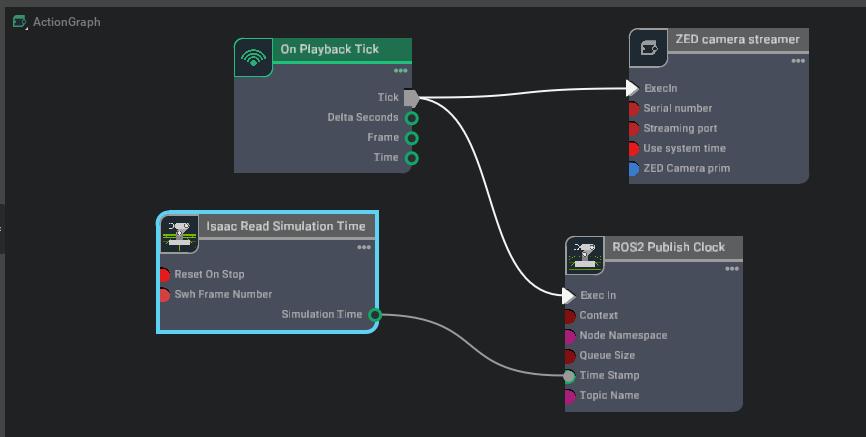

The data streaming is activated by using the Omnigraph node ZED Camera streamer.
- Create a new Action Graph, Create -> Visual Scripting -> Action Graph.
- Add a new node of type On Playback Tickto the graph. You can easily search for it by writingTickin the search form.
- Type ZEDin the search form and drag theZED Camera Streamernode into the graph.
- Connect the ExecIninput ofZED Camera Streamerto theTickoutput of theOn Playback Ticknode.
- Click on the ZED Camera Streamerin the graph and select thePropertytab on the right.
- Click + Add TargetnearZED Camera prim.
- Select the root XForm named ZED_Xand hitSelect.

- Select the Action Graphtab in the bottom panel.
- Add a new node of type Isaac Read Simulation Time.- [Optional] Click on the Isaac Read Simulation Time.
- [Optional] Select the Propertiestab in the right panel.
- [Optional] Check the Reset on stopoption to reset to zero the simulation time each time the simulation is stopped and restarted.
- Add a new node of type ROS2 Publish Clock.
- Connect the Tickoutput of theOn Playback Ticknode to theExecIninput ofROS2 Publish Clock.
- Connect the Simulation Timeoutput of theIsaac Read Simulation Timenode to theTime Stampinput ofROS2 Publish Clock.

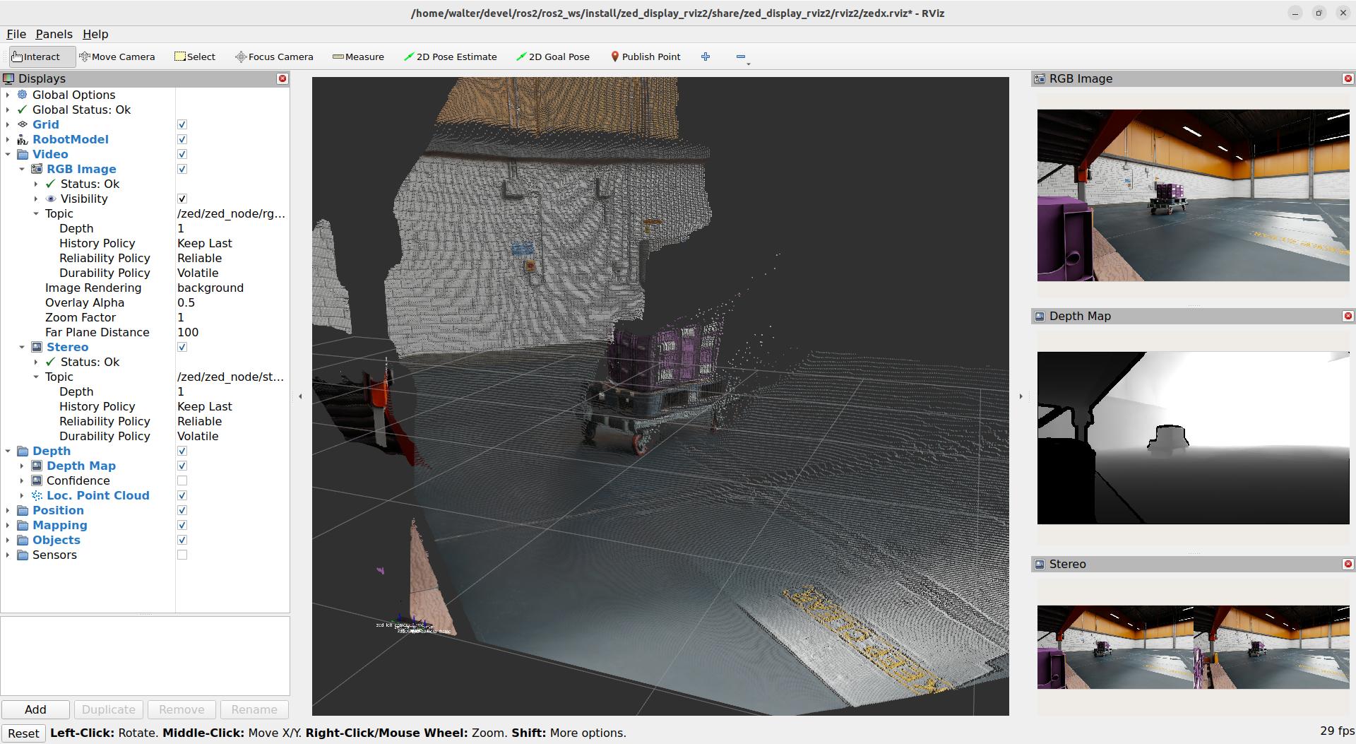

You can also start a preconfigured instance of rviz2 to visualize all the information available in simulation by using the command:
ros2 launch zed_display_rviz2 display_zed_cam.launch.py camera_model:=zedx sim_mode:=true use_sim_time:=true
the display_zed_cam.launch.py launch file includes the zed_camera.launch.py launch file, so it provides the same parameters.
You can get the list of all the available launch parameters by using the -s launch option:
ros2 launch zed_wrapper zed_camera.launch.py -s
ros2 launch zed_display_rviz2 display_zed_cam.launch.py -s
Here’s an example of rviz2 running with the simulated information obtained by placing the ZED camera on a shelf of a simulated warehouse:
