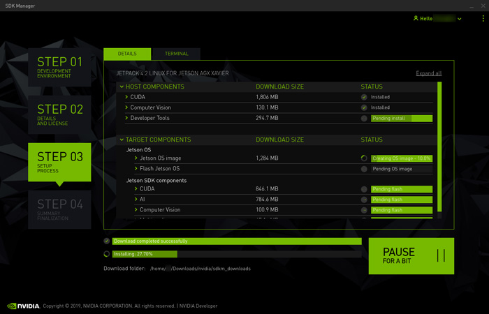

NVIDIA Jetson boards need to be flashed first with JetPack (their operating system). We recommend using the NVIDIA SDK Manager to flash your Jetson with the latest OS image and developer tools.
Go to the JetPack section of NVIDIA’s website, and click on Download SDK Manager. More installation instructions are available on Install Jetson Software with SDK Manager.
