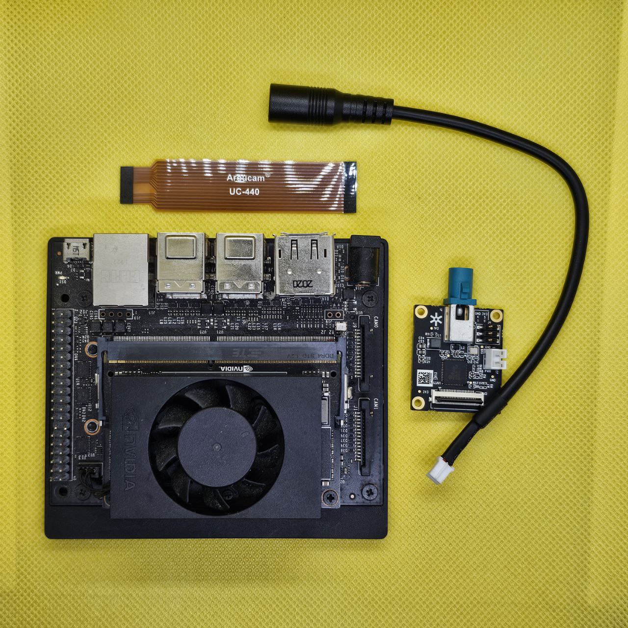

- 1x NVIDIA® Jetson™ Xavier NX Developer Kit.
- 1x ZED Link Mono GMSL2 capture card
- 1x NVIDIA® Power supplier to power the Development Kit (included with the devkit)
- 1x FPC Camera Cable 22-pin 0.5mm Pitch to 15-pin 1.0mm Pitch (not included)*

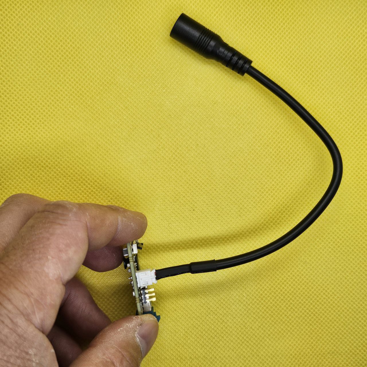

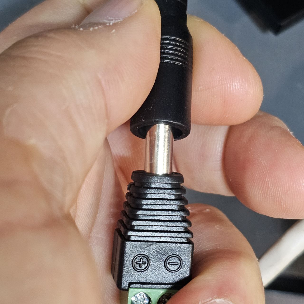

- 9V-19V (min 2W) power input (Barrel Jack 5.5 mm outer diameter, 2.5 mm inner diameter) to power the GMSL2 capture card (not included)
* You can find the FPC Camera Cable 22 pin 0.5 pitch to 15-pin 1mm pitch at UCTRONICS.

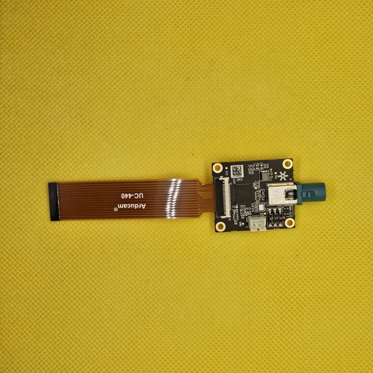

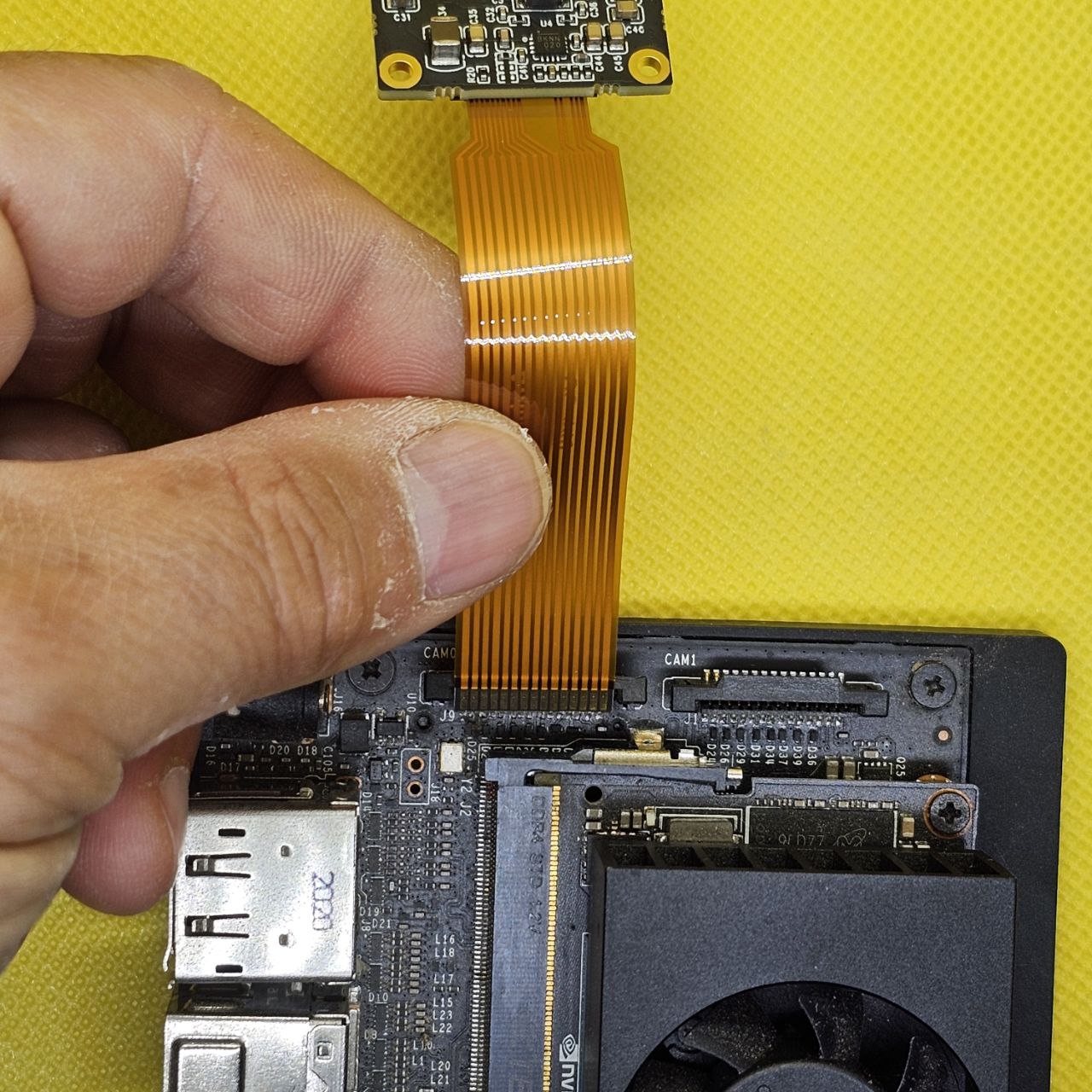

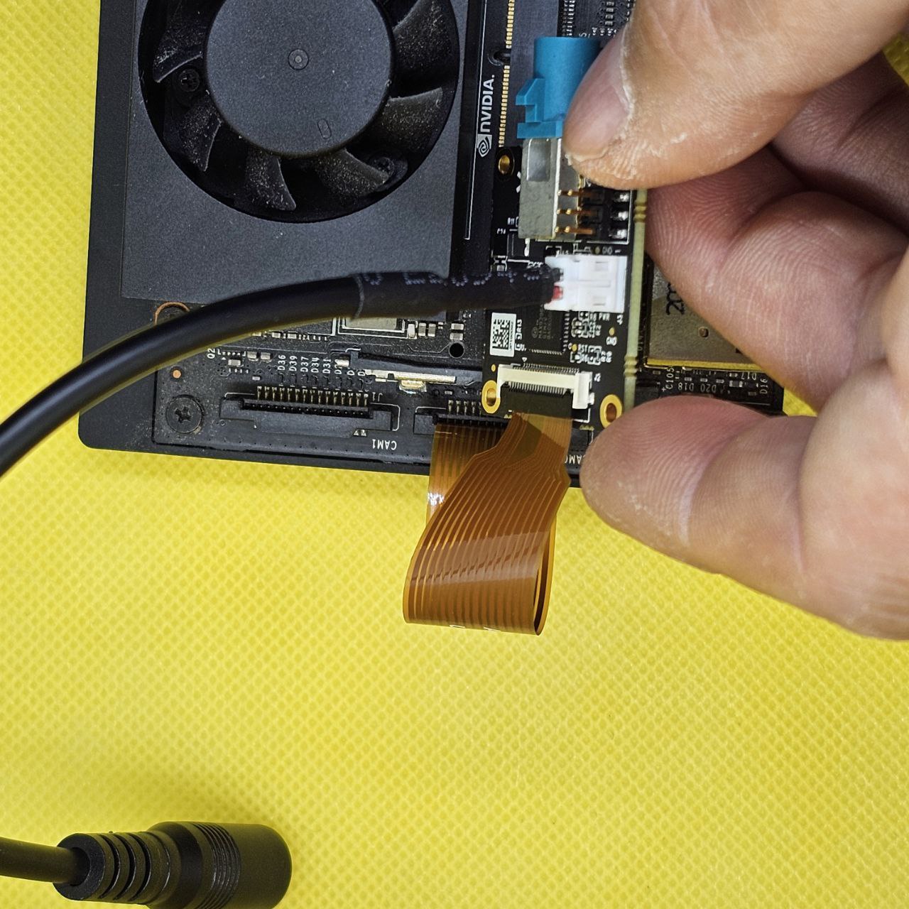

Connect the CSI cables at the MIPI 22-pin port of the capture card. Make sure the correct side is plugged in.
Warning: Inverting the side might damage the carrier board or the capture card.
Cabling the Carrier Board #

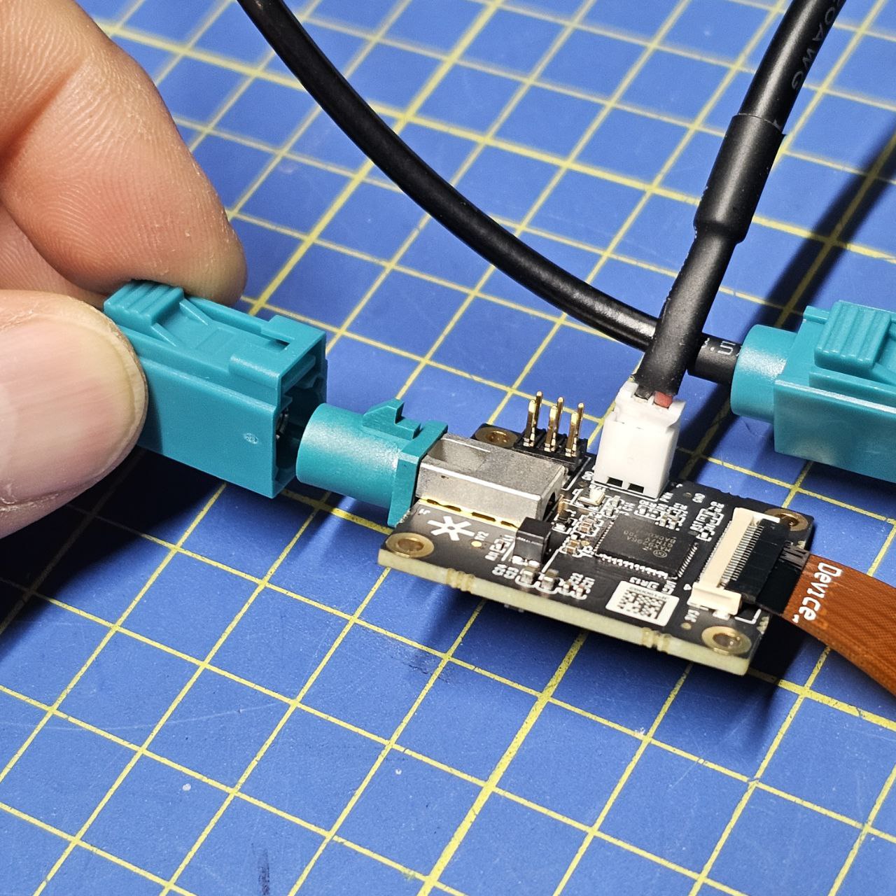

Connect the camera #
With the capture card still powered off, connect the female end of the cable to the capture card’s GMSL2 input. Again, a click informs you that the cable is secured.
