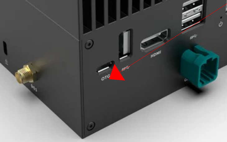

Power on the ZED Box Orin.
Connect a Micro USB cable from your host computer to the Micro USB2.0 - OTG port.
Note: Do not connect the cable before the device is powered on, otherwise the ZED Box Orin will boot in Recovery Mode.

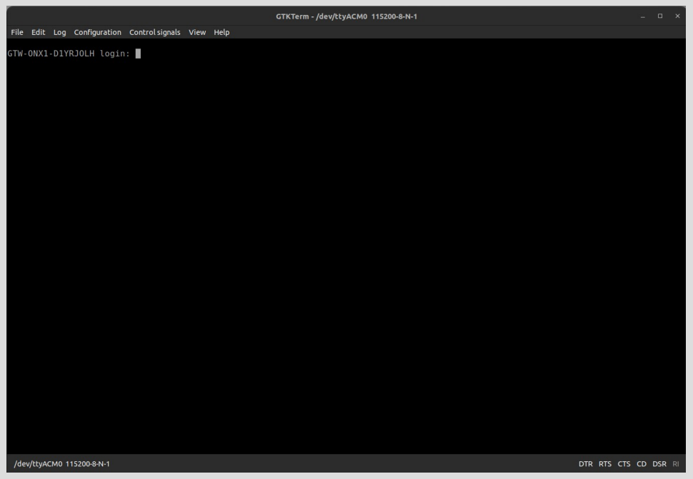

Launch
gtkterm
from the terminal with the appropriate device path (usually/dev/ttyACM0
):sudo gtkterm -p /dev/ttyACM0
Note: you can use other terminal emulators such as
minicom
orscreen
if you prefer.If the cable is connected just after the device is powered on, the terminal will display the boot messages as the device starts up. When the boot is complete, you will see a login prompt.

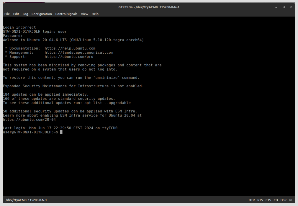

Note: If the cable is connected when the boot procedure is completed, the terminal will not display any boot messages; you may need to press
Enter
a couple of times to see the login prompt.Log in with your credentials (default credentials:
user
/admin
)You can now execute commands on the device via the Serial Console in the same way as you would via SSH.
