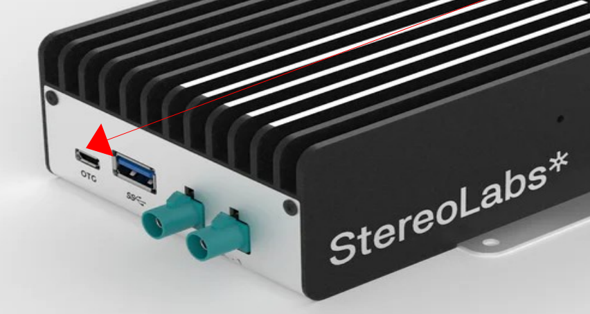

Connect a Micro USB cable from your host computer to the Micro USB2.0 - OTG port of the ZED Box Mini or Mini Carrier Board.

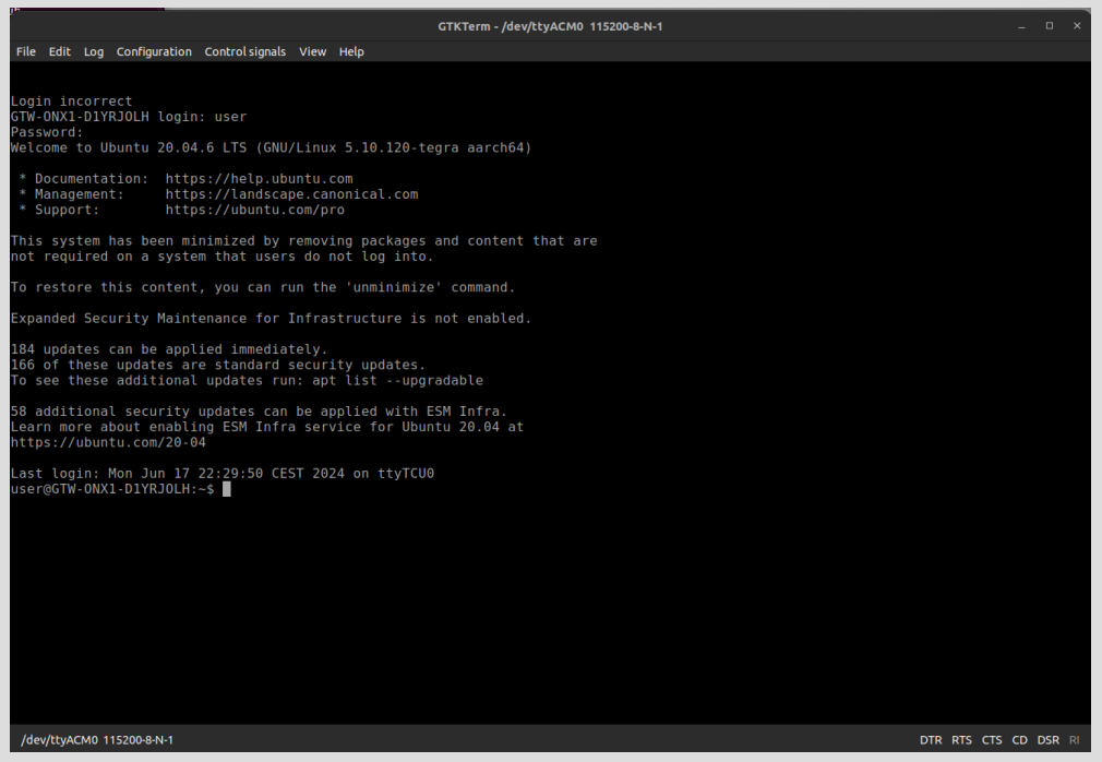

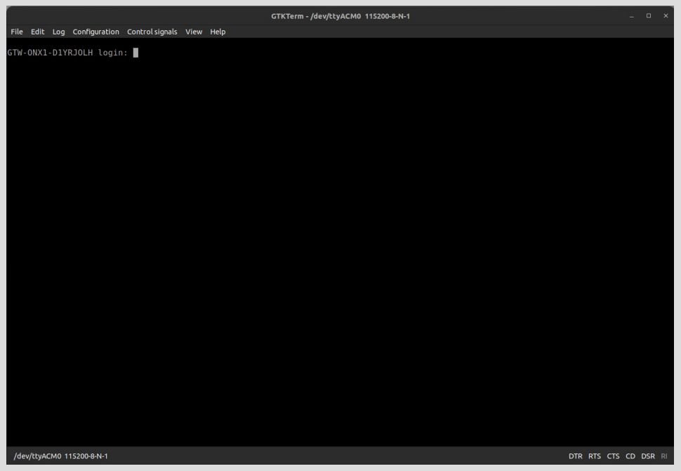

if you prefer.If the cable is connected before the device is powered on, the Serial Terminal will display all the boot messages as the device starts up. When the boot is complete, you will see a login prompt.
Note: If the cable is connected when the boot procedure is completed, the terminal will not display any boot messages; you may need to press
Enter
a couple of times to see the login prompt.Log in with your credentials (default credentials:
user
/admin
)You can now execute commands on the device via the Serial Console in the same way as you would via SSH.
