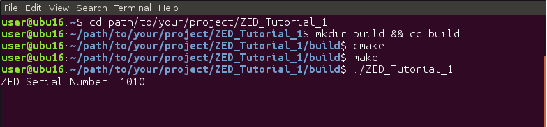

- Open your terminal and go to the tutorial folder.
cd path/to/your/project/ZED_Tutorial_1
- Create a build folder.
mkdir build && cd build
- Generate your project with CMake by pointing to the CMakeLists.txt folder (the parent folder).
cmake ..
-- Configuring done
-- Generating done
-- Build files have been written to: path/to/your/project/ZED_Tutorial_1/build
- Use the
lscommand to check the content of the build directory:
ls
CMakeCache.txt CMakeFiles cmake_install.cmake Makefile
- Compile the application using the
makecommand.
make
- The application is now compiled. To launch it, run this command:
./ZED_Tutorial_1
The application will display your camera serial number in the terminal.
