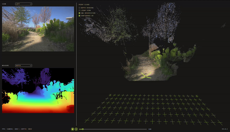

NEURAL
The NEURAL depth mode uses AI-powered disparity estimation to deliver a strong balance of depth accuracy and processing speed. It is ideal for applications that require reliable depth perception without sacrificing real-time performance.

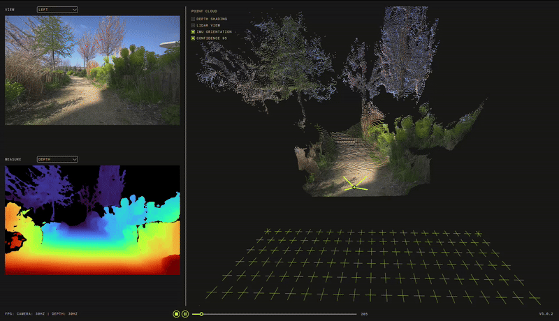

NEURAL LIGHT
The NEURAL_LIGHT depth mode provides AI-powered disparity estimation optimized for speed and efficiency. It enables real-time depth sensing with lower computational load, making it ideal for multi-camera setups and applications where fast processing is prioritized over maximum depth accuracy.

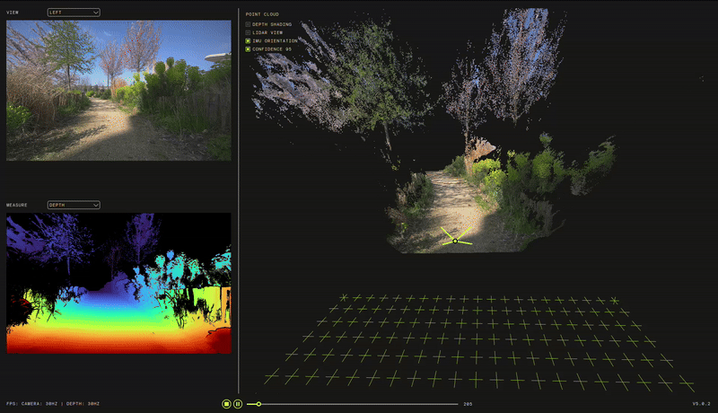

NEURAL PLUS
The NEURAL_PLUS depth mode provides the highest depth accuracy and detail among all AI-powered modes. It is designed for applications that demand maximum precision and robustness, such as advanced robotics, inspection, and 3D reconstruction. While it requires more computational resources and delivers lower frame rates compared to other modes, NEURAL_PLUS excels in challenging environments and when capturing fine object details is critical.

Depth Modes Comparison
| Depth Mode | Ideal Range | Benefits | Limitations |
| NEURAL_LIGHT | [0.3-5] | Fastest depth mode availableBest for multi camera setupSuited for mid-range obstacle avoidance | Smallest ideal depth rangeMay miss small objects or objects detailsSlightly less robust to environmental light changes than NEURAL |
| NEURAL | [0.3-9] | Balanced depth and performanceBetter object detail than NEURAL_LIGHTSuitable for most multi-camera applicationsSame robustness to environmental changes as NEURAL_PLUS | Slower than NEURAL_LIGHTLess detail than NEURAL_PLUS |
| NEURAL_PLUS | [0.3-12] | Highest object details availableHighest ideal depth range and stabilityBest for detecting near, far, and small objectsMost robust to environmental changes (rain,sun) and light reflections | Slowest depth modeMay not be suited for multi camera setup |
