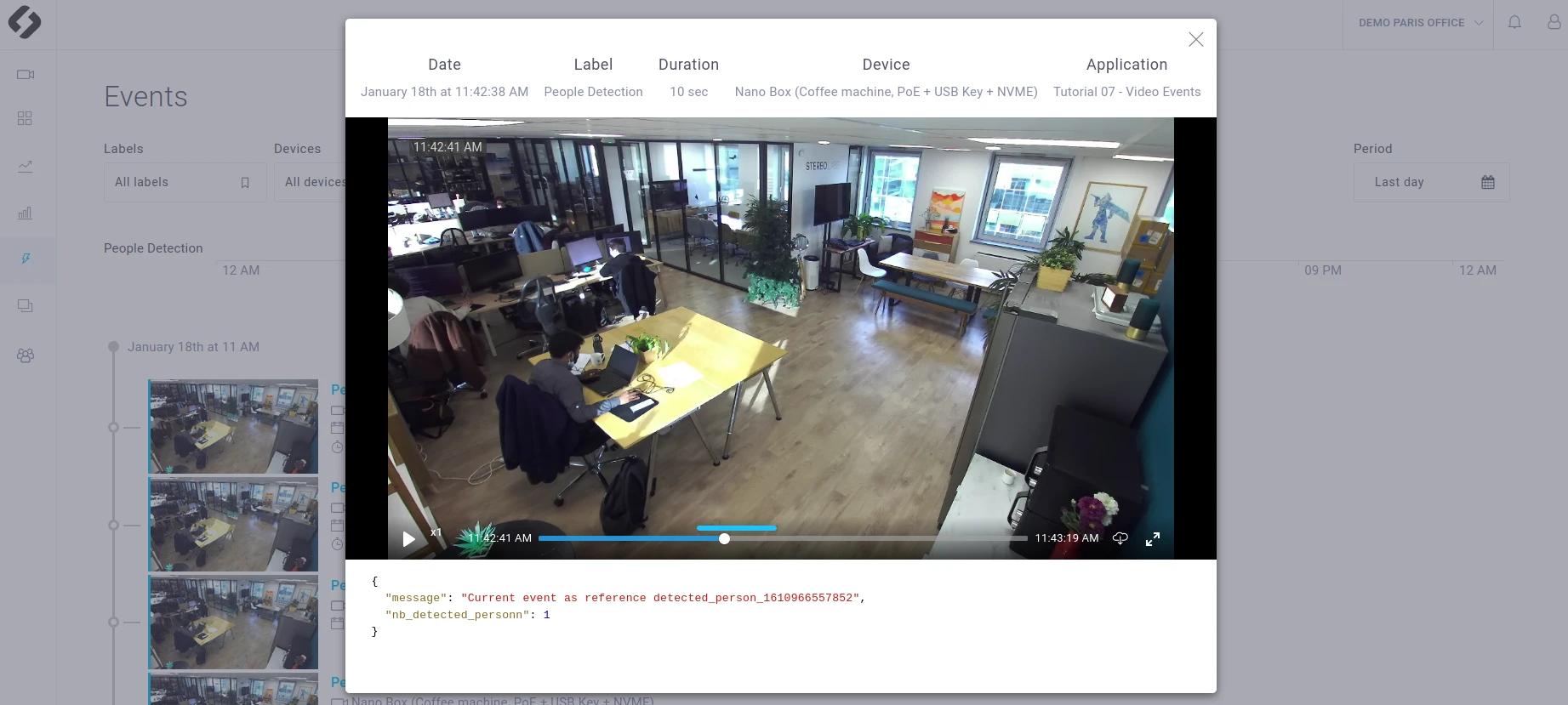

These events will be visible in the Video Event Panel :
You can click on it. You have access to the video and the stored data of the event. You have access to a longer video than the exact event duration (you can watch a few seconds before and after the event). The blue line indicates which part of the video is associated to the event.
