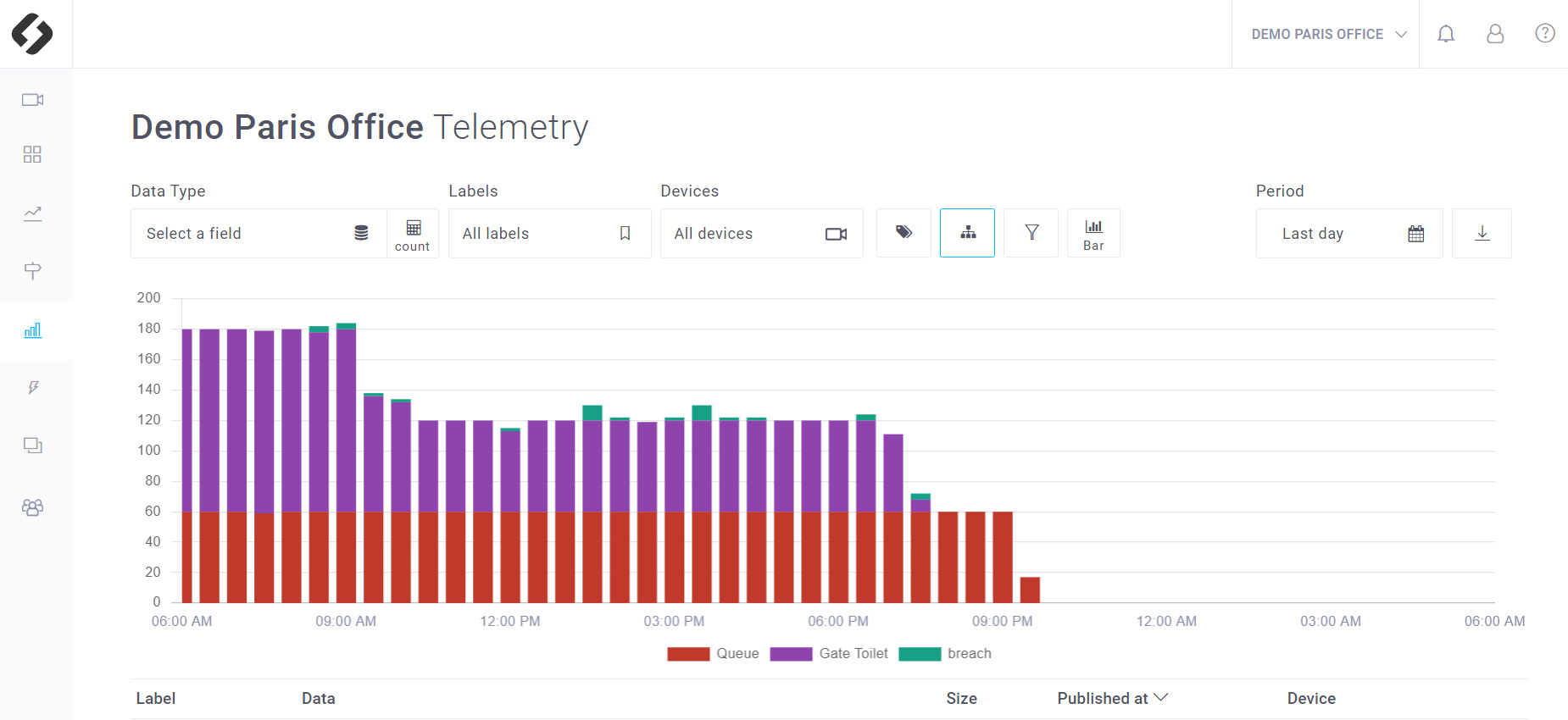

Visualize your data with ZED Hub
You can visualize your telemetry from the Telemetry panel.
From the interface, you can filter telemetry by date, labels, or devices to target some specific telemetry for analysis.
