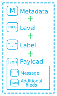

Log message
A log payload is a format-free json document. You should make sure that you’re organizing your json attributes depending on the requests you plan to do when retrieving the data.
Every log message should be sent with a label identifying the type of log sent. This will improve your query performances and ease-of-use when starting to send different logs.
    //Metadata, cloud will add time/device/application details
    //Level
    "level": "INFO",
    //Label
    "label": "robot_status",
    //Payload
    "payload": {
      //Message
      "message": "Battery is fully charged.",
      //Additional fields
      "charge_duration_ms": 3600000
