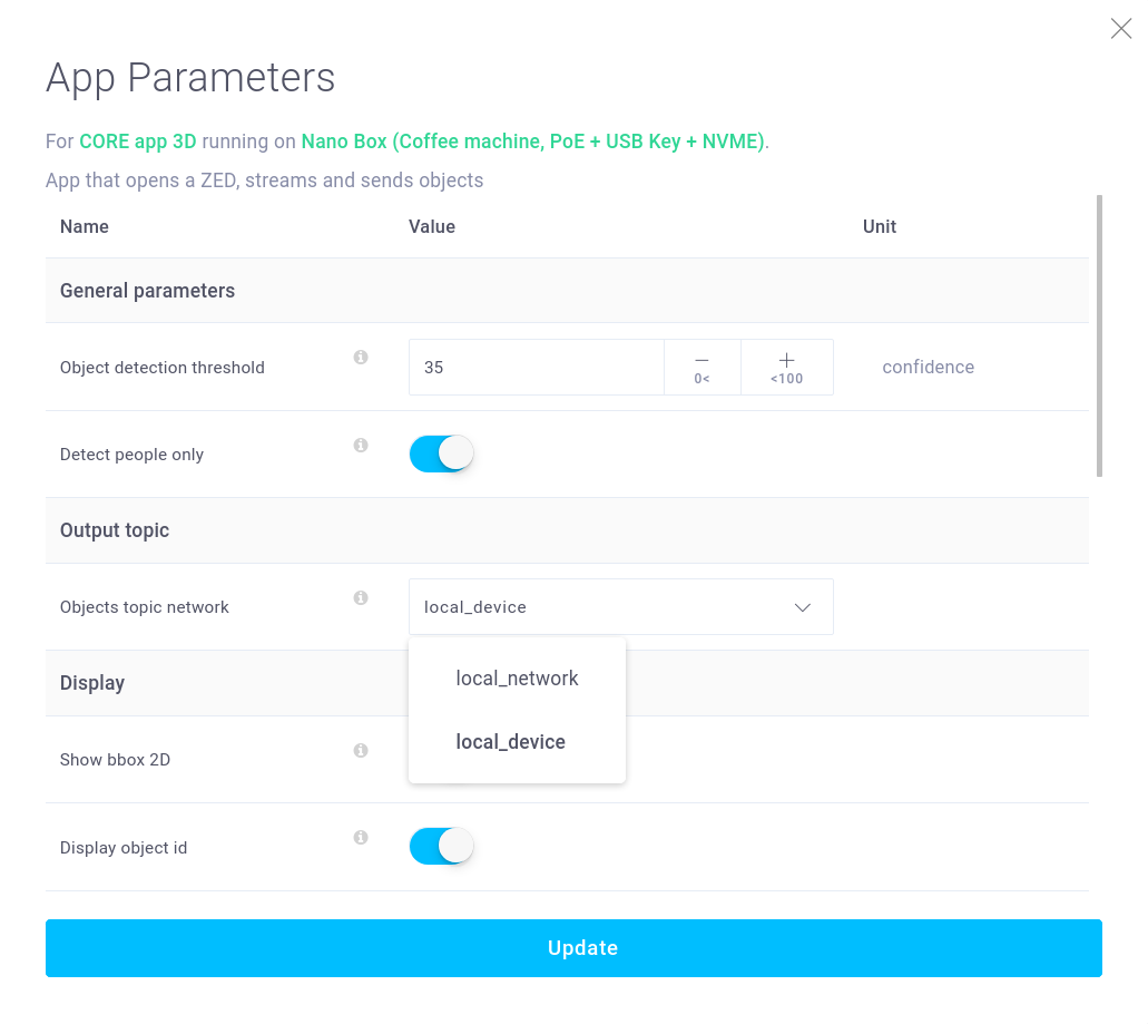

Modify the parameter’s value
In your code
In order to update and use updated values, you need to create and register callback function(s) to detect application parameter changes and retrieve the new values with HubClient::getParameter in your application.
For an example on how to use application parameters callback functions, you can refer to this tutorial.

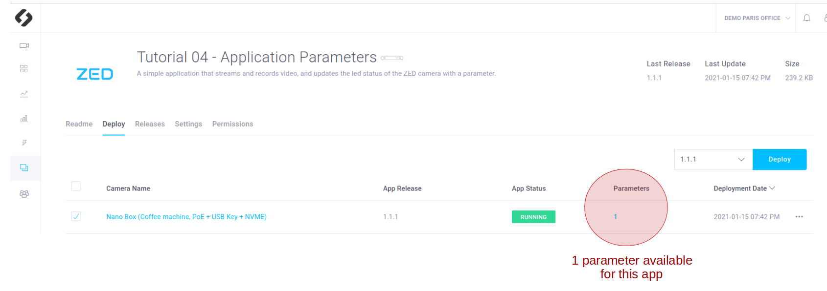

Applications
Applications that have been deployed are visible in the Applications panel of every device. The number of parameters available for each application is displayed. If you click on the number of parameters, you have access to the Parameter Panel, where you can modify the application parameters.
Do not forget to click on Update to save your modifications.
