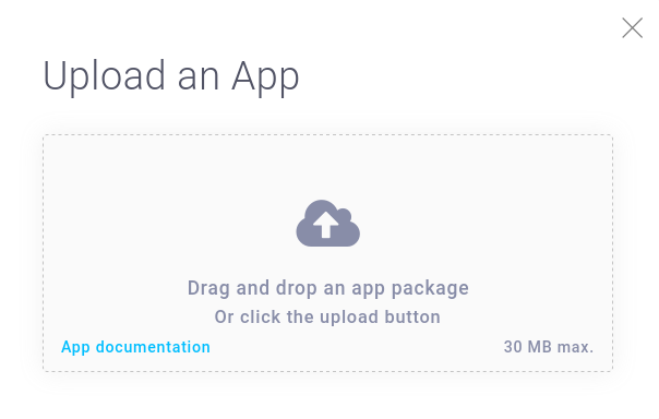

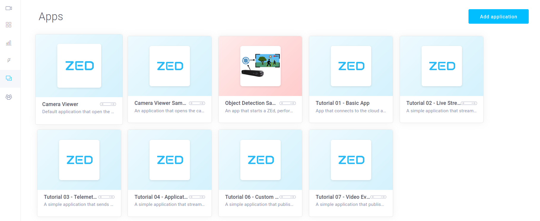

Upload to the cloud
In the Applications page, click on Add application and upload you ZIP archive. You can modify its name and icon in the settings panel if needed.

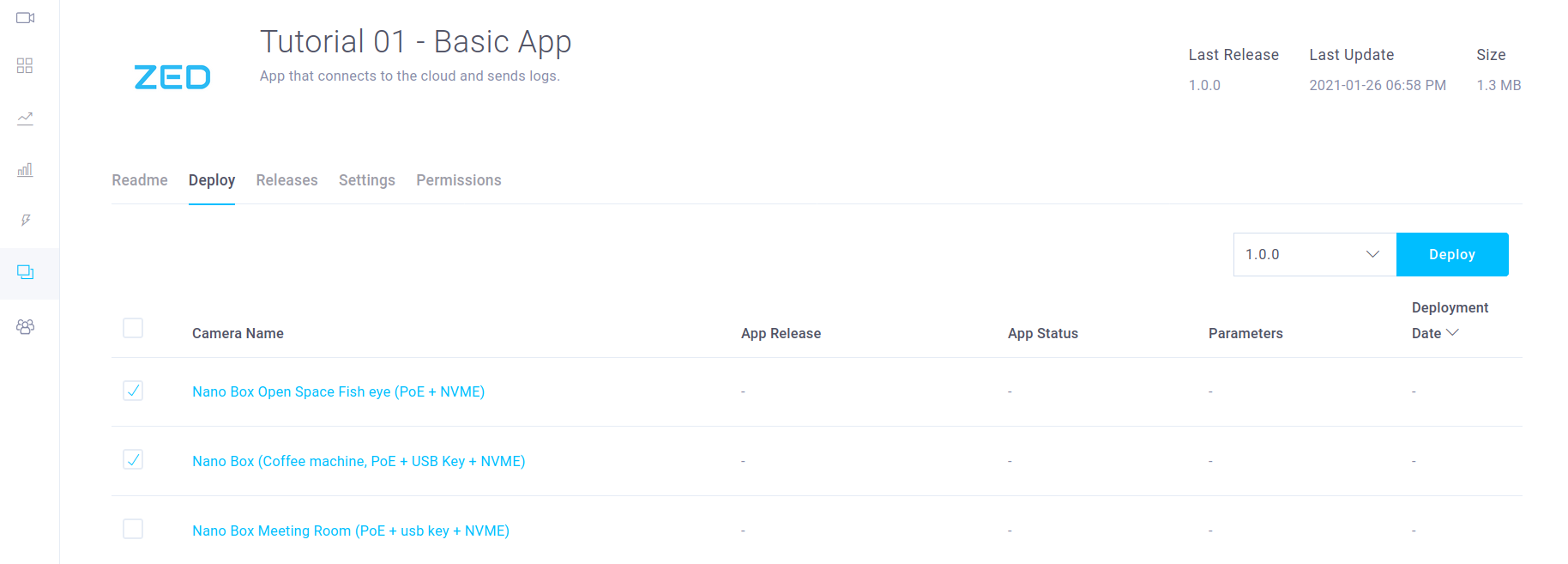

Deploy on your devices
Select an application among those you have already uploaded. In the Deploy section, select the devices where you want to deploy the application.
